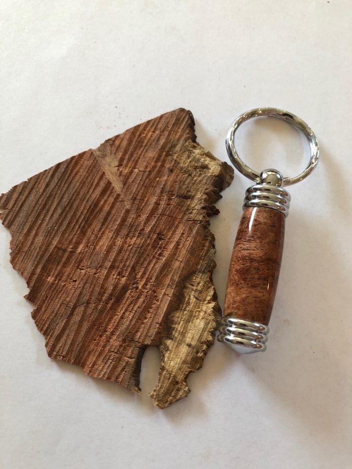

I have a customer that has requested a matching pen/pencil set made from snake wood. I ordered some snake wood blanks from peachtree, and one of them came split so badly it isn't usable. When I got the replacement it doesn't match the first blank I still had from them. Does anyone have a couple of snake wood blanks they are willing to sell to me? This customer handles rattlesnake collection from communities for the fish and game department, and I would really like to make these nice for him, as a way of saying thank you. I am willing to pay well for a matching set of blanks. I am also willing to trade honey mesquite burl if you would prefer to trade. The burl is from the same burl I made the key ring attached to this post.
