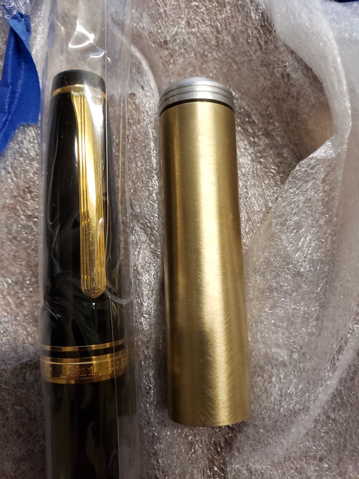

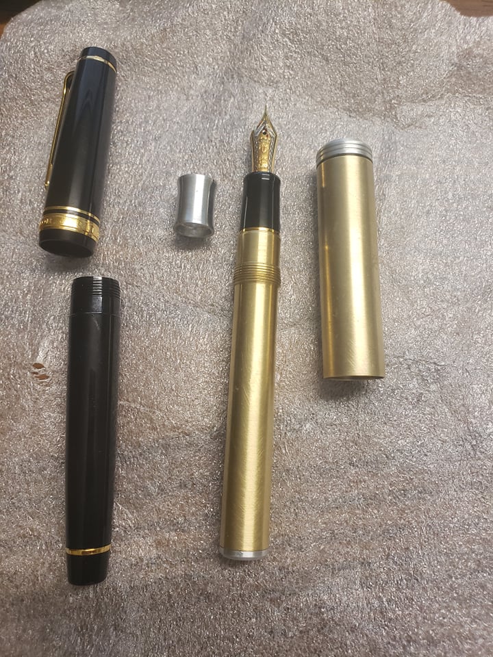

I've mostly delved into the world of pen making about a year ago when I fell in love with Sailor's nibs. However I am not a fan of their ppma resin bodies that they come with. They just feel cheap to me. I've tried their KOP line and others but the pens are too large. So I embarked on a journey to custom make a barrel/cap/grip to fit the nib/feed of the pen.
Anyways, long story short- I only have experience in machining metal. So I started off by designing and making a pen out of brass/aluminum. Countless hours later (I prototyped etc) I have a fully working version which I was going to have lacquered with urushi. However, it just is too heavy for comfort. Capless, the pen weighs around 30 grams currently which will only get heavier when finished, with the cap the weight is around 50+ grams. I am not too happy with the profile either, to be honest.
Originally, I was going to learn how to turn ebonite to finish making a new pen, but time is my enemy currently since I am bogged down with stuff to do - I want to learn just right now it seems impossible.
The finish is not necessary since I've reserved some slots for Ernest Shin to do his urushi work on them :). This does provide a complication with threads however since you need to have a little bit of play in them for the lacquer: the threads for cap/barrel need a 75-80% tolerance.
There is no need for a clip, since I seem to not be able to source them anywhere.
I am wondering if there is someone who would be willing to manufacture the barrel/cap for me out of ebonite if I provide the material/costs? The grip is already finished and I am happy with it.
Anyways thanks for the consideration, I've attached a picture of the brass pen that was made in custom for the feed system, just as food for thought

Worst comes to worst, I will put the project off for a couple of months till things die down and I have time to learn. The profile I want is not what is shown here - I am thinking of a more Nakaya shape which complicates things as well.
Another problem is that people with their own business generally refuse this type of commission, since it's working with sailor's proprietary parts - which I totally understand. I'll try the FPN network too, thanks for the reminder!
I am not sure what Ernest will do with the threads but I guess a tap and die set is a choice I could make.
