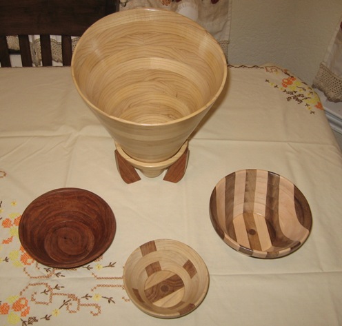

These are a few I recently completed. More in the works.
The biggest and the smallest are poplar and mesquite. The striped one is maple and walnut and the solid dark one is mesquite. From 5" to 9 1/4" diameter.
Comments and critiques welcomed as always.

Nice bowls, I like how the angles can be varied to change the shape.
Thanks for showing.

The large funnel looking 'bowl' started as part of a 1x6 from Lowes. It measures 10 1/2" at the rim. The smaller mesquite bowl is two pieces about 3" wide glued up.
I have a rather large pile of small scrap pieces in my shop and whenever I get some time, I glue up whatever looks good together. I would venture to say that cutoffs from pen blanks would make an interesting bowl. May take a while to assemble, but could look really nice. Think GIANT segmented piece.:eek:
