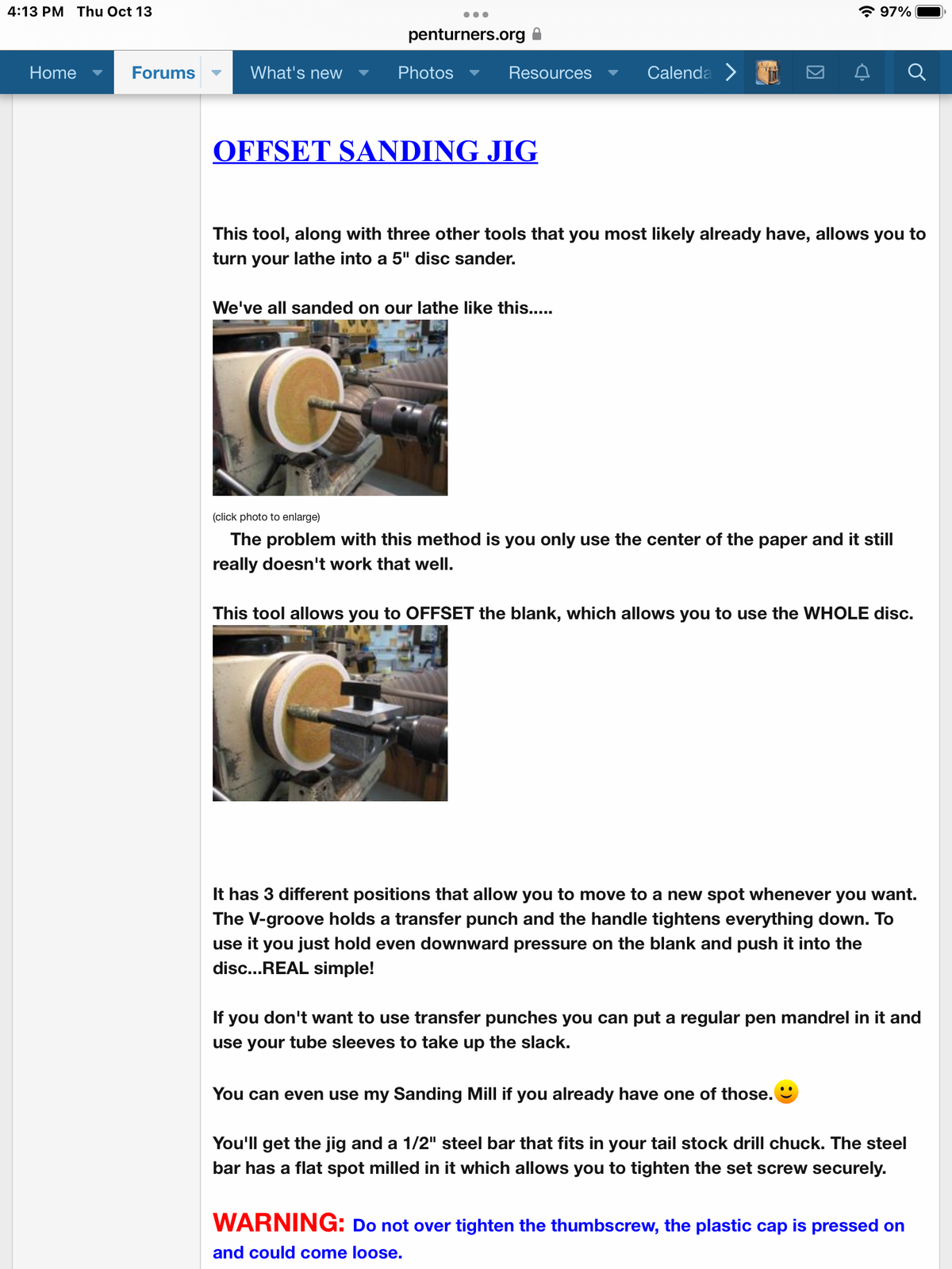

I realize you are newbies, but I wish I never tried a barrel trimmer. There are numerous reasons for this but know mine has been gone for a decade! Rick makes a jig that holds your blank in the tail stock (you need a drill chuck there too). It is used for every pen, razor, seam rippe, keychain I make. If it was stolen I would buy a new BEFORE turning anything again.
To use it you need a faceplate on your headstock with sandpaper. Mine is Velcro attached for easy changing. I use 150 and 220 grit. I flush up my newly glued up pen tubes as soon as the glue cures. I also use it again with CA finished objects to flush up the ends.
Save money, buy the items needed and give your barrel trimmer to another newbie.
Be careful once you get this as the spinning sanding disc can bite and bite hard. It is far safer than a barrel trimmer.

I love mine. I can "sneak up" on the tube with slight touches to the sanding disk and lots of checking. Since I have been using Rick's device I have never cut a blank/barrel too short. I still have my barrel trimmer and considered giving it away but I don't want anyone to experience the issues that it can cause. Most likely will end up in the recycle bin.

Snapshot doesn't show price, or who sells it. Can you please post where you got it ? Thanks
Please also note the following barrel trimming sleeves work great, with a spare mandrel mounted into Rick's jig.
Using Rick's sanding jig, a mandrel loaded into the jig and this set, you can easily square up everything.
This set was not available when Rick started making the jig, but it came out last year or so. There is a 9 piece and a 5 piece.
9 Piece Barrel Trimming Sleeve Set
5 Piece

I use my lathe for drilling, to flush up the tubes blank, turning, CA application, sanding, buffing. Why try other items when we all have a lathe or more than one.
I use Rick's sanding jig almost exclusively. Only closed end pens get a pen mill trimmer.
PS. If you are doing LOTS of tubes, the sanding disk is a good way to scuff up brass tubes.
Harry, I used to use the "sneak up" method as you describe to sand to the end of the tube when using my jig from Rick. Now I just listen carefully and I can detect the change when it goes from sanding the blank to touching the brass tubes. I can best describe the noise it makes when it hits the tube as a "shuuusssh" sound, like when you are asking someone to please be quiet. Technically, you are taking a tiny fraction off the brass tube, but in hundreds of pens I have never had an issue with a "short" tube...
While this tread is a few years old... Would I need SAE or MM transfer punches to work his jig and slimline pens, 7mm. I have read that the ID of a 7mm pen brass barrel is 1/4".
You are correct that a so called 7mm brass tube fits very nicely over a standard 1/4" inch transfer punch. I haven't tried any of the other common sized tubes, but I would guess that one could find a "close enough" fit for any of them from within a typical SAE set of punches. - Dave
