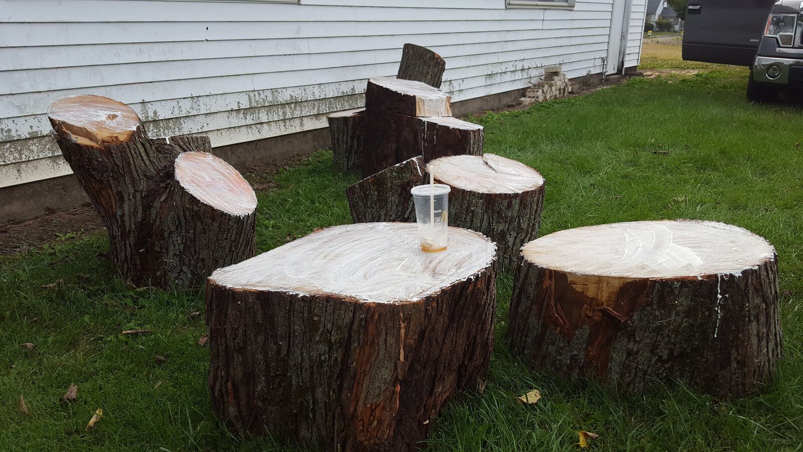

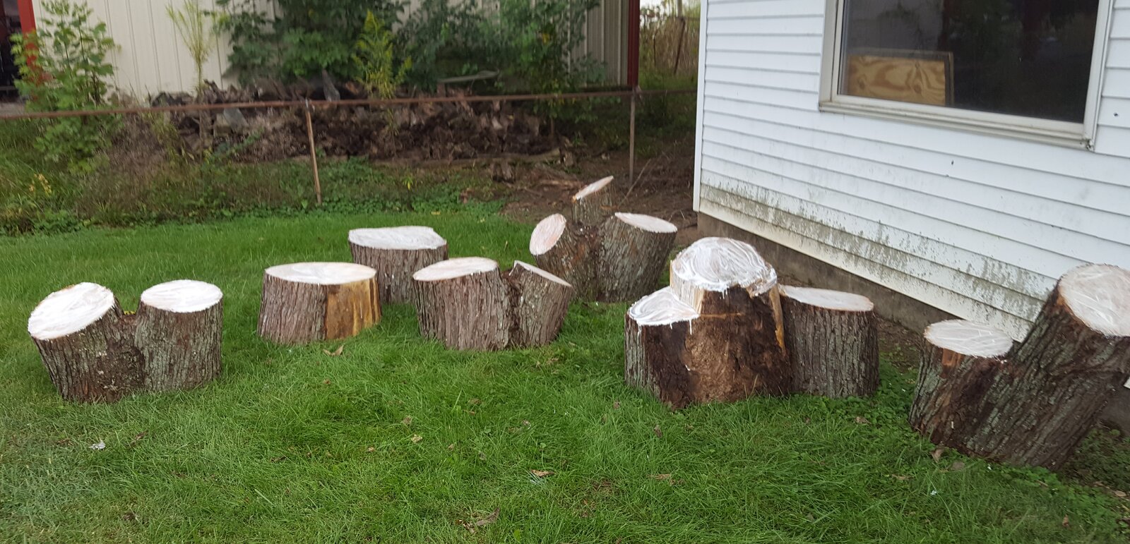

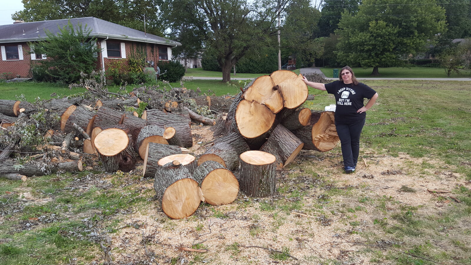

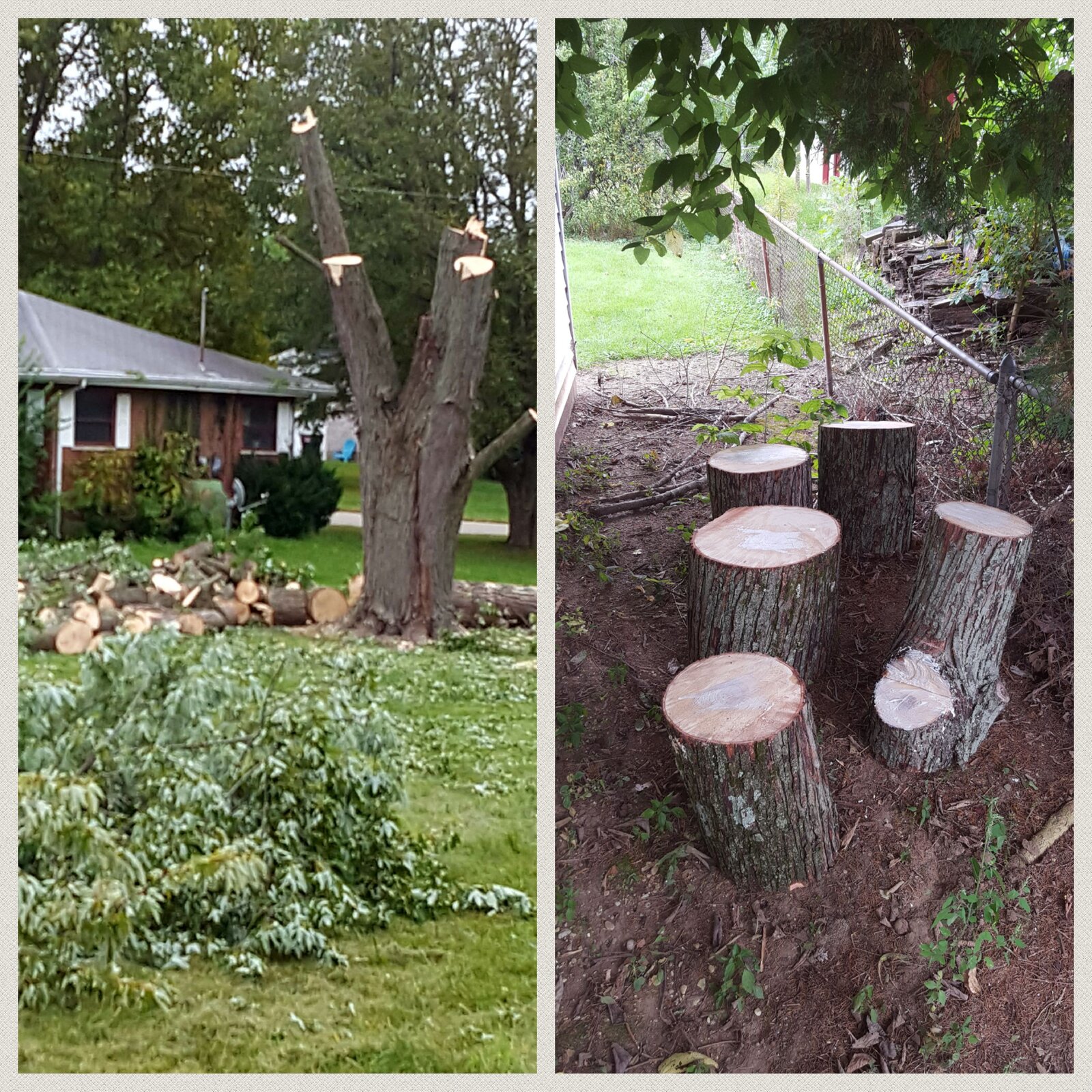

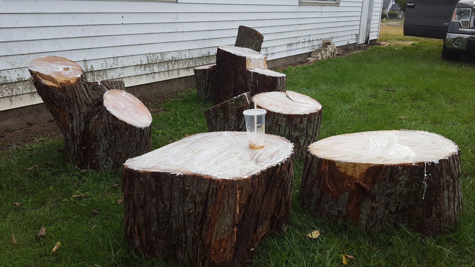

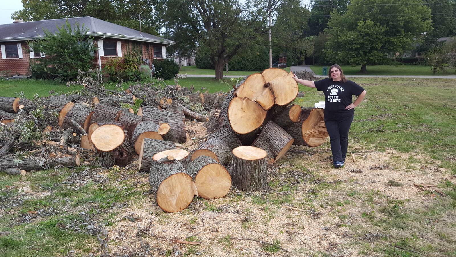

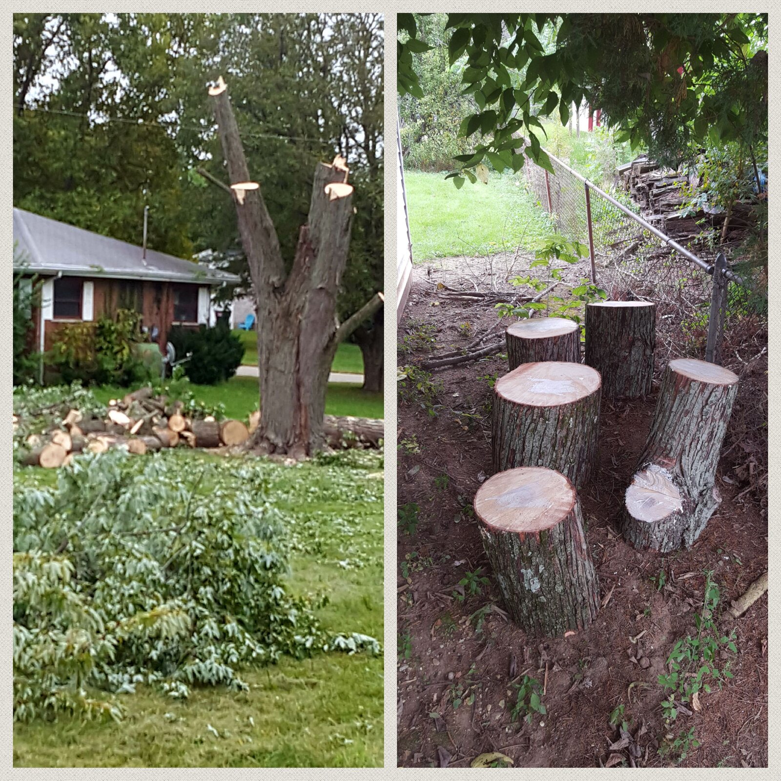

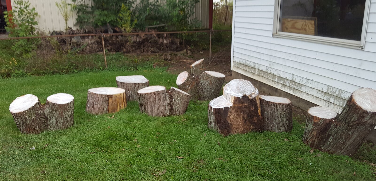

Giant Maple got cut down... and I can have at it until it gets taken away. The picture of the ones beside the fence... I'm going to try to spalt. Going to throw some horse manure, dead leaves on and under... then wrap them up in a black bag. See what comes of them next spring/summer.

Best of luck on the spalting project . I assume you have only waxed one end of those pieces . Was the tree taken down for safety reasons ?
The ones beside the Garage, I waxed on top because I can't get to all of it at once... wanted to stop the checking until I can get to them and cut out the pith. The ones next to the fence, I only dabbed some on the pith it self... did that until I could get some manure and bag them.
It was on church property but we sold the lot and the lady is going to put up a house. The tree was in the way so she had it cut down. Currently a dispute with the tree company and her on removal cost. So, I'm picking at... I just don't have a lot of time. So, I grabbed some for spalting... the others are crotch pieces or they look like they got some figure in them. If I can get more I'll do it.
I'd get a BIG truck and make sure I got all of it....
