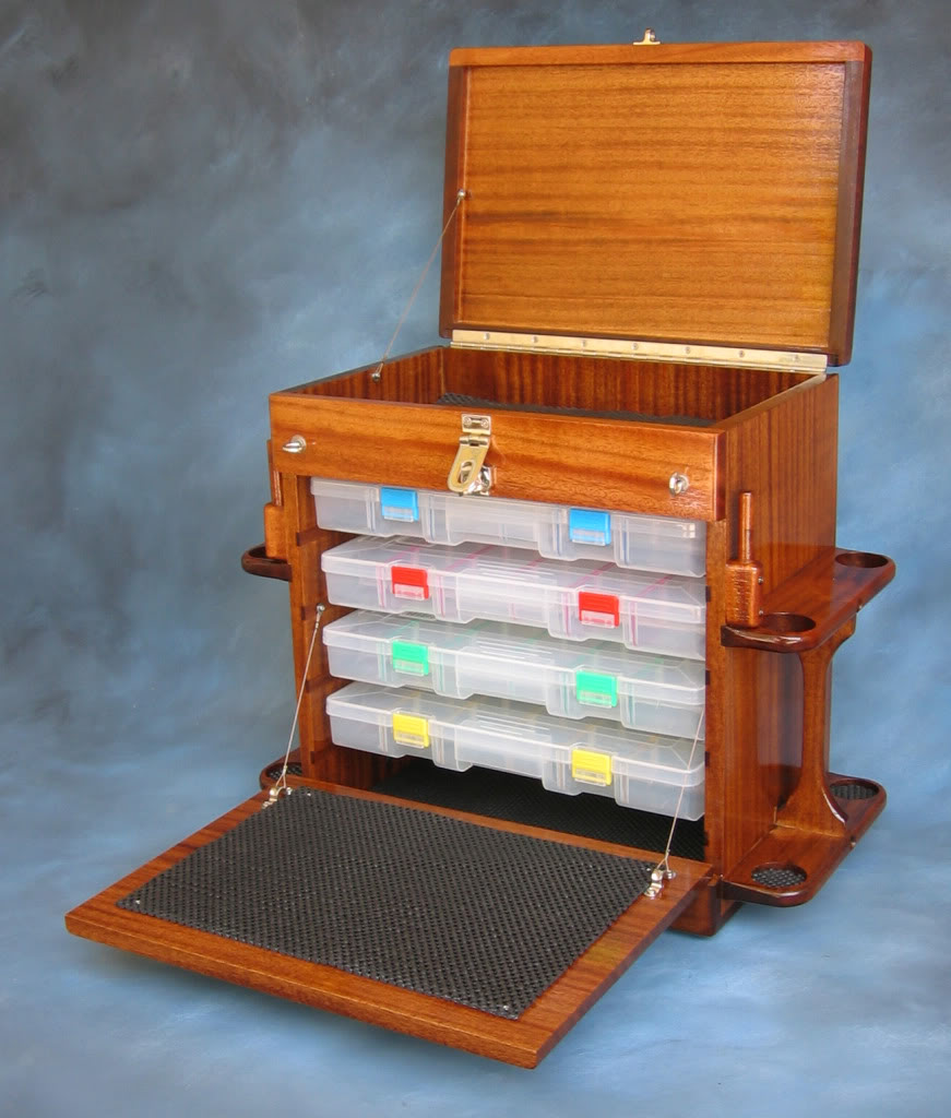

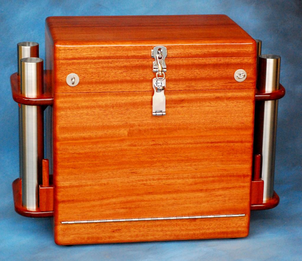

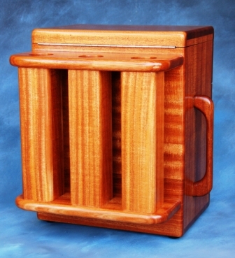

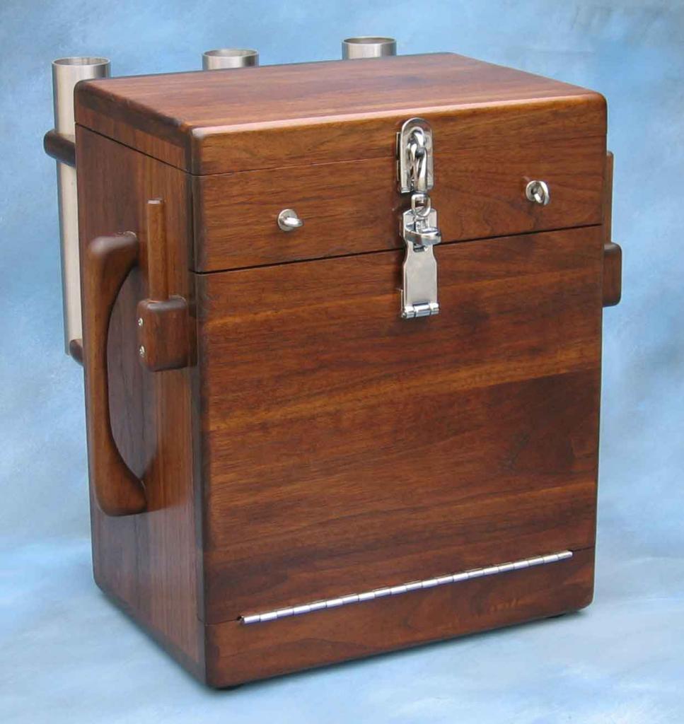

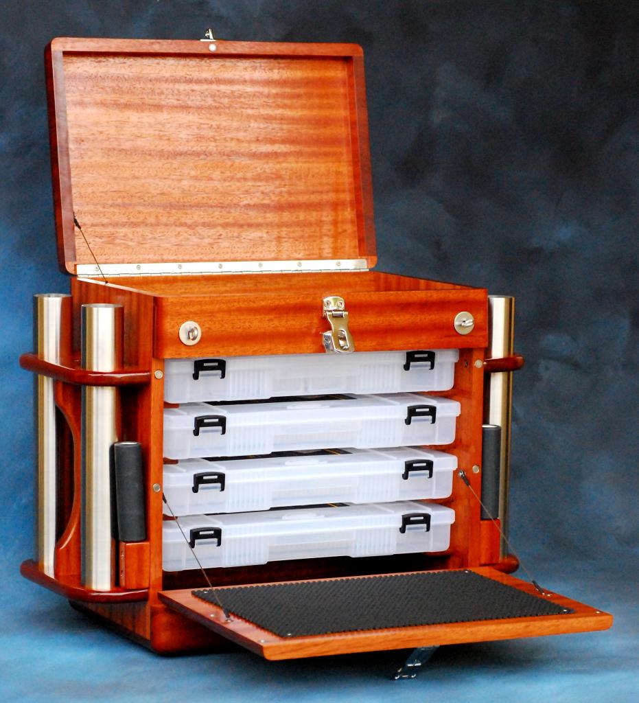

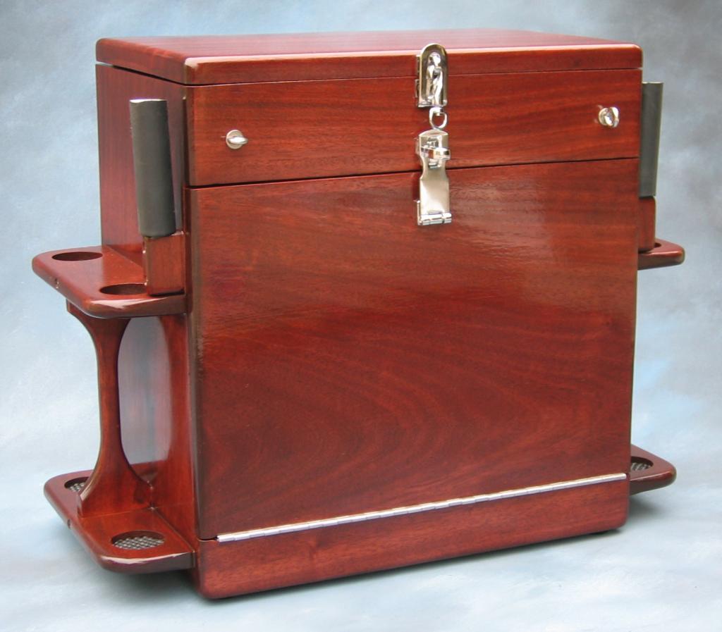

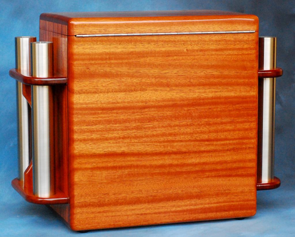

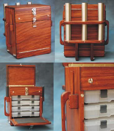

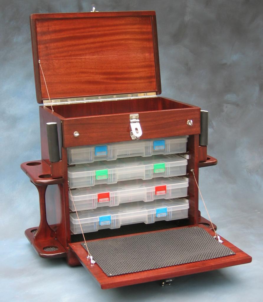

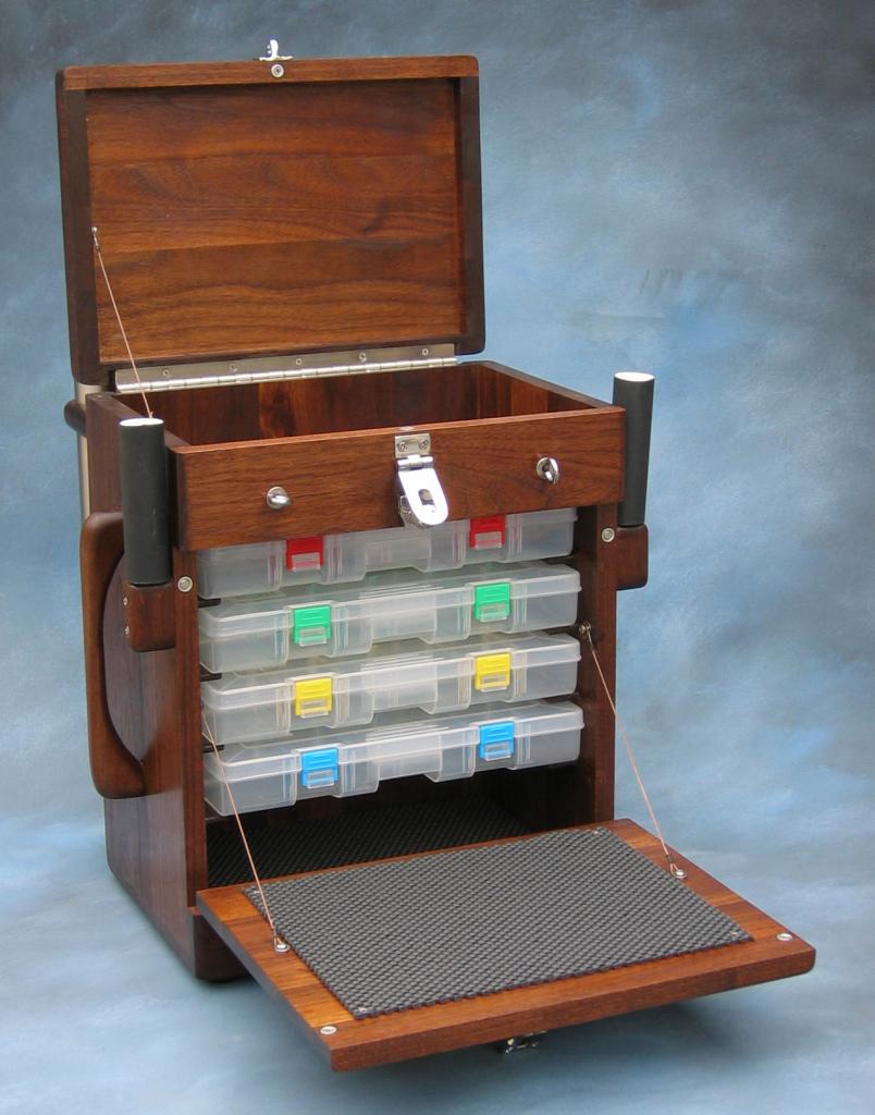

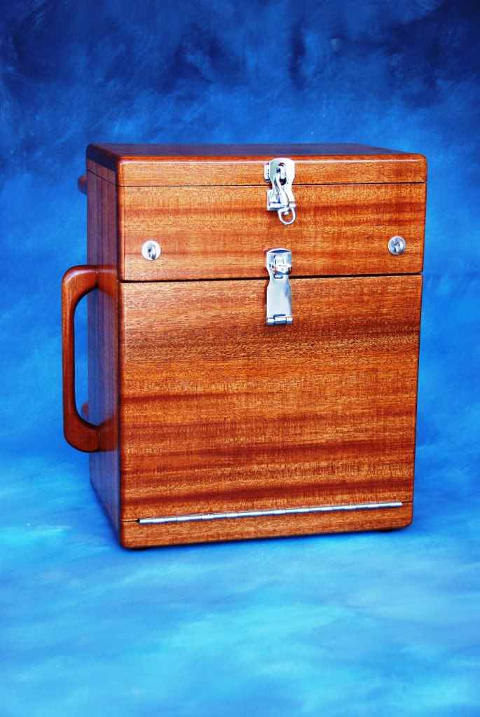

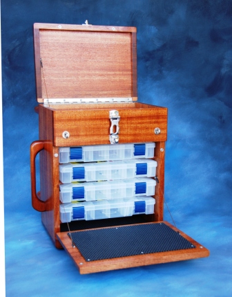

I have looked at this section of the forum for while before posting my other passion which is making tackle boxes for long range fishermen. These boxes are on the water for many days a year under tough conditions. I have made 15 so far; here are a couple:
The last walnut one was made from a reclaimed king-sized headboard made from vintage American black walnut! By the way, my friend is sorta cheap in that he complained that I asked him for $120 (my cost) for the stainless tubes and marine hardware for this box!
The rest of them were usually from a single solid piece of hardwood and machined to create the boxes. I got into pen turning after making the dowels with a hand drill and hating it. Now, I have a lathe and do this in a civilized manner.
Great looking boxes that you have there. A friend that 'steals' from you at $120 may not be a true friend at all. Lol

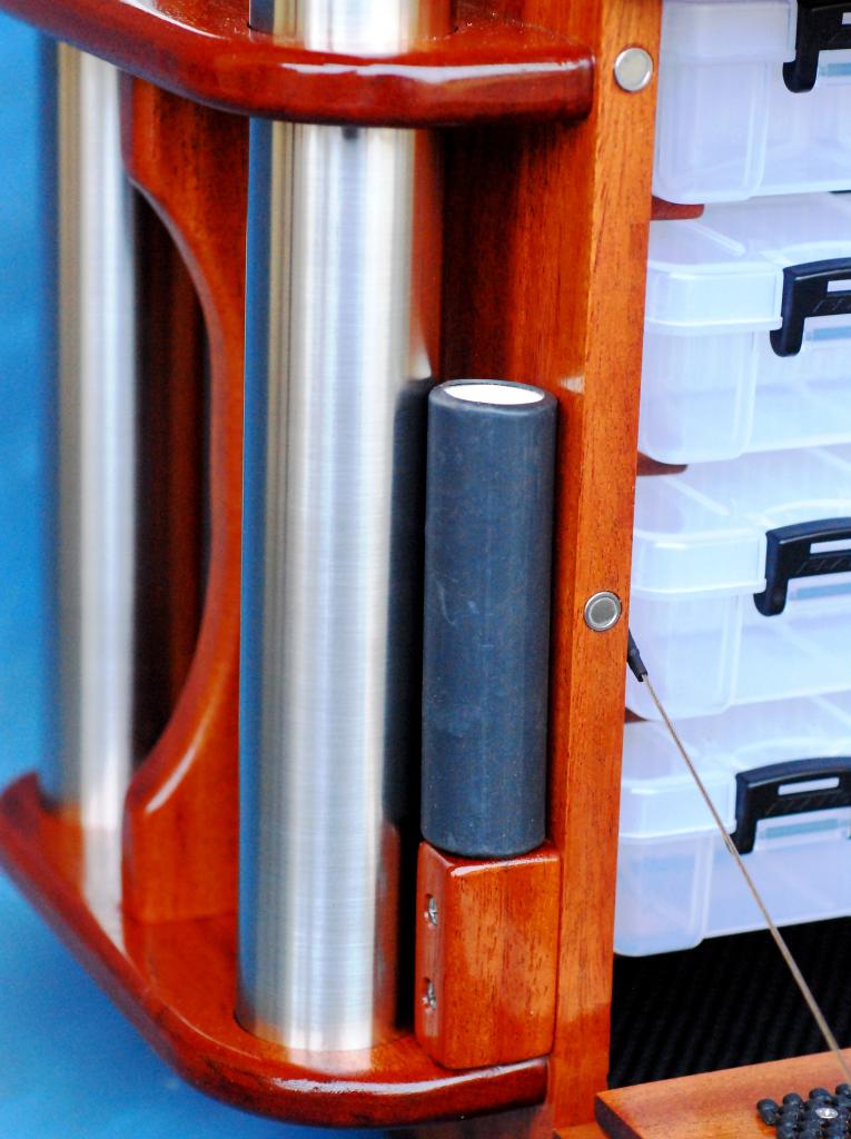

The dowel pegs hold pvc wrapped in shrink tubing called "pullers" used to tie knots and pull strongly on both mono and spectra fishing line to avoid lines cuts to fingers. Once someone who fishes uses them they are "hooked".
The stainless eyelets are used to tie hooks. They are oriented at 90 degree angles to allow for hooks with rings or plain hooks without rings. The problem on a fishing boat is to find a place to tie and hook and pull the knot tightly to seat the knot. I find lots of fishermen using my box and these eyelets to tie their hooks. Usually this is cool, but sometimes...

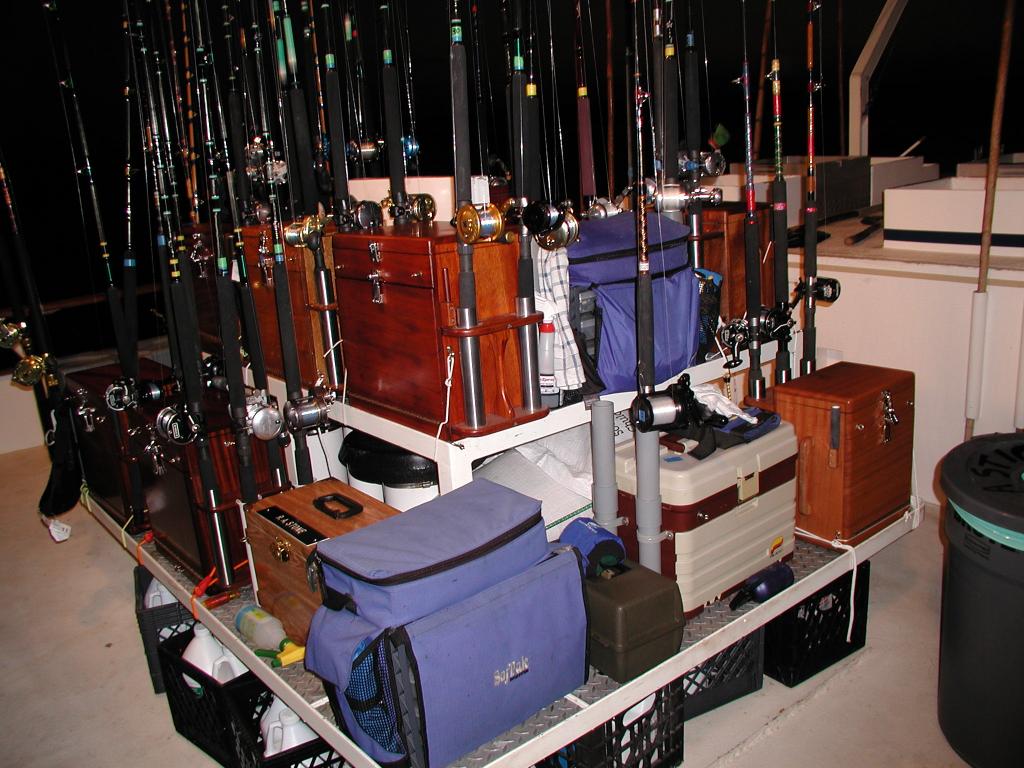

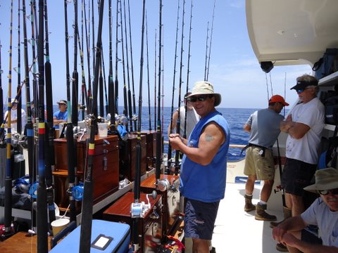

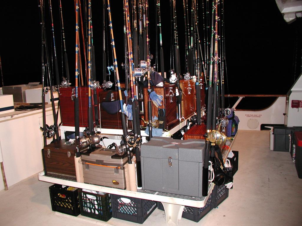

My boxes in action on The Royal Star Sportfishing boat
I'm drooling here. My first love is fishing, and those are just so purdy. Can you post a pic of o e with some use? I'd love to see one with some character. Kinda like an old fishing reel with battle scars, and stories to match.
All of these boxes are at least 4 years old some are 7 years old. They are used on several fishing trips of 3-12 days every year and still look great.
Just looking at these photos makes me really anxious to be on that boat at sea again soon! I am making the three skippers of the boat pens made from pieces of teak railing from the boat as gifts.

fantastic Tackle Boxes. Great craftsmanship. I do have one question. What are the black round cylinders for? Some pictures have them and some pictures have them removed. They look like they have some sort of rubber coating.
The black cylinders are an humble invention of mine called line pullers. When fishing you need to seat knots firmly by pulling on the line. If you do this and do not have stainless steel skin you get line cuts. This is especially true when tying monofilament to spectra line which easily cuts flesh. Below are the pullers showing some indentations that were caused by line and a closeup of on puller. Each mark would have been a cut in a finger.
If you make some use 1" PVC & heat shrink tubing and absolutely NEVER let the line go over other line when wrapping it around the pullers. I have a couple stainless steel eye bolts on the front of my tackle box to attach the hook. I can easily break 50# test mono using this technique if too much pull is applied. That said, if I pull tightly and the knot does not break or loosen it won't come free during a tough fight with a big fish.
