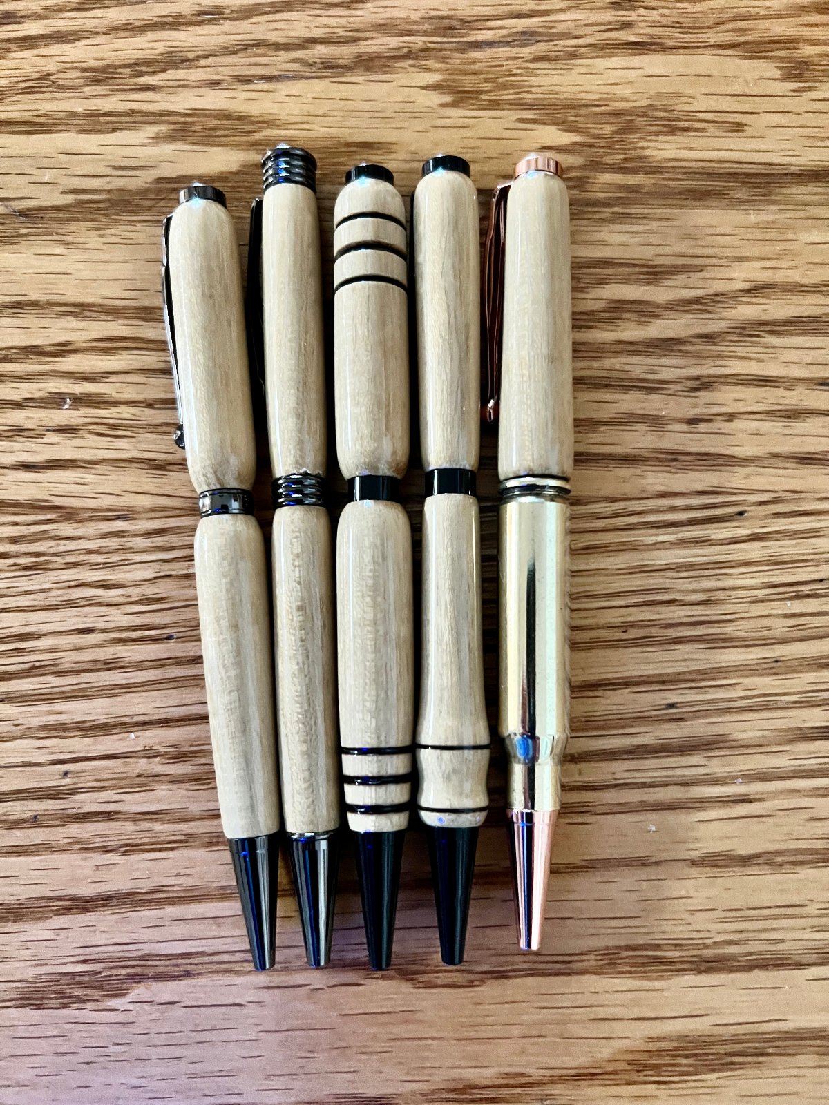

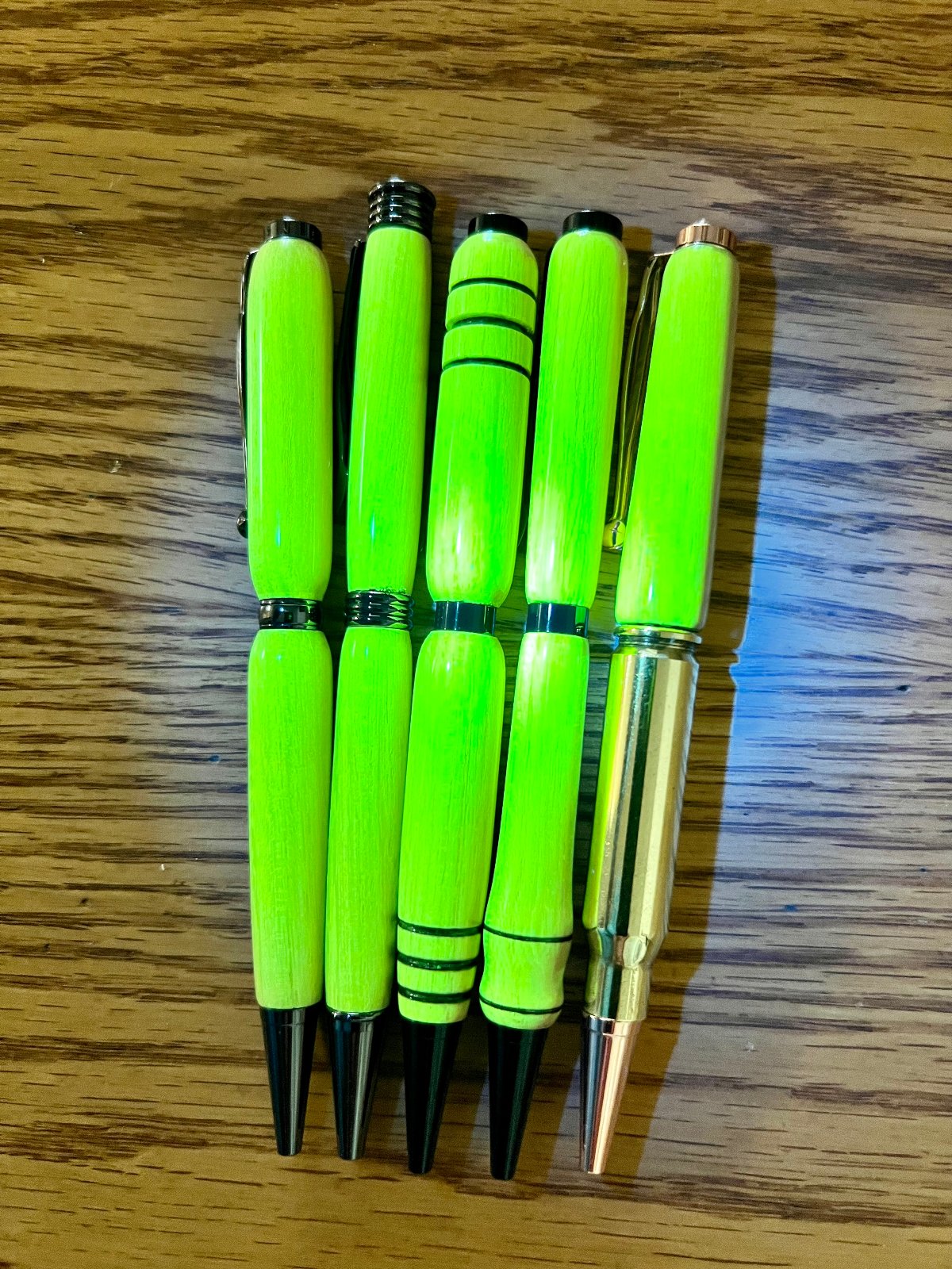

Agree with Todd - no special care is needed beyond good turning for locust. I've turned a lot. Regarding the fluorescing action - here are pics of black locust before and after using black light.
