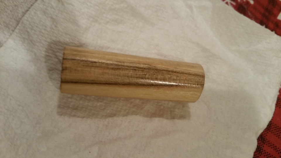

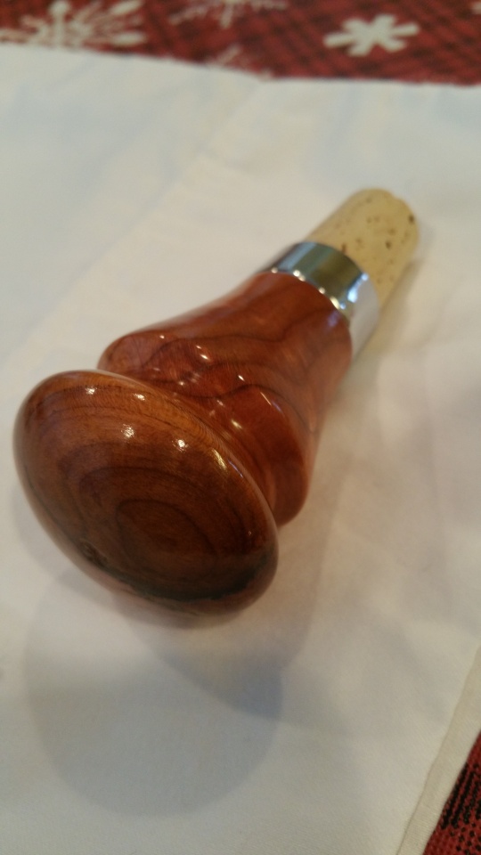

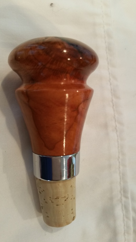

im sure there is a lot that has used this method for finishing,,this morning I was turning a bottle stopper out of cherry,,and I wanted to put a ca finish on it but never could get it right despite all the you tube videos I had watched,,lol,,plus the odor was really bad,,so I took me some Johnson paste wax and mixed a little mineral oil in ,,I begain applying it and sanding it with the paste wax and it looked good but I wanted a high gloss finish,,,i noticed that I had some Loctite 495 superglue,,,,i thought what the heck,,i put about 6 coats on it and never once sanded it,,then used the one step plastic polish and it not only produced a very high gloss,,but its as slick as if you had sanded it between coats,,plus you did not have the odor,,,lol,,it amazed me,,hope this helps someone like myself that is having a hard time with ca,,thank you

Sound like you have a different CC-Oil finish working for you.
If it is durable over time, another way to do it.
I suspect the CA is reacting with the wax/oil instead of producing fumes. One of the things I appreciate with CA and walnut oil bowl finish combination.

That is an interesting concept. I previously had used the CA/BLO approach to my wood pen finishes. I still experienced plenty of CA fumes, but there was no wax involved in the process.

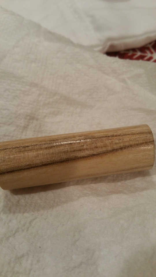

this is another picture out of a scrap piece of popular I was playing with,,it has 2 coats and buffed out with the one step polish,,,in 5 min or less
