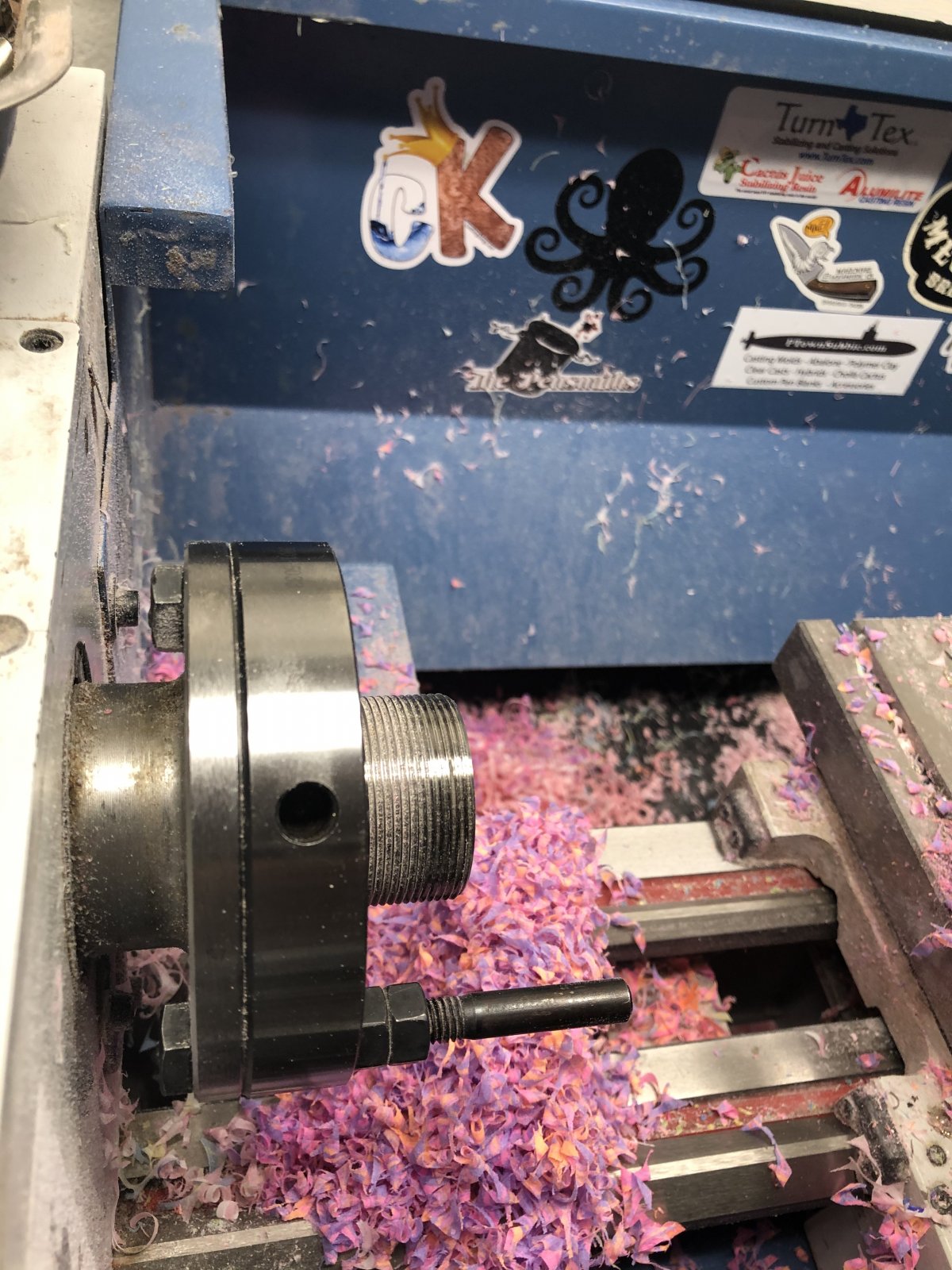

You are going to love it. I have one, love it. I also run it with the er32 adapter, that allows you to fit a dead center in the MT3 with the ER32 nut removed, so you can turn between centers using a lathe dog.

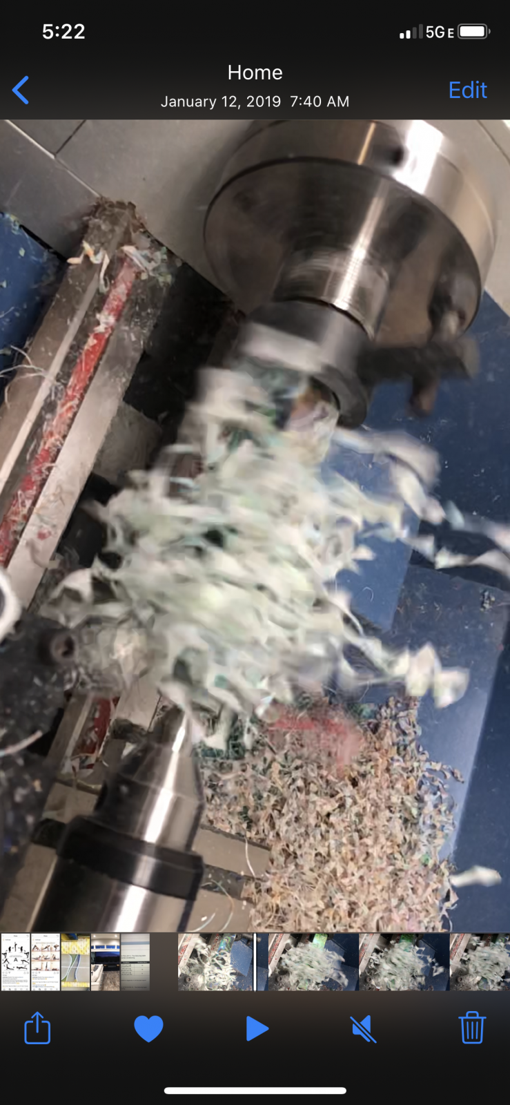

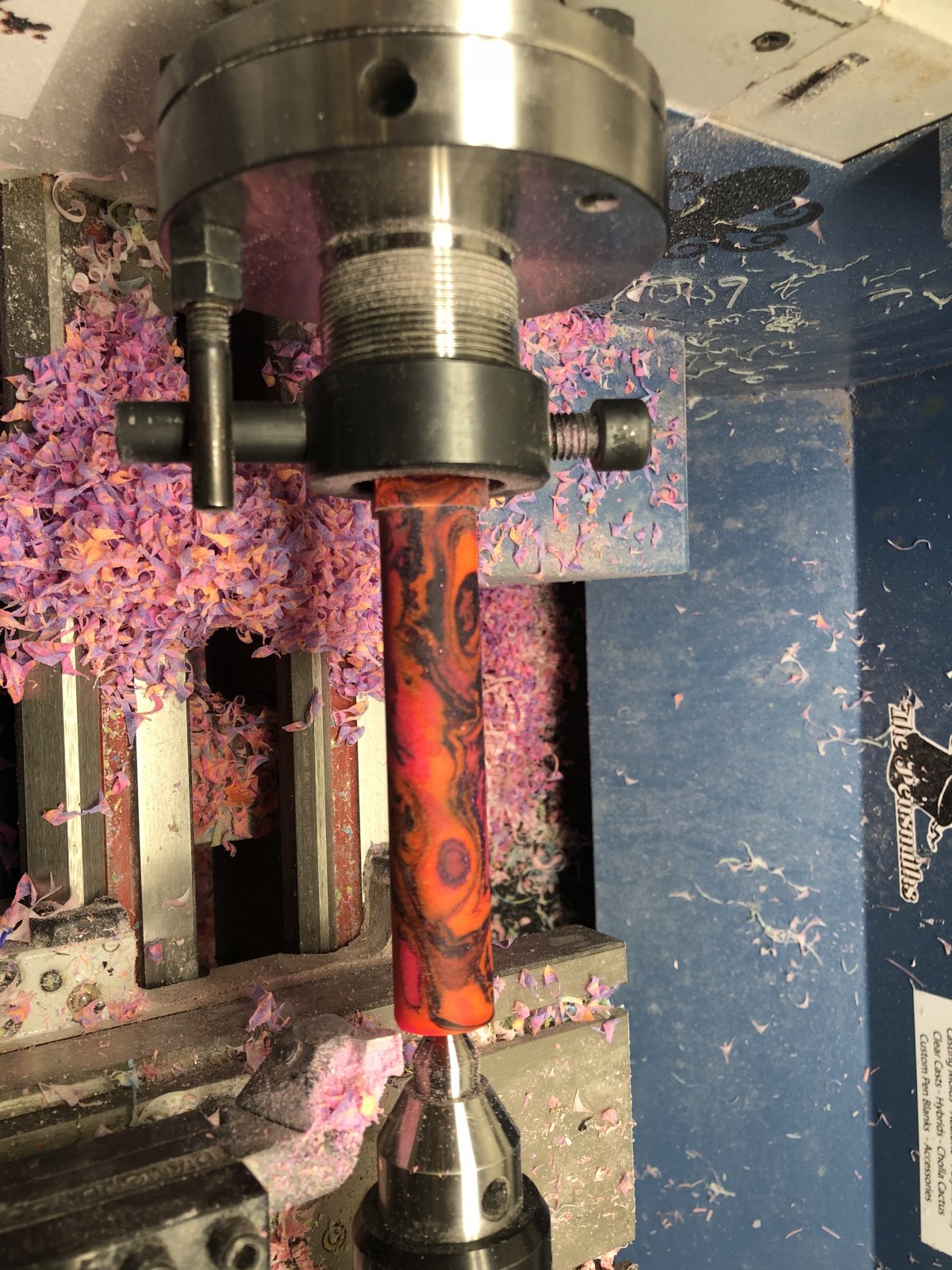

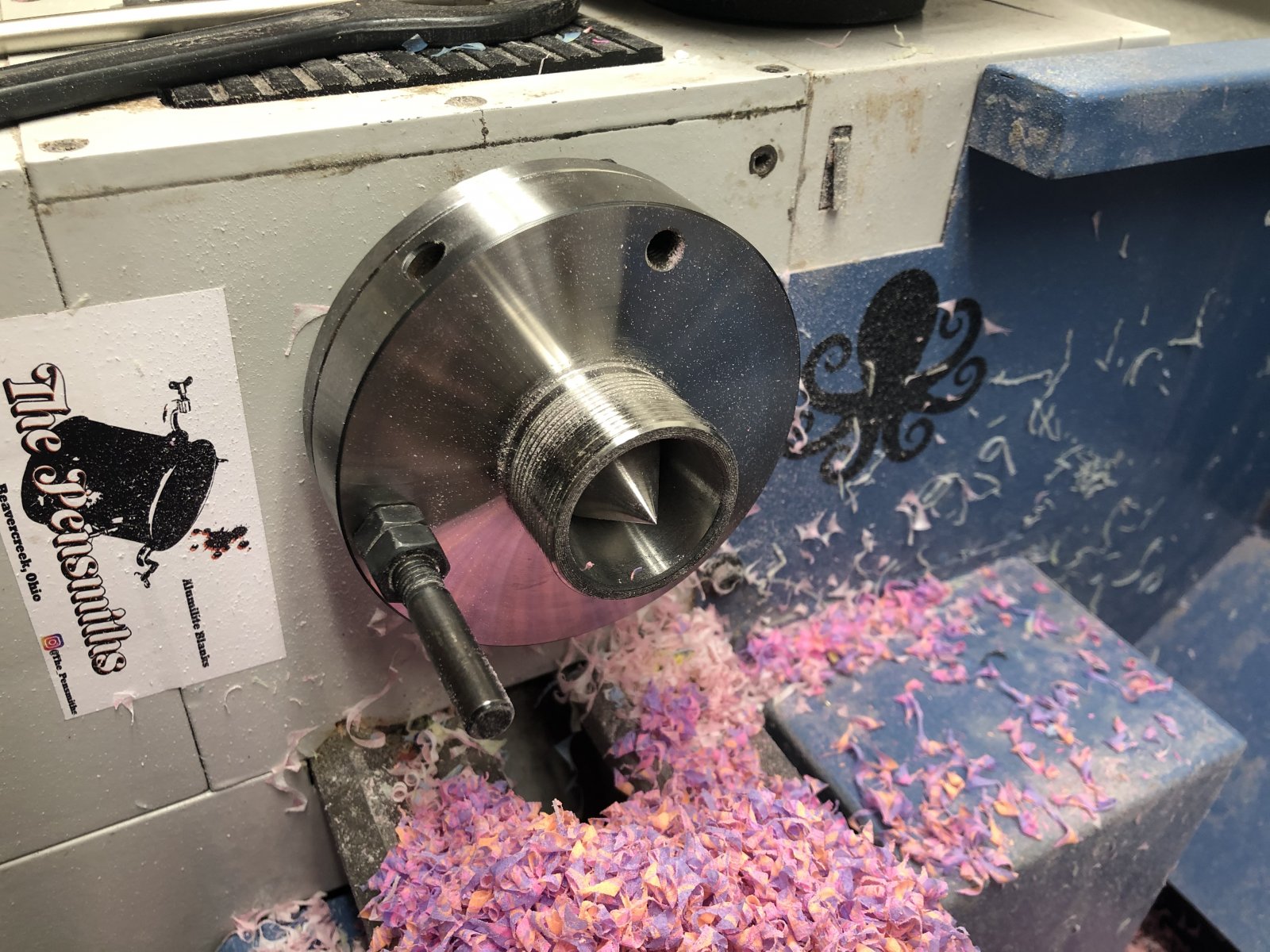

Found some pictures on the phone. Here are examples of using the lathe dog to turn between centers round to square.
Better pictures.

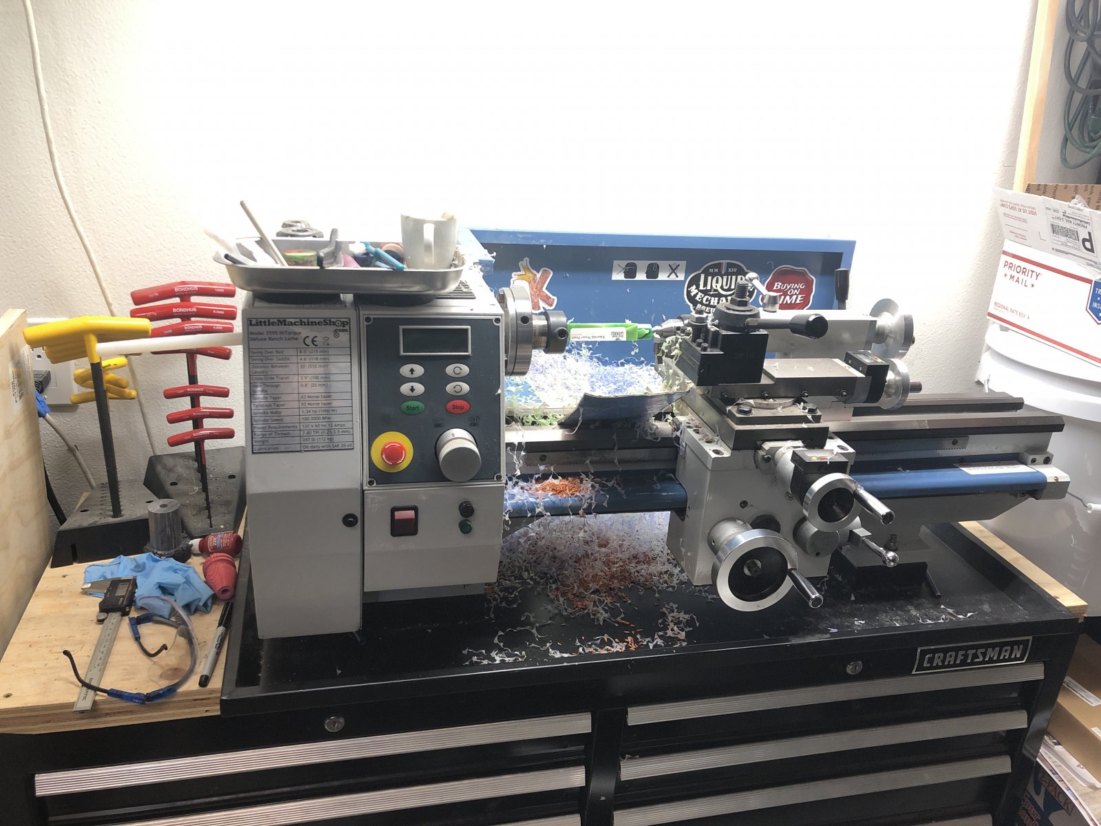

Better pictures.
You have the nice one with all the bells and whistles👍👍
I bought the cheap one, I dont think it even comes with a drip pan, but thats fine..I have a good size sheet metal oil change pan used for cars that I planned on using .
Rob I wonder why you wouldn't use a Steb type centre and skip the knuckle dusting lathe dog altogether? Or doesn't it fit inside the chuck?
Ah the classic debate.
I have tried the steb type center, but it kept slipping, especially when cutting hybrid materials whose densities/hardness changes.
The lathe Dog, has a solid contact, and allows you drive a heavy or light cut with no issue (no slip). Also note, that my hands never go near the lathe dog, given I control everything from the dials and autofeed.
