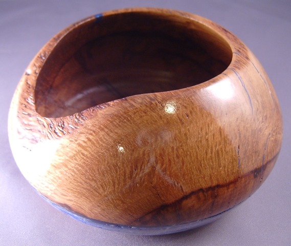

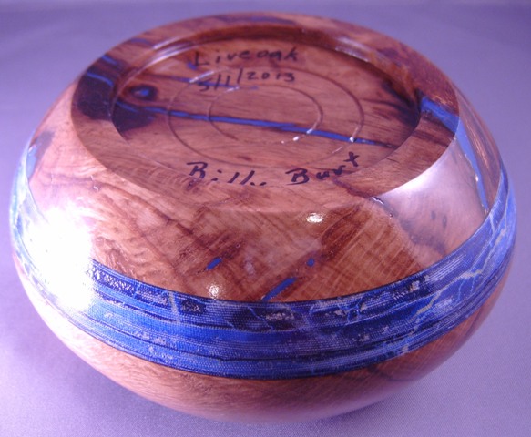

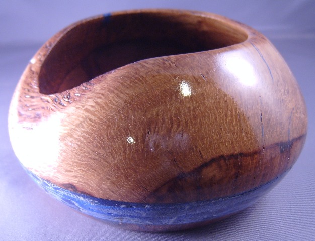

I turned this a few weeks ago. Relatively wet when I started so I thought it would be no more difficult to turn than Mesquite. WRONG! I thought I'd never get a clean cut on the inside... especially under the natural edge lip. I bad catch resulted in a design opportunity that I have been wanting to try for awhile. I cut a dado (groove) around the lower middle and inlaid my own homemade micarta (resin soaked fabric). The other voids were filled with blue epoxy.
As always, thanks for looking and C&C welcome.

Specky bowl, and grain. I love the Oak rays. Funny how a bad catch can create a "DESIGN OPPORTUNITY". That sure is an excellent way of putting it.
Thanks for showing.
Bob.
Hahahaha, I agreed totally with you mate, is great when someone sees a "problem"/"oops" as a design opportunity, is certainly a very positive way to address the issue...!:wink::biggrin:
Billy
I like the shape and what you did to it, its amazing how far a little bit of imagination can go...!
Well done,
Cheers
George
I pretty much gave up turning green live oak for bowls. Most of the bowls warped really bad as they dried. The few that survived looked really nice though.
I wonder if your repairs helped keep yours round?
Ed
