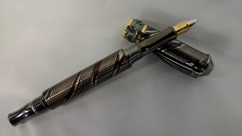

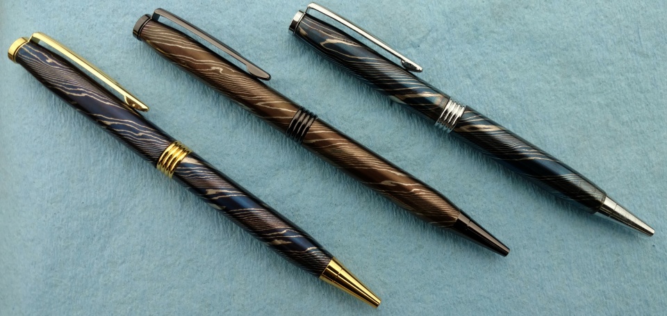

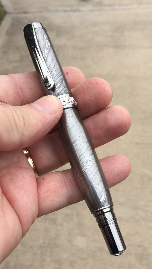

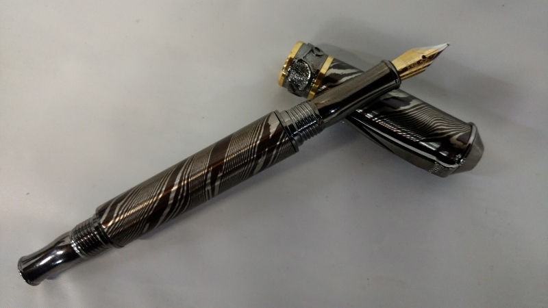

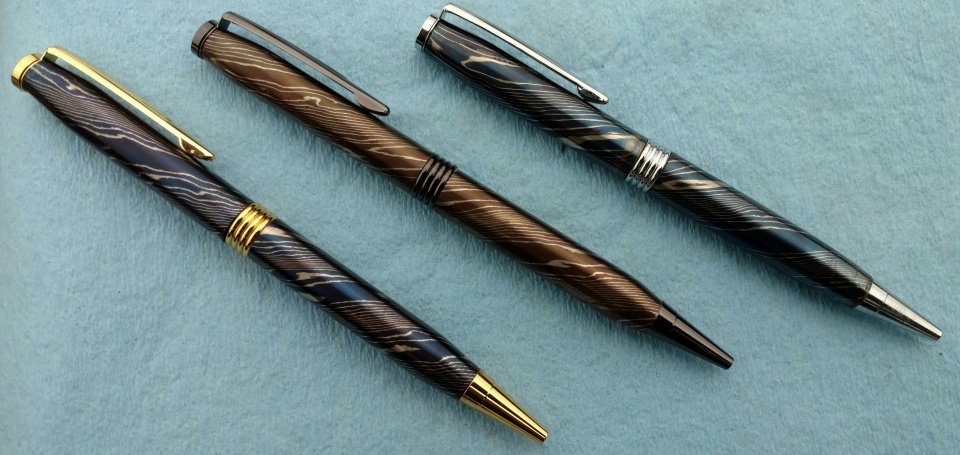

I attached(or hope I did) a picture of a stainless steel damascuss (vegas forge) ring I made with a Jack Daniels whiskey barrel inlay with a carbon fiber spacer. All turned on my little Grizzly 7x12 mini lathe.
I apologize for not having more pen photos but I'm mostly a ring maker. Like I said in the previous comment tho, I run this little metal lathe almost daily.
