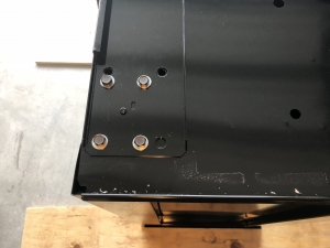

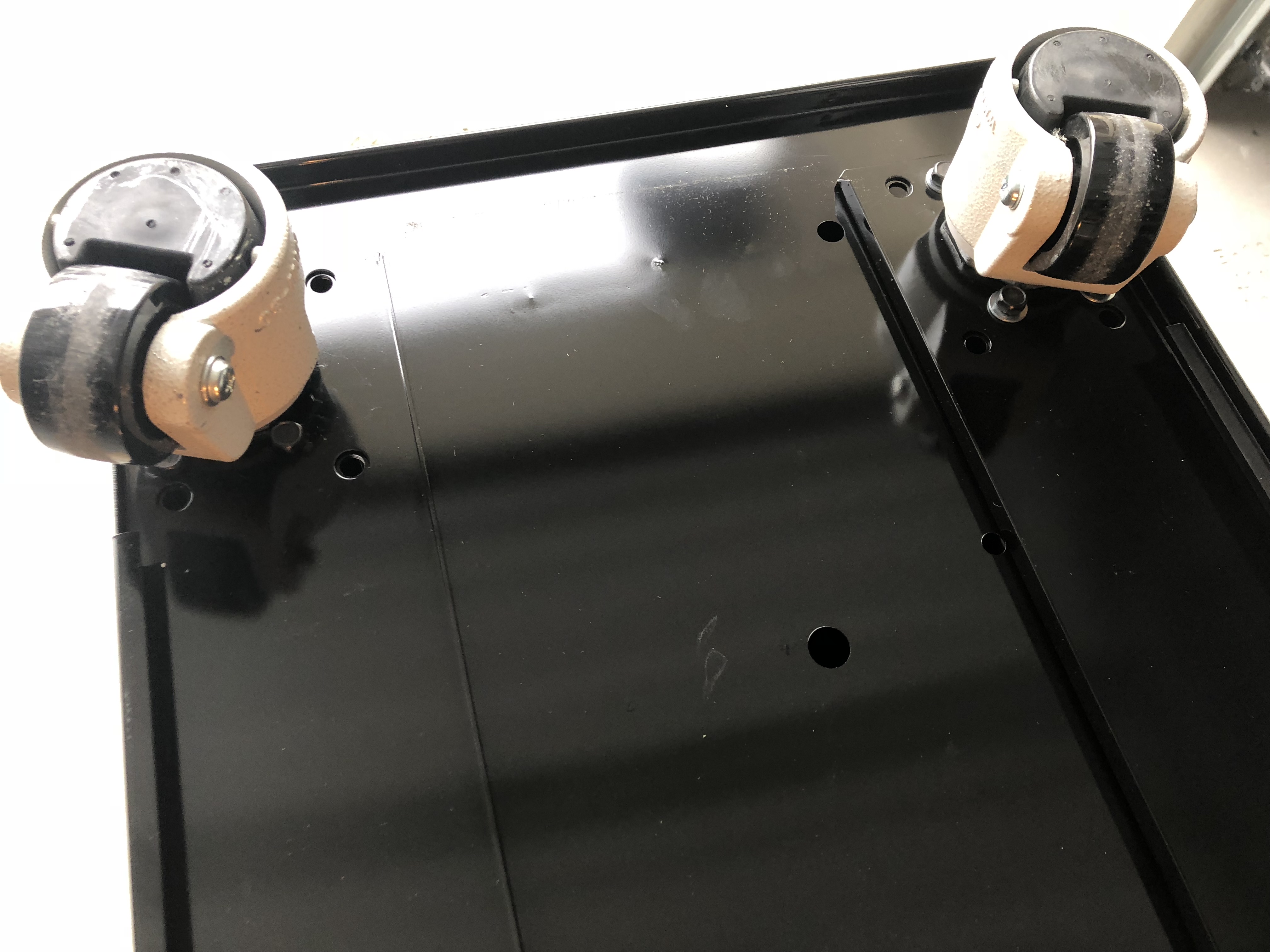

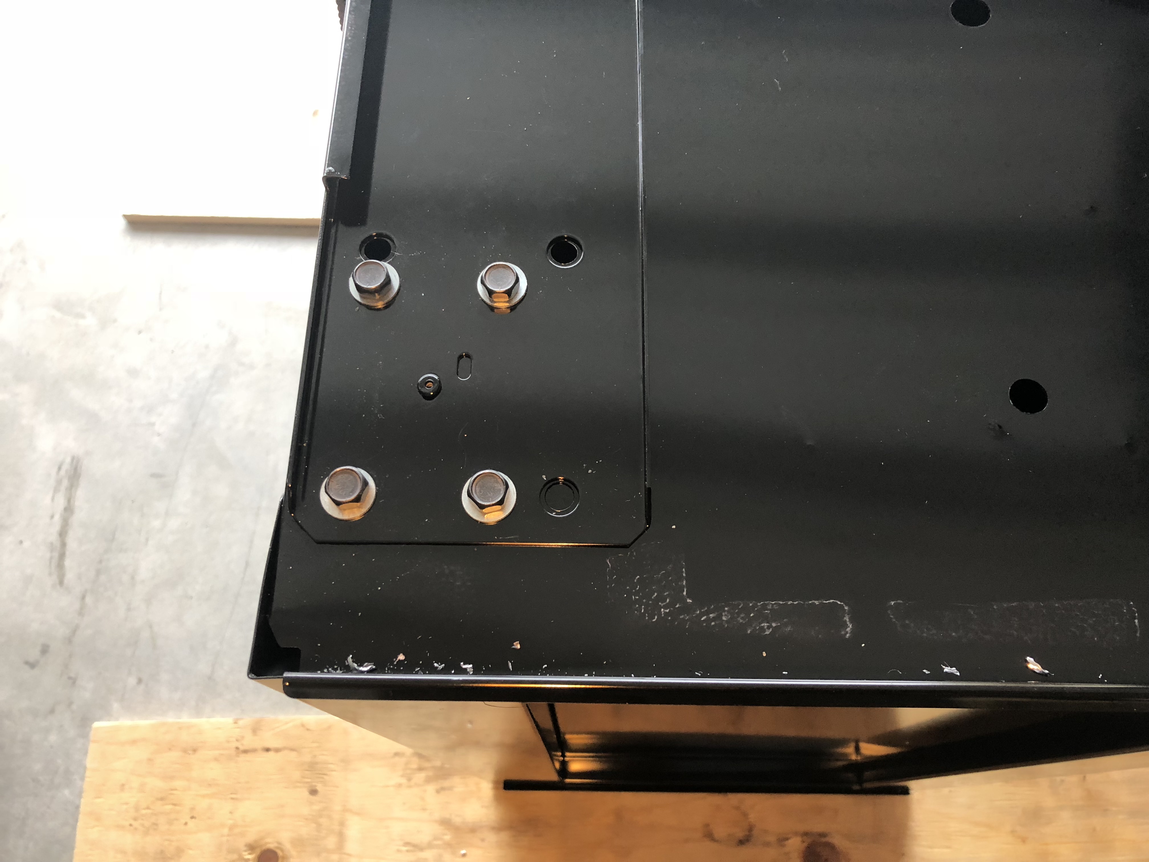

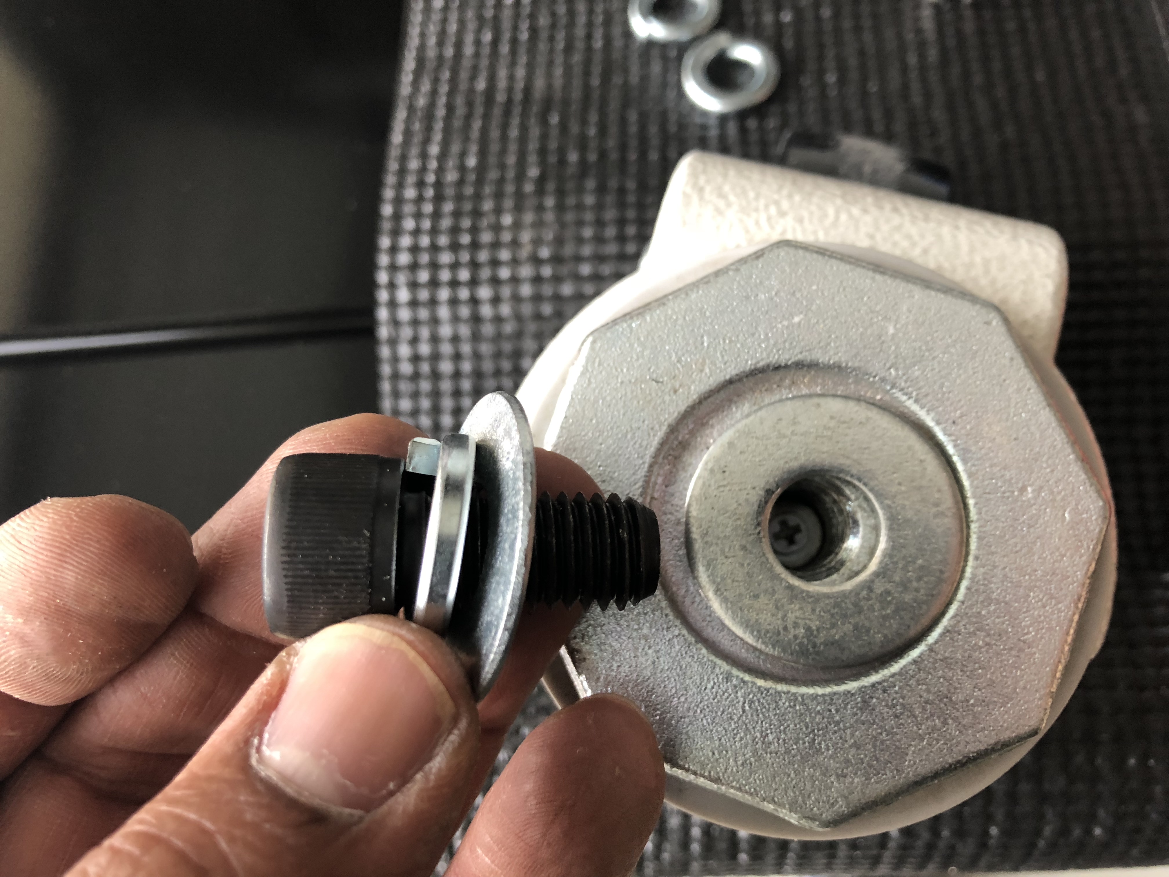

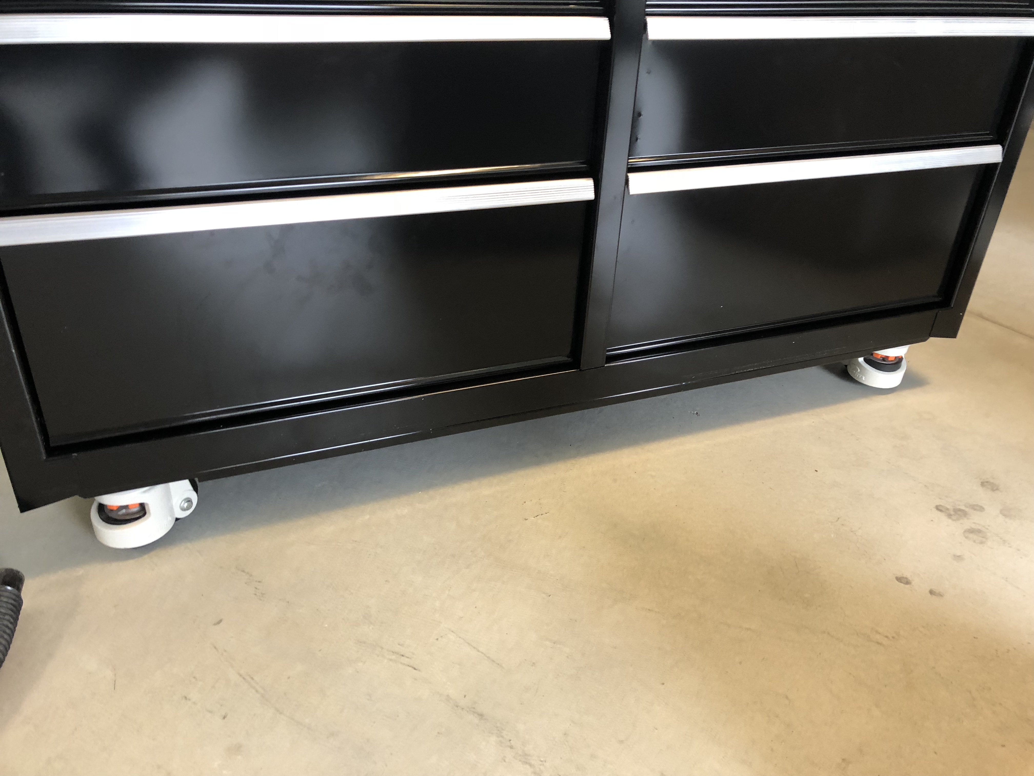

I also acquired 4 leveling casters from a bench rig that was decommissioned, so they were free, mcmaster-carr, part number 2445T13:
https://www.mcmaster.com/#casters/=1d3j3vd
Note, you can also find something similar on amazon: https://www.amazon.com/CasterHQ-Whe...-spons&keywords=leveling+casters+4+pack&psc=1
I put these on my craftsmen tool chest, Sears.com
It now rolls around with just one finger and it can be leveled.
I screwed in all of the caster bolts, without the casters, then drilled out the rivets to the size of the caster shaft and attached the casters.

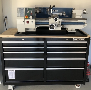

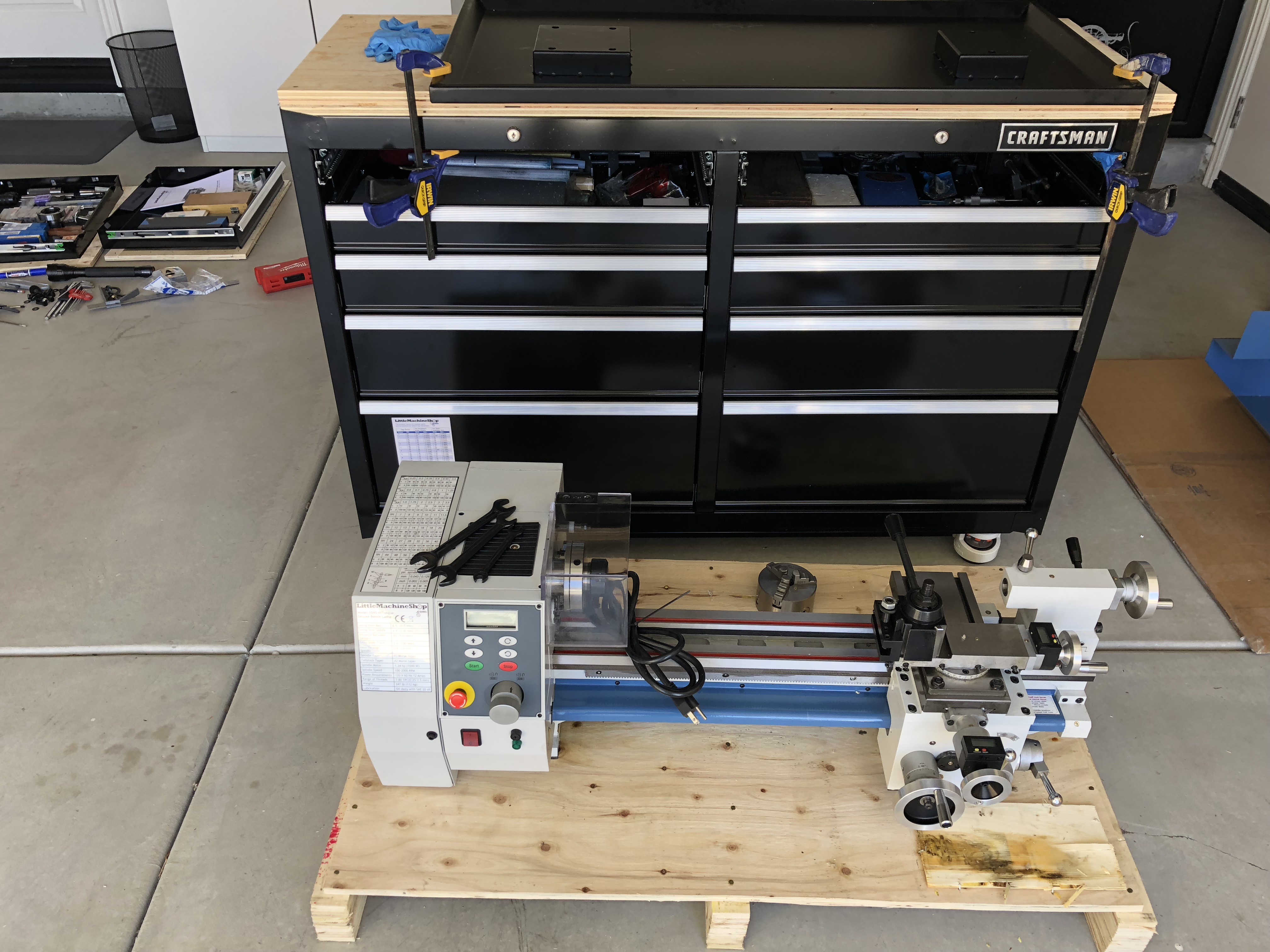

She has arrived. all 230 lbs of her. Boy was she covered in thick oil, took a while to wipe it all off. I also pulled off the sheet metal to help with lifting it in place and swapped out to an er32 collet holder.
Please note, the new drip trays/chip pans do not have a hole pattern as cited in the manual. There are 6 holes that travel clean through the risers and have the same hole pattern as the lathe. That translates into needing 4" bolts to go from the underside of my tool chest through the 1.5" of plywood, through the drip tray risers and into the lathe. Luckily, TruValue Hardware is 4 miles away if that. I went with 5/16 bolts because the metric selection is slim.
Just waiting for my buddy to come to power lift her in place.

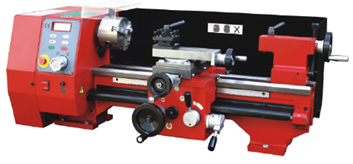

I have the Sieg (original manufacturer of this hardware) version with the mill. I bought the Sieg tool base but it is not as nice as your Craftsman base. I like that idea. I also bought the digital read outs but never installed them. What a waste.
You will love the variable speed feature on this great little lathe.
