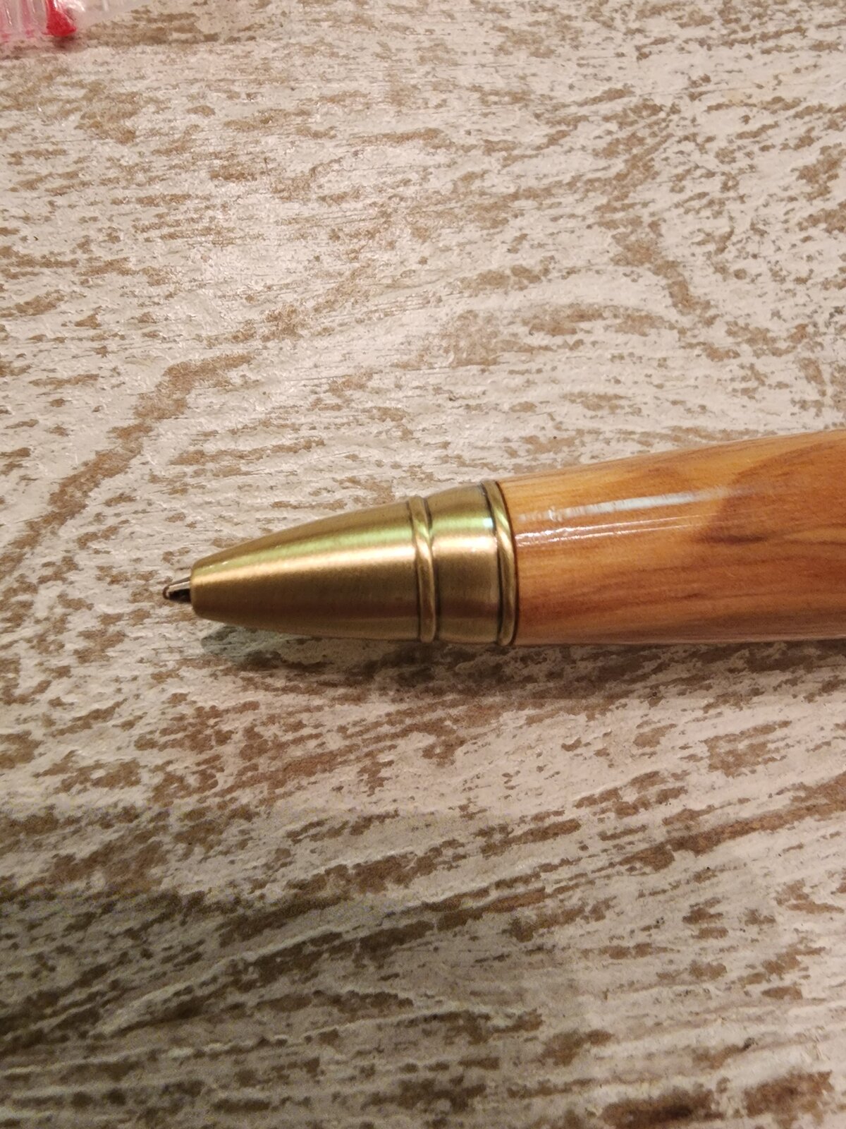

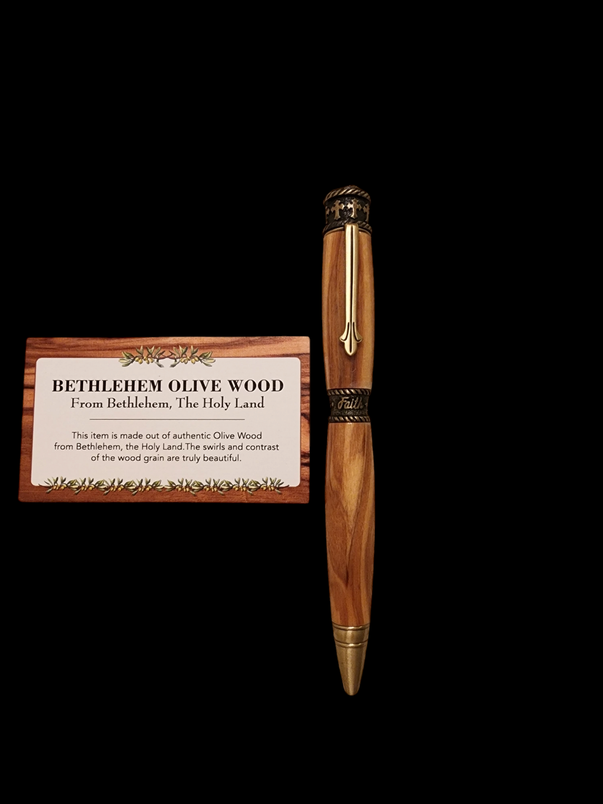

I turned a love,faith and hope pen. When i twist the pen the end barely come out! Any suggestions on how to fix this. I was sent another twist mechanism and still barely pushed the refill ink to the end.

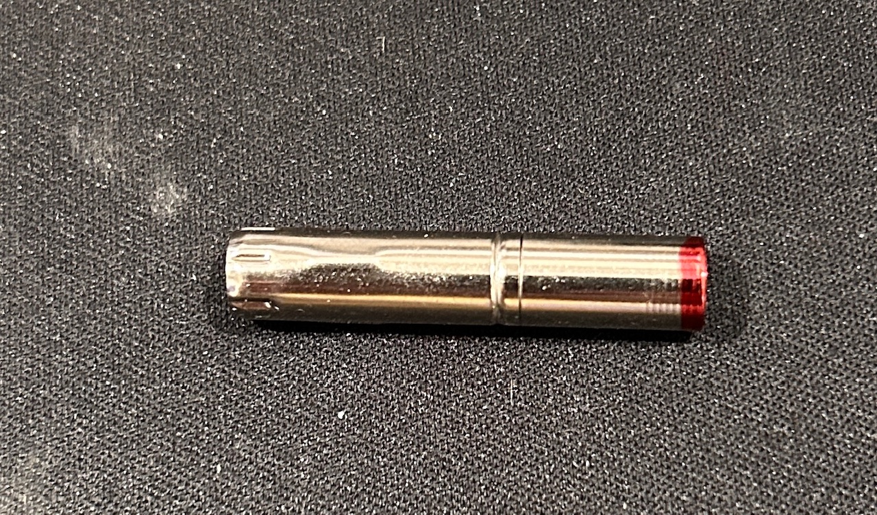

Here's what I do with a short extending refill... I gently trim/sand the (red) end of the twist...The open end with threads. It shortens/lowers the refill thus pushing the refill out to a more desired position. Just trim a little and check...trim slightly more if needed. Before final assembly clean the twist as it'll have filings on it. Not sure of what I wrote??.. I'd be happy to talk you through.

Thank you for the suggestions. I am going to try and sand the twist extender.i would rather not mess with the blank at first. I have an extra extender so I can try it on that one before trimming the blank if needed.

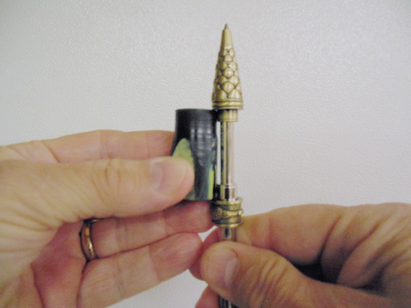

2. The brass tube can be slightly too long or short. If BT too long tip will not extend. If BT is too short, the tip will not retract enough. Photo shows how to judge blank length. This is a Dragon pen, but the idea is the same.

Nice pen. Looks great with the Olive Wood.

I want to thank everyone on the suggestions. I shortened the blank about 1 mm and works perfect. This is a gift to my best friend.
