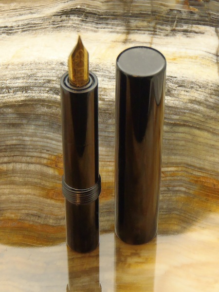

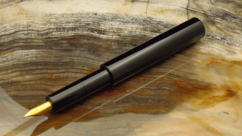

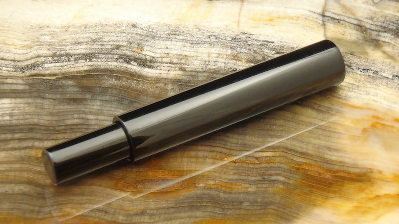

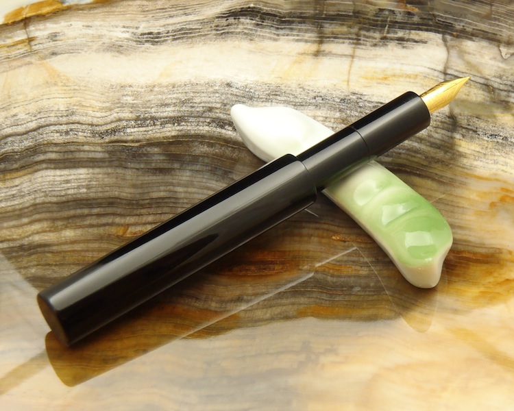

This is the pen I entered in the Best of IAP Pen Contest for 2012.
It is made of Black Ebonite, a Schmidt #5 nib, and takes the standard ink cartridge. Threads are 12mm triple start cap / barrel and 9 x .75mm section / to barrel. Length capped is 3 5/8", posted is 5 1/2" (if I remembered correctly) and it tips the scale at under 10 grams. This one isn't clipped as it is meant to be carried in a ladies purse.
To the best of my knowledge no one has made a pen with this configuration before now, making it compact for carry and a comfortable length for writing.
Please feel free to express your opinions of my pen.

Great job Pete! Novel idea & some "out of the box" thinking. Having seen one of these in the flesh, it really is a innovative idea.
Suggestion if I may... could you incorporate a clip? all I'm thinking is being so compact it could get lost in the bottom of a pocket, bag etc.
Otherwise super pen & great execution, fit & finish are fabulous.

Gotta hand it to you Pete, I love the design. And, since it is made for a purse, the lack of clip is forgiven. :biggrin: Outstanding finish friend.
Thank you all for your kind words and support. It does mean a lot and lets me know I'm on the right track.
For all those that want to know how to get Ebonite to shine and sparkle. I turn and sand at lower speeds than you would with most plastics, about 1000 rpm give or take a few hundred. I started sanding with 320 and ended at 600 or 800, forgot which, :rolleyes: stopping to sand lengthwise at each grit. Then it was a little 0000 steel wool and then went through the 3 stages of buffing with the Beall system, also at 800 to 1200 rpm.
Yes Chris the Ebonite is the stuff you brought me in the summer And it does preffer to be turned slowly or it eats the HSS tool edges. :wink:

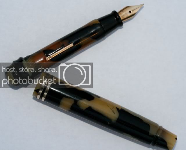

The design is actually similar to a couple I've seen before. One is the Kaweco Sport, and the other ,I'm fuzzy on which company made it (I think either MB or Waterman,) a colleague had a while back was really for women as it was a floral design.
Thanks Shawn. It looks like my original idea was sort of original before. :frown: I should have known I wasn't the only brilliant guy in the world. :wink:
