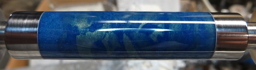

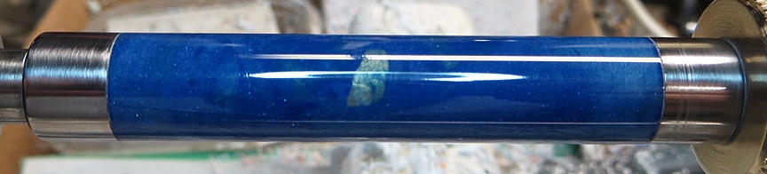

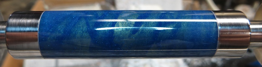

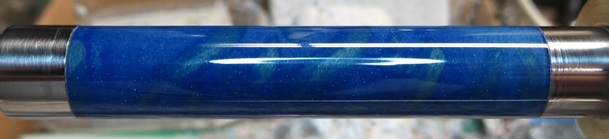

Funny you should bring this up. I generally reverse paint all acrylic blanks, unless I know for sure that they're opaque. But I don't usually paint the tubes. However, after this one, I will always paint the tubes too. In this case I determined that the main culprit was gluing the tubes in while the paint inside the blanks was still wet. I'll always double check that from now on, too. This is a Rhino Paradise Blue blank.

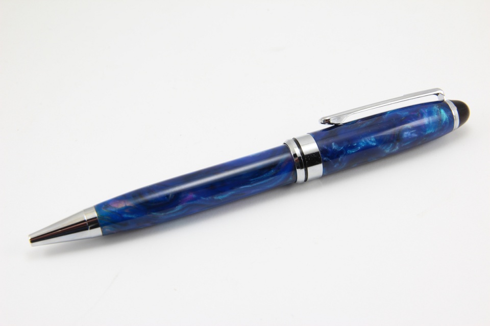

Here's the Amethyst... see pic...

In your photo, towards the pen tip to the left where the color gets light, is that just one of the colors in the blank or am I seeing brass there?
