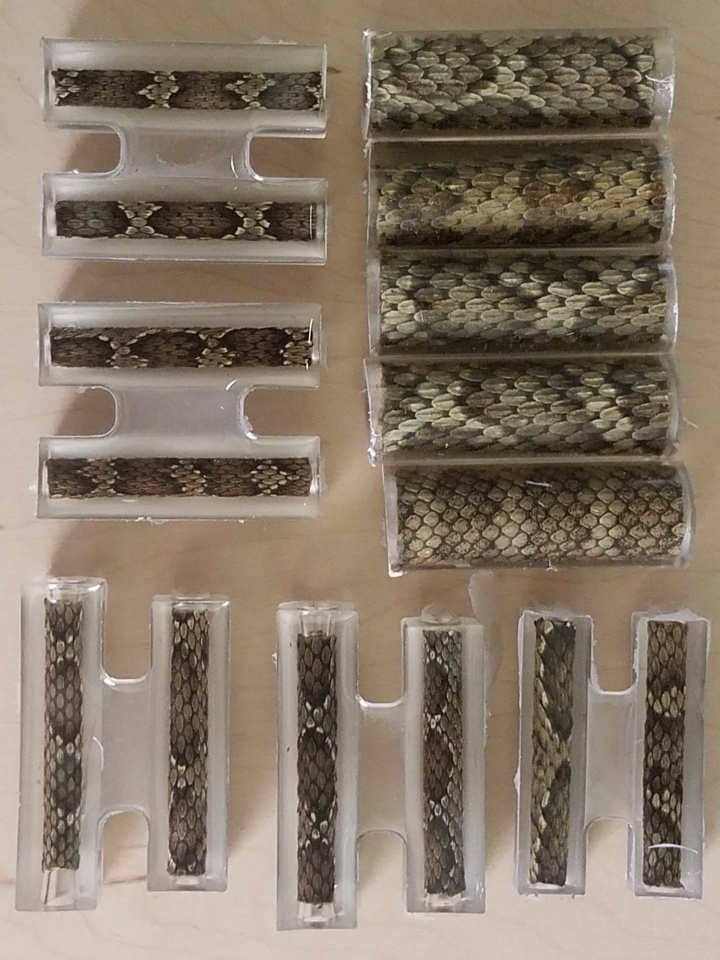

Here are a few of recent snake blanks cast with Liquid Diamonds. No going back to polyester resin for these. Time to order more LD and tubes.

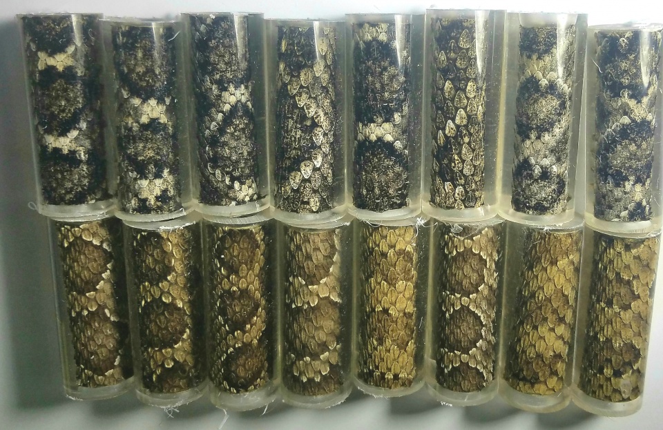

I've started doing my snake skins in Royal Palm. I cast a lot with PR, but for some reason could never get it to my liking with snake skin. Either tiny bubbles (which I don't normally have a problem with, or, even worse, I'd get a little "separation" between the resin and the snake skin at the ends of the tube.
Gary
