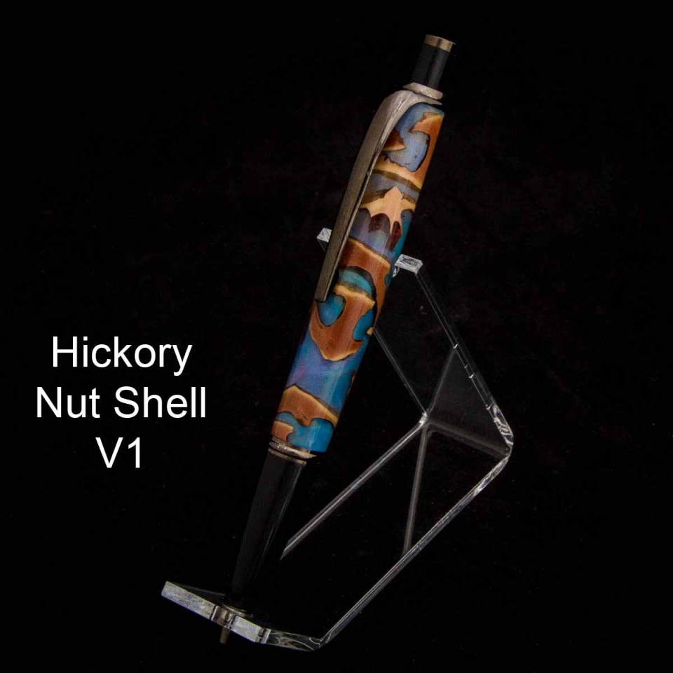

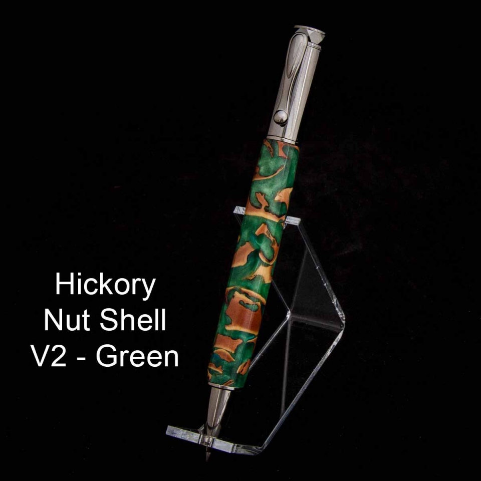

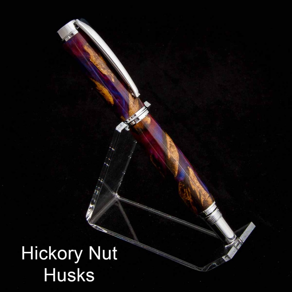

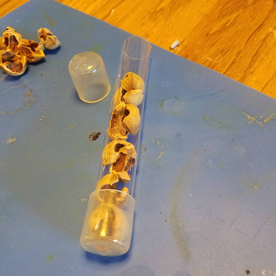

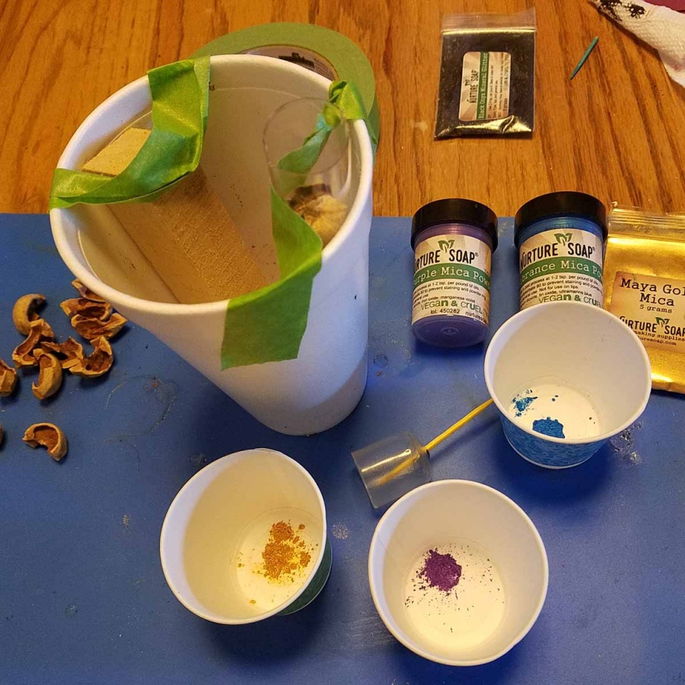

The squirrels around me this time of year are working over time to process the Shagbark Hickory nuts that come off the trees. For the ones they eat (I assume they bury some of them), they usually crack the nut in two halves and remove the meat, leaving the nut halves on the ground. I stepped on one of these the other day and was surprised how hard it was, and I wondered how it would cast up. So I gave it a go. I collected some shells and dried them out in a 200 degree oven for 24 hours. For casting, I simply overlapped the halves into a tube, and swirled in an ounce and half of mica colored Liquid Diamonds. I stuck it in a pressure pot overnight at 30PSI. I went light on the mica, as I wanted it to be pretty translucent, or at least I thought that's what I wanted. I called this V1, and I really like the way the shells turned out. It was too transparent for my taste, though, so I doubled up the Mica for V2, and cast a new blank in greens and one in blues. I also tried casting some of the "husks" this time, in red and blue. On the green one, rather than "half shells", I used "eighth and quarter shells", so the shell material in my casting tube was denser.
I really liked the way the green shells turned out, though not wild about the way I left the profile kinda fat on that Zen. I haven't turned the blue blank yet, but I have high hopes. Since the shells kinda remind me of little islands, I used a blend of colors to try and represent a tropical ocean.
I didn't really care for the way the husk blank turned out. It turned fine, but I think they lack character in the way looked in the end. I used a Caballero for kit on that one.
I really prefer Liquid Diamonds for this sort of thing over Alumilite. For me anyway, it's so much more fun to have that long open time. I don't mind waiting the extra day to turn the result. I know it's more expensive, but at an ounce and a half per blank, the cost isn't much of a factor. So far, the squirrel union hasn't organized to start charging me for the shells.

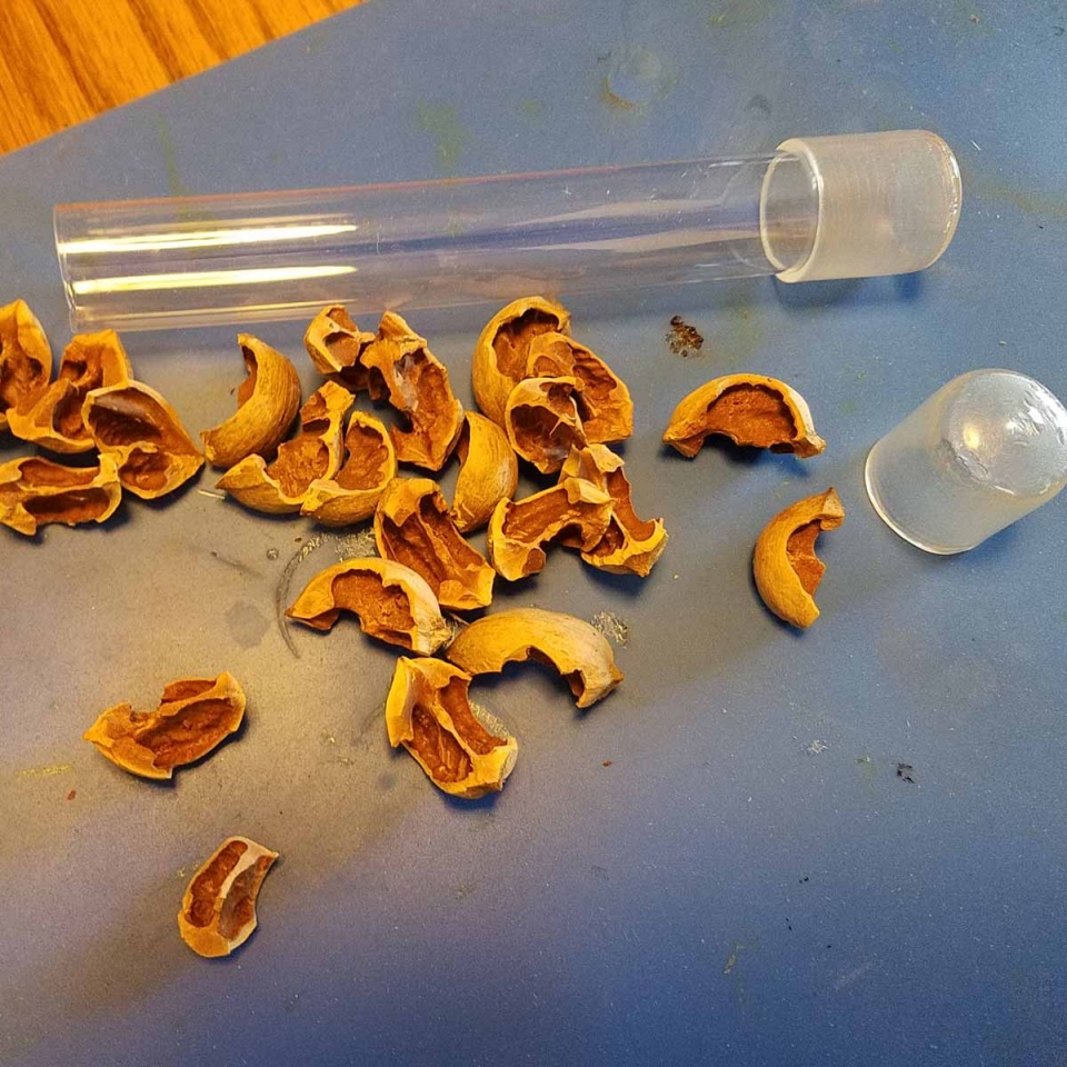

Curious? Where did you find the tubes you cast in?
Congrats Roy! I favor the green one but they all look great! I hope they are easier to turn than walnut shells. I've cast a few of them like this but those things are like cement. I haven't used liquid diamond resin yet but from your success I'm guessing it's good stuff. Keep up the great work!
I'm using Uline 3/4" clear plastic tubes:
https://www.uline.com/Product/Detail/S-13749/Tubes/Clear-Plastic-Tubes-3-4-x-12
I got them a couple of months ago and really like them. I find myself reusing the caps because the epoxy doesn't stick to them, so you can just take them off prior to turning without any damage. They look good post cast, and turn off pretty easily.
I see I can buy 48" versions from a few other places for about the same cost as Uline charges for 12" (Uline is around a 1$/tube). I like the thin wall on the Uline tubes, though, so haven't pulled the trigger yet to try a longer/cheaper alternative.

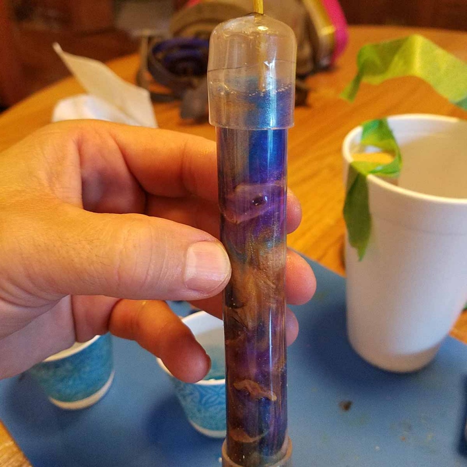

No, I mixed up the ounce and half, stirred it well, then divided it up between my three mica cups, and then stirred again to blend the mica. I started pouring into the tube right away. I did a little bit of two colors at a time, then rotated which two I was pouring until I had them all in. Then I angled and rotated the tube around a bit to give any air trapped under the shells a chance to escape.
The "air under" was more an issue for those husks - I think I rotated those around a couple of minutes because I could see air in the tube in this one spot towards the bottom.
I think on all three, I might have had one "pin hole" each that I had to fill with CA when I got them turned close to profile.
I read where somebody felt they needed to wait a bit (45 minutes?) with Liquid Diamonds because the mica would settle if you cast it to soon after mixing. That makes sense to me, however, I've never waited and never seen the mica settle at all.

FYI - The air wasn't from within the resin, but rather from pouring resin into a tube filled with little umbrellas (e.g. the husks)...
I put these in a pressure pot overnight at 30-40 psi. Since I have one, I didn't really think much about not using it.
I thought I read where people have had success with Liquid Diamonds without potting, but I've not tried it. Given it's thinness and long cure, I could see why you wouldn't need a pot to get rid of bubbles. So maybe, if you're just swirling together different color epoxy, it'd work just fine without a pot. However, when you're embedding foreign stuff, seems to me like you'd want some compression on everything while it's setting so it doesn't come flying apart on you when turning. Do you really need to clamp things up when segmenting? To me, it makes sense you do...
