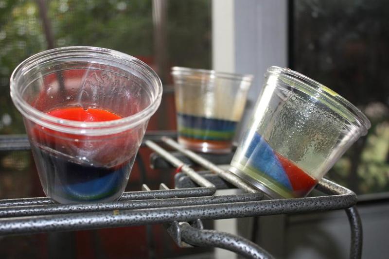

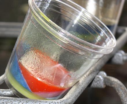

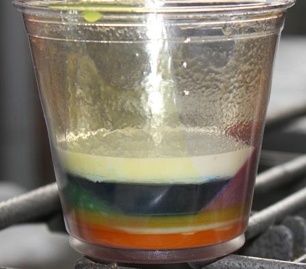

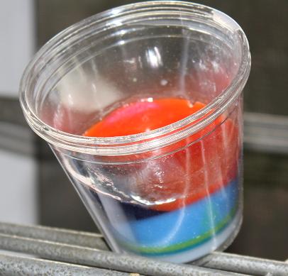

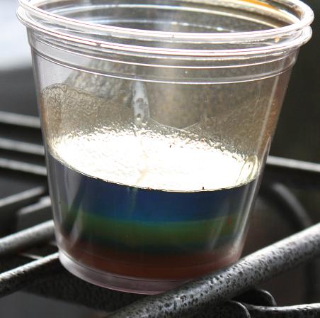

Ron,
Thought I would try to bail you out on this one and post some pictures.....:biggrin:
I think this is what you are talking about with your left over resin. At least this is what I do with mine.
I pour them into a cup leaning at different angles and when it gets enough in it, I cut them into pendant blanks for turning.
No resin is wasted this way. These cups have been left over from the last gallon of resin. I don't have a great system for determining how much to make for each mold yet......
