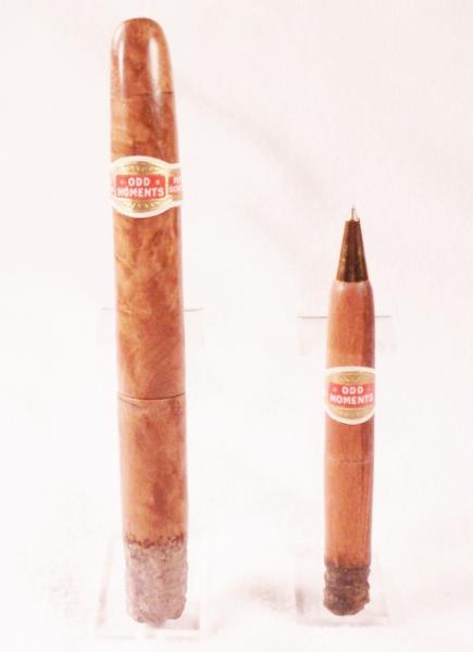

"Dad, when I grow up I want to be just like you !!" Here are a couple cigar pens I put together the other day. Thought you might get a kick out of them. Large one is Quilted Sapple, small one is Brazilian Rosewood. Jim S

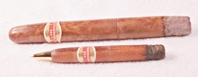

Thanks Harry; The little one is a PSI Mini Designer Pen, but any of the mini pen fittings will work. Length is about 4 inches. Will add open photo next time I set up camera. Jim S

Thank you posting the pic Jim.
Now i have another question :rolleyes: after seeing that pic.
Never noticed it in the first pic, but it appears you have another seam :confused:
care to elaborate on that?
Harry; The reason for the second seam is twofold. First my blank was not long enough to make a full length cigar, but I did have two blanks with the same color and patterns.. Many cigars are in the 6 to 7 inch length, so if you want to be true to scale, you need a longer than normal blank.. Second, I wanted to see if I could turn a double closed end pen on a mandrel. There is an article in the library on how to do this. I drilled the blanks, mounted them on the mandrel, and turned them down to the size I wanted. Than I glued on the extra piece on one end, and the Buckeye Burl ash on the other end. I than used a pin vice and live center to finish turning the pen blanks. It was kind of an odd way of doing it, but many new turners don't have all the gadgets and gismos on hand to do this the easy way. Using collets, pin vices, or turning on centers would be my first choices. Jim S
