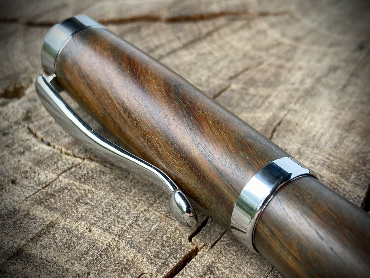

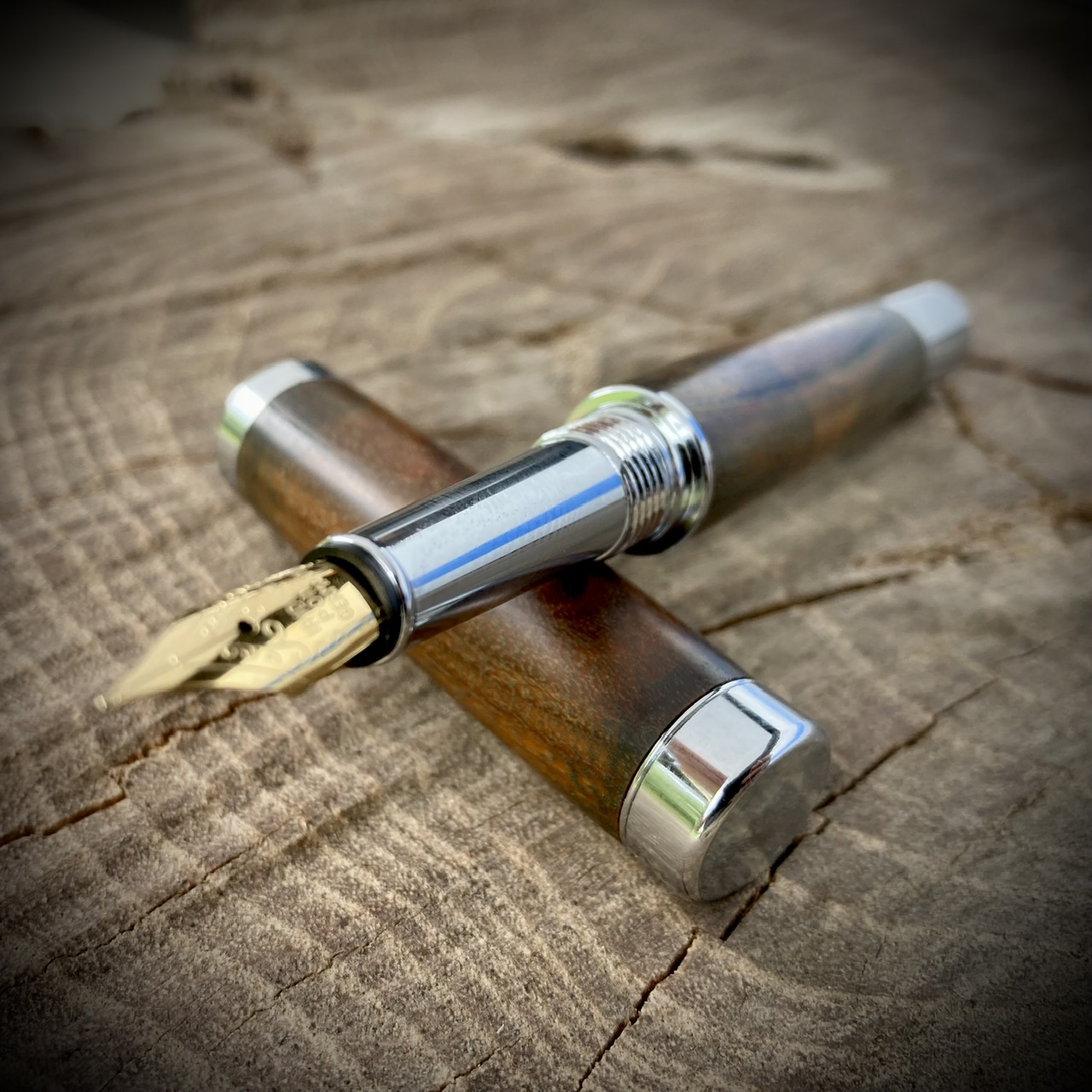

I saw a post recently of someone making a pen with Lignum Vitae— no finish. Hmmm…?
When i read this I had been at a Woodcrafters store where they had some of this wood, but I didn't buy. Regret. 😅 I was back there and this time bought a board to try. I mean, this wood is legendary! Top 5 hardest woods in the world, rot resistance so strong they use it to make boat propellers. And a scent like perfume that stays on your fingers after handling.
I made my first pen and it has excellent luster with only burnishing. I added one coat of walnut oil. It darkened the wood dramatically over night. I hoped the scent would remain…and it did! This will be my journal pen for a while. I want to see how it wears. There were several small cracks in the board, which I filled with thin CA prior to cutting into blanks. They're visible in the photos, but I'm hoping structurally sound.

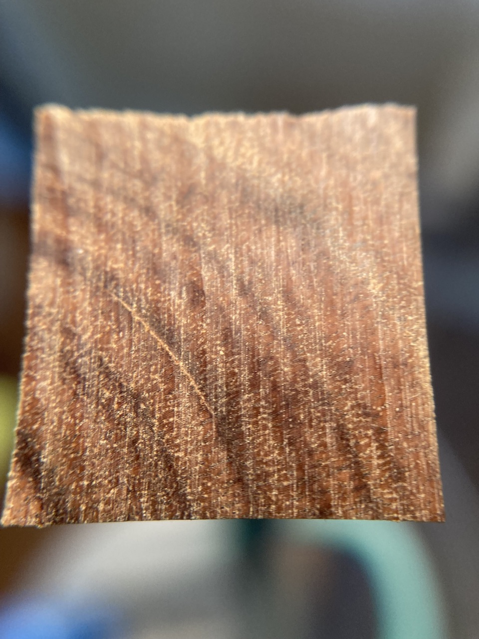

I did some checking online and the Argentium variety has connected diagonal pores, whereas the genuine has isolated singular pores. This is mine. I'd say it's Argentian.
If you bought it from Woodcraft, 99.99999999999% it's Argentine lignum vitae (even if they advertised it as genuine lignum vitae or Guaiacum spp.). Nothing wrong with Argentine lignum vitae--it's very hard, very beautiful (the green you sometimes see is phenomenal!), and the perfume scent (at least to me) is quite pleasant.

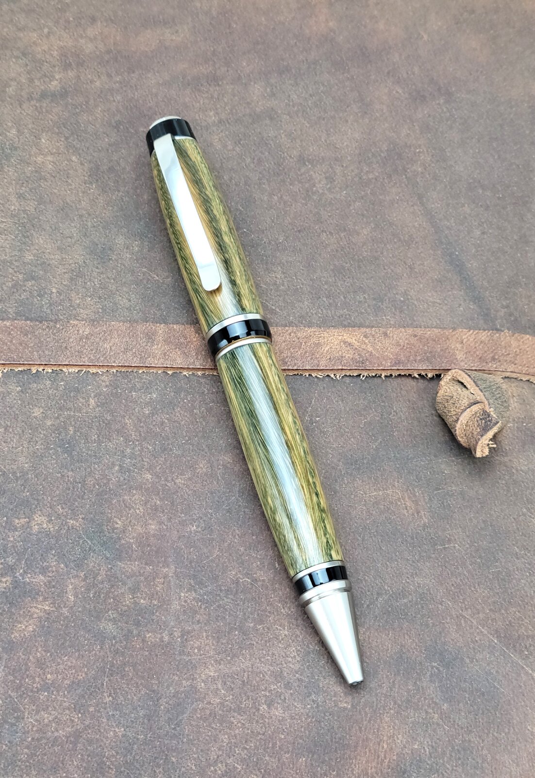

That's a great looking pen. I love ALV (most of what you can find is the Argentinian variety). The smell is definitely one of the best. The feathery grain is pretty cool, too. I found a 1" x 1" x 40" piece a while back and still have a couple feet of it left. It hasn't cracked, but it was also very well waxed. If you leave it out in the sun, at least parts of it will turn a dark green. Here's one I made a while back.

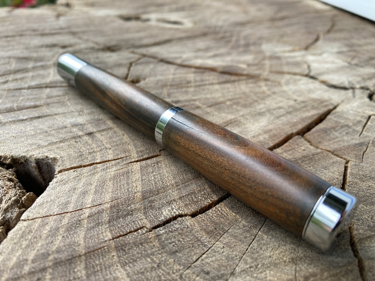

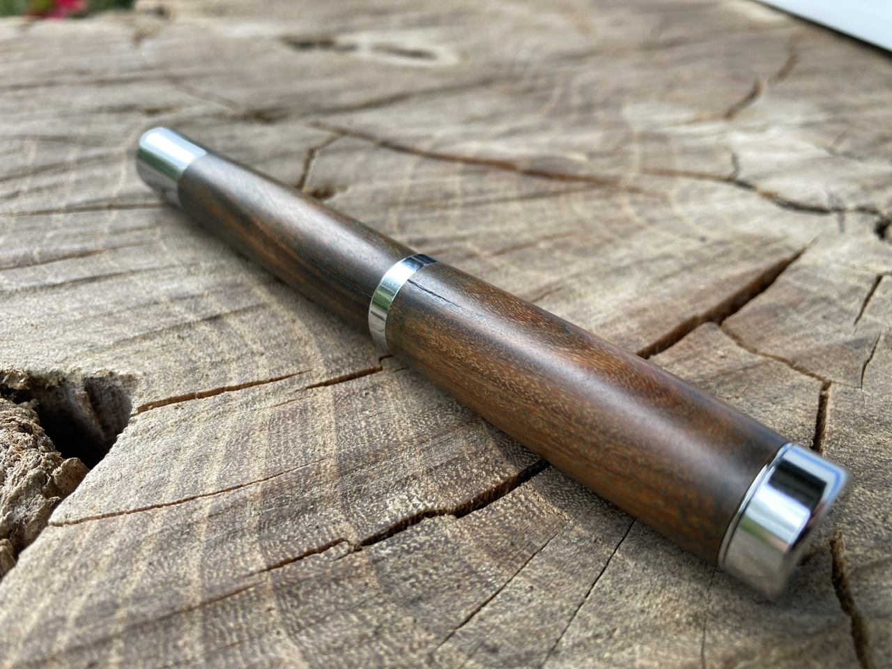

I am not sure if this happened to you, but given the placement of the crack, I wonder if it did. With harder woods like this, I've found that the expansion introduced by these compression-fit fittings can cause this. I've had the same problem with trustone, which is also quite hard.
I've taken to thinning the tube a little, and then trying to sand or otherwise grind down a bit of the fitting to the point where it is more slip fit. That avoids the expansion introduced by forcing a compression fitting into the tube, which prevents cracking at the ends.
This is one of the reasons I wish that pen fittings weren't compression based, and were more of a slip fit that we glued in. I generally like the look of harder materials, but they have this added risk of cracking.
Not in this case. This crack was there before I turned it. I didn't have the cap on right in the photo, but it carries right on over to the pen body too. It doesn't bother me, but is one of the reasons I put this piece of my board on an inexpensive kit and plan to use it myself rather than sell or gift. Actually I'd be very proud to gift this one. It's a pretty cool pen.
