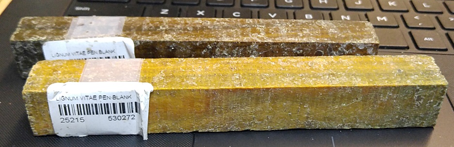

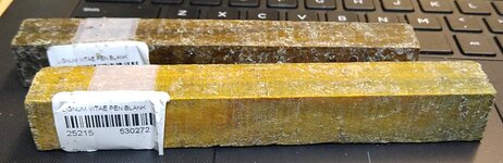

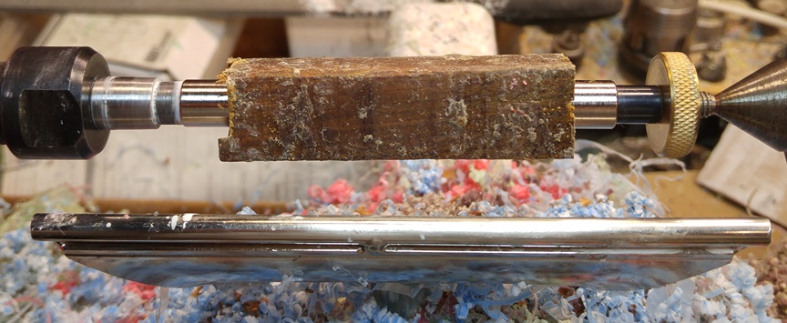

When I was a kid, my dad had a chunk of lignum vitae in his shop that he called ironwood. He told me it was so hard and dense, that they used it for prop shaft bearings in WW2 submarines. It always fascinated me. I don't know whatever happened to the chunk he had, but I found some pen blanks at the local Rockler today. Anybody ever worked with it? Would Watco Danish Oil be a good finish for it?

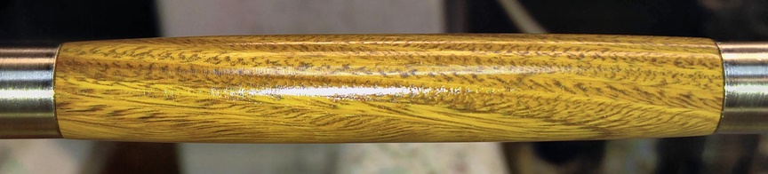

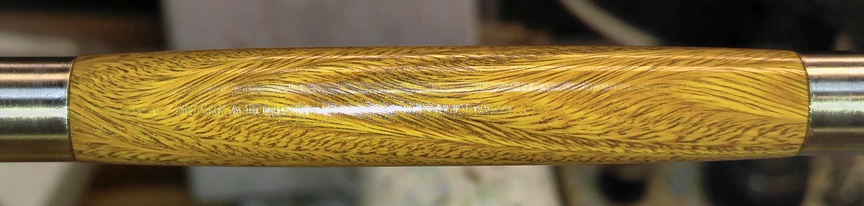

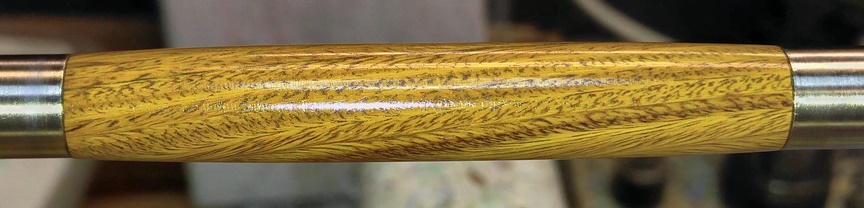

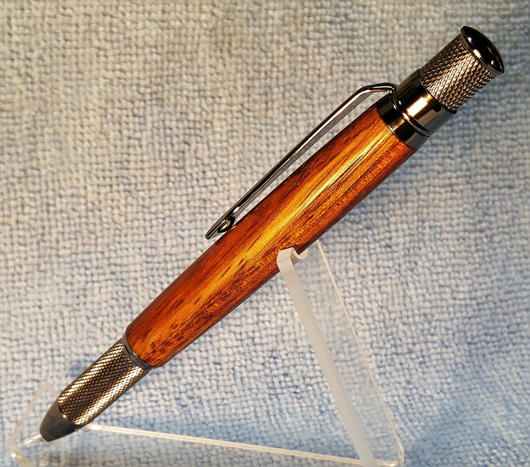

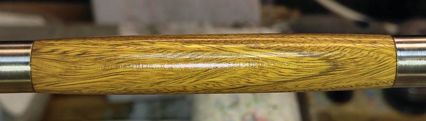

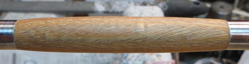

It's hard to believe that this ugly, wax coated block of wood turned into this gorgeous pen body! Whether it's "real" lignum vitae or Argentine, I still love it. I went ahead and finished it with Watco Danish Oil. I'm assuming that the sheen will lessen with time.

If it has a green tint is is the fake LV. It turns nicely, polishes well and is oily. A soft finish like the oil-varnish mix sold as Danish oil should work well. A light pass of OOOO steel wool will make gloss sheen into a matte sheen

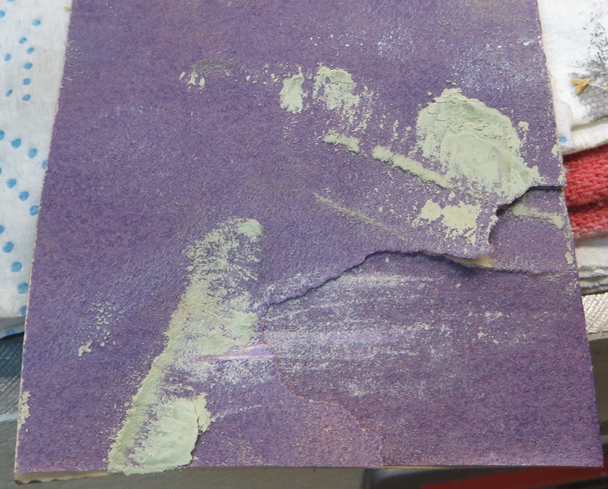

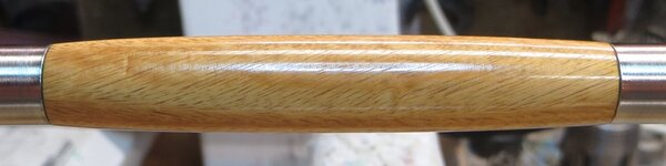

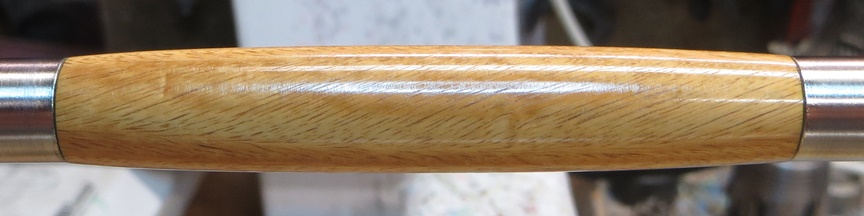

The second blank was more oily than the first, and the goo that accumulated on the sandpaper definitely has a green tint to it. But the blank itself doesn't look green to me.

Looks like vera wood -- the "real" stuff is a lot more brown/cream.
Vera wood is a joy to turn and polishes up well. One can consider not putting any finish on it as it tends to be oily and like the "real" stuff does not traditionally require a finish.
