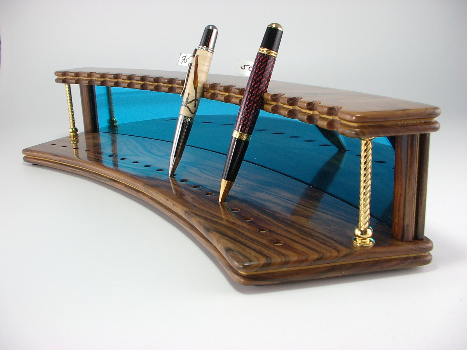

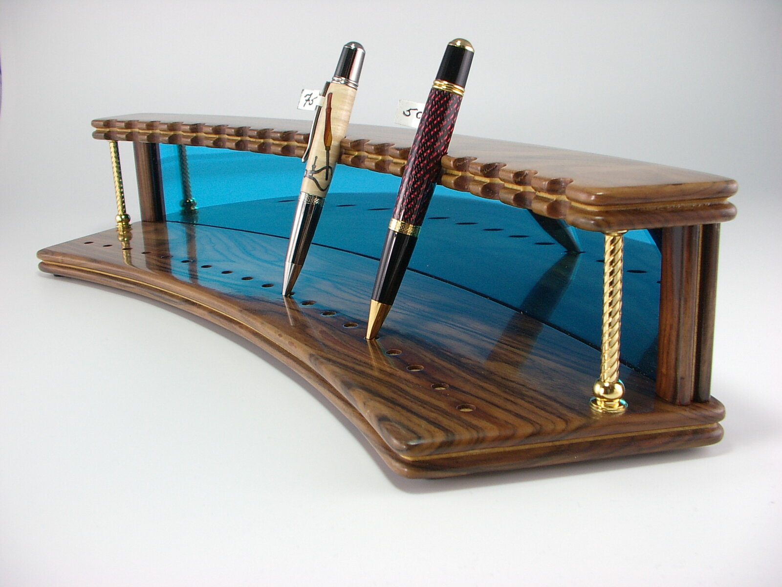

I love to work with exotic woods like that. They are closed grain and the oils polish up so nicely. I like to use woods like Bolivian rosewood, Hondorous rosewoods, Bazillion ebony and so on. Many of these woods can not be had any more because of restrictions. I use to be able to get from a supplier in my area before his shop burned down a few years ago and he never reopened. Now I have to buy on the net and it gets expensive. But I love to use as bases on some higherend pieces I make. It gives the piece class and so easy to finish. I sand to 600 grit and then hit on a buffing wheel as mentioned above. They come out with that soft warm glow that is so touchable it is hard to explain. Lignum-Vintae is another one of those woods. Here are a few example of what I am talking about. Brazilian ebony, Bolivian rosewoods and so on. I should mention canary wood is another wood that I polish too. People may not think you could but yes possible.
Correction on the penrack that was waterbased lacquered before polishing. I remembered I did that because of the yellowheart and the cutouts for the pens. My computer is not allowing me to delete so just left it. Sorry.

I am curious what you used for the mirrored backing there. Looks like it has a bit of a curvature...so it must have been something flexible? Looks really great though! Love that!
That is plastic acrylic mirror. It comes in many colors and I use it alot in my scrollsawing projects. Very easily cut using my scrollsaw or any saw. I just got a new computer so I do not have my photos loaded to this thing yet or else I would have included a few more photos of things I made using it.
