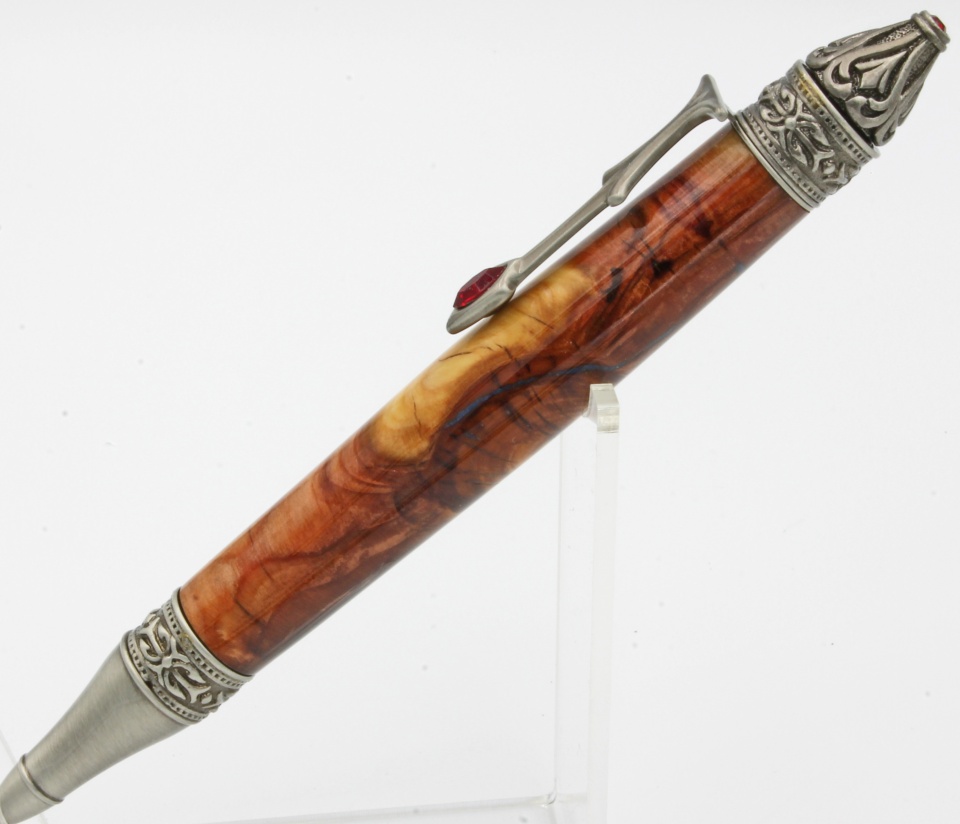

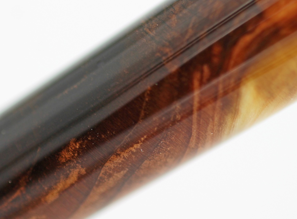

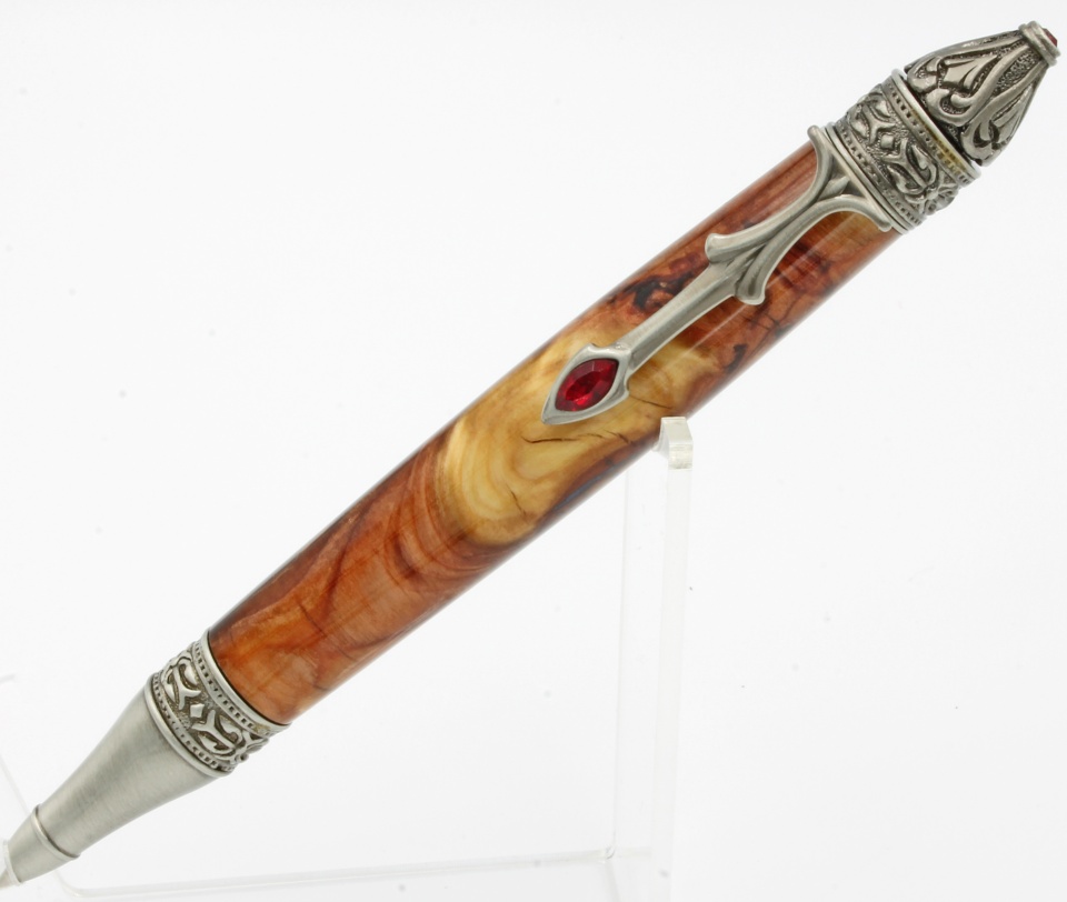

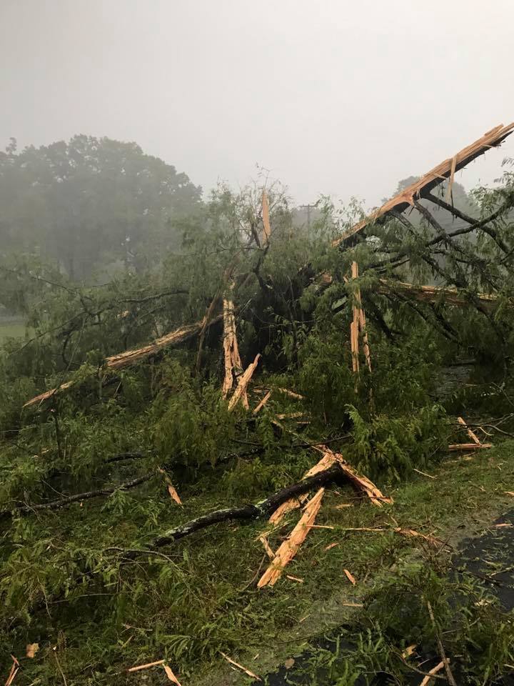

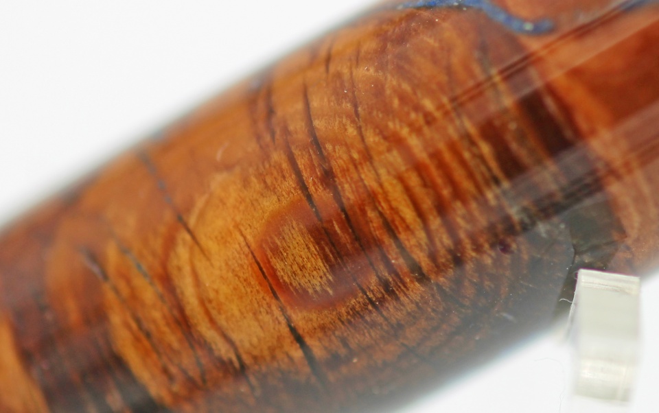

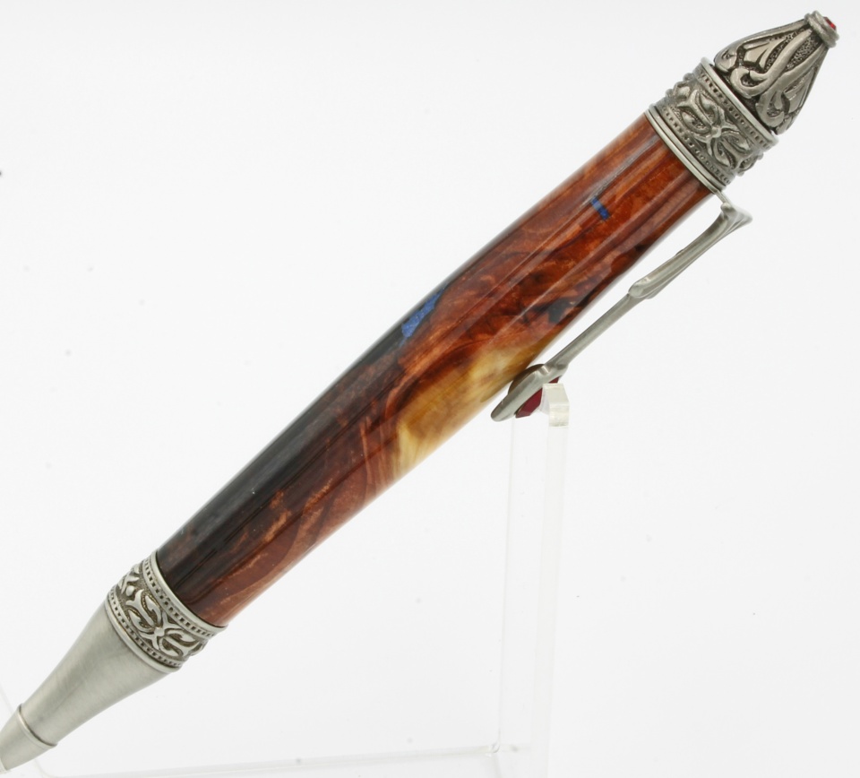

Sorry, I haven't posted any of my pens for a while.
This one is made using wood from a redwood tree that was struck by lightning and completely destroyed. I crosscut it to try to capture the red and cream colors and also to try and get some of the charring from where the lightning struck. I was also able to get a knot dead center. I had to stabilize the pen twice to be sure it was able to be turned. I filled the checks with Blue Lapis.
Pen style is Gothica and the finish is CA. This one I am well pleased with!

Beauty from Tragedy Stephen.
That Lightening Strike sure made a mess of that Tree, and you now have a Fantastic Memento of that Force of Nature.
Fantastic Treatment of the Charred, Stressed, and Shattered Blank, a Wonderful Display, of your Ingenious Blank Making Skills.
A Superb Choice of Hardware, sets the Blank off Beautifully.
So pleased to see you posting again, you have been missed.
