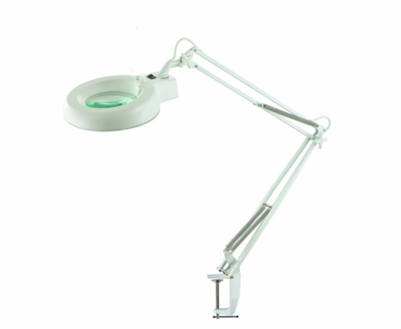

I use a light similar to this clamped to my work bench behind the lathe. Swings wherever I need it and out of the way when I don't.
I also have one of the magnetic mount goose neck lights for detail work.

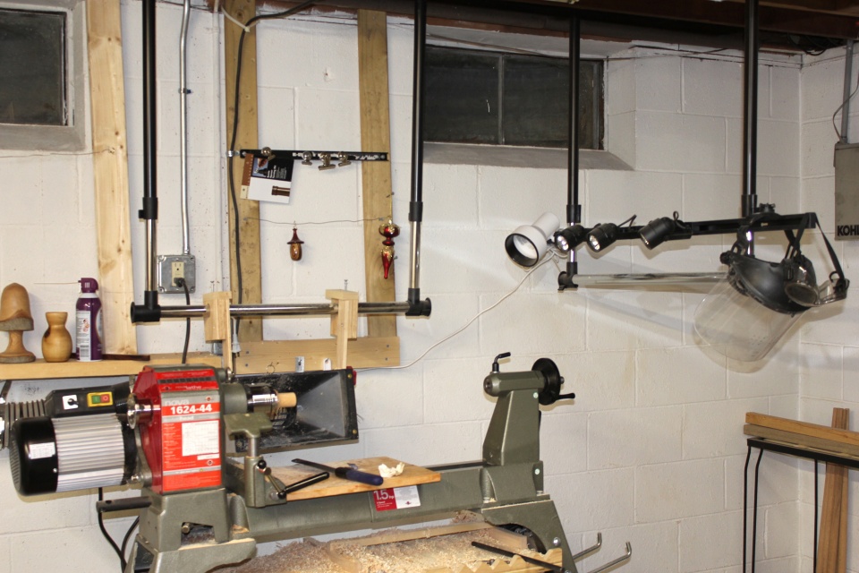

OK... So I may be OCD.. a little.
The pics are for my NOVA 1624-44. My Mini Jet is just to the left.

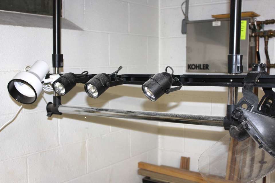

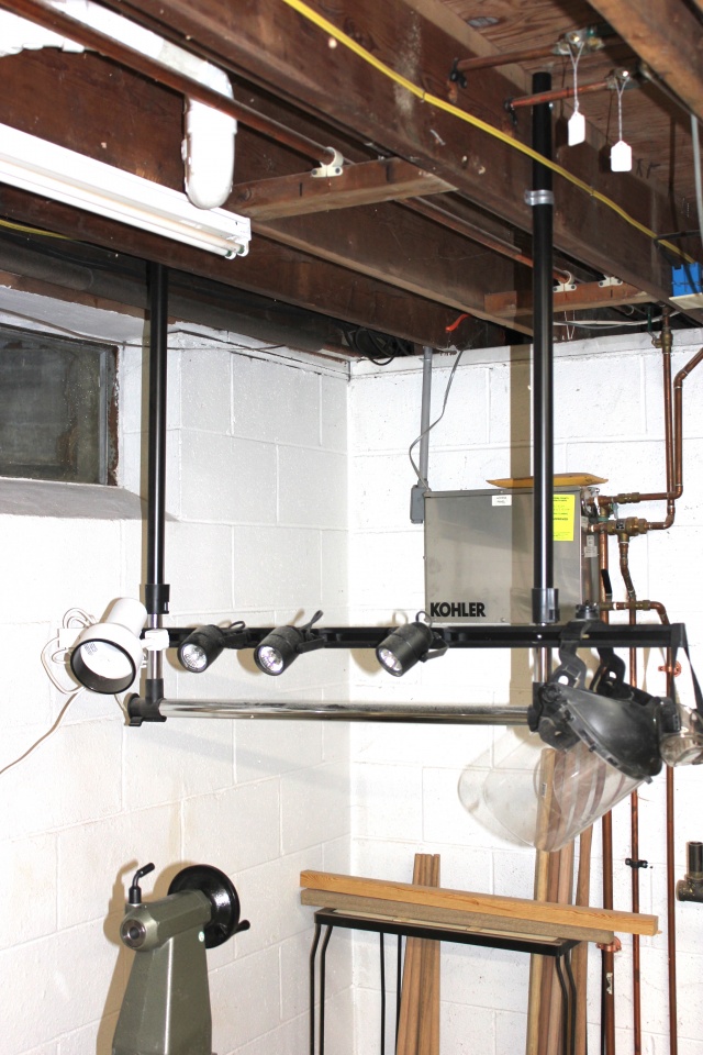

The racks are... Cloths Racks bought from ALDI's Grocery store - about $10 seasonally... Really cheap clothing racks. But cut up/ turned upside, mounted into the ceiling joists, voilla...a movable light rack. I added a Home Depot light bracket and as many lights as you want. Total deal... maybe 35-40 dollars.
And it was a project - what fun!
I can move it up/down 14" and the lights can be moved as needed, or added to.

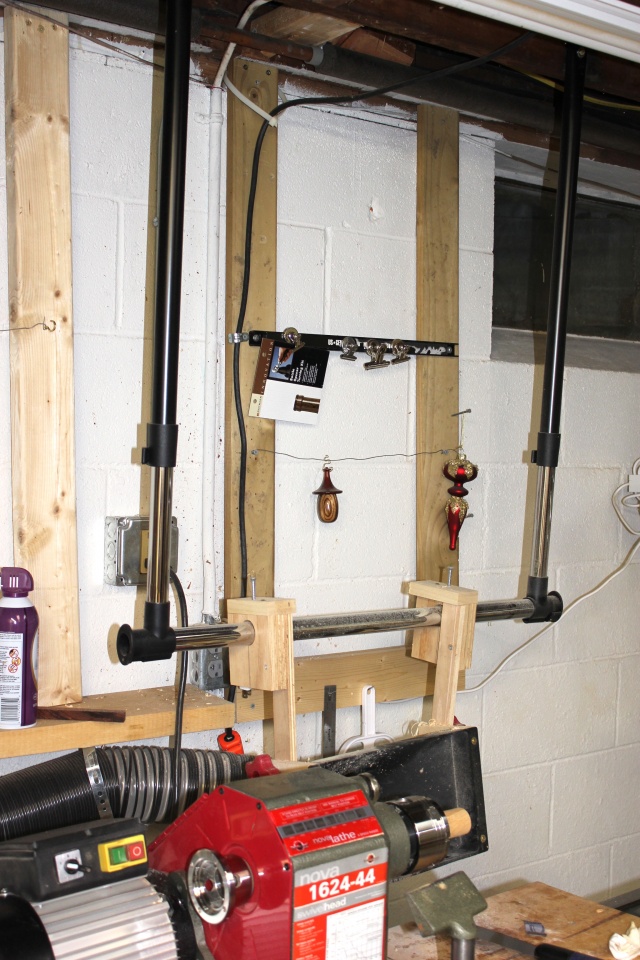

I did almost the same for the dust extractor - Aldi's Clothing rack/a few modificatioins... done! $15! :biggrin:

I can't locate an Aldi's in Arizona, so... You may have to IMPROVISE the clothing rack upside down! :cowboy:
Anyway, works for me and its an idea!

I use a light similar to this clamped to my work bench behind the lathe. Swings wherever I need it and out of the way when I don't. I also have one of the magnetic mount goose neck lights for detail work.
With the magnifier?
Helps to see all the scratches!!!! :eek: So you can sand/polish some more..... :biggrin:

I use this exact light and a "gooseneck" halogen magnetic lamp too. Works great!
I have the same light , too. I need to get a second light - dark in the one-car pen studio.:smile:
