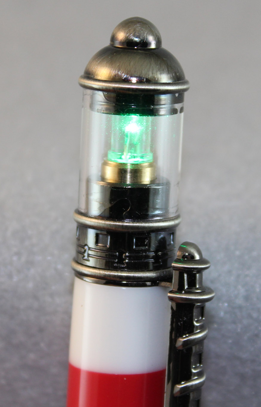

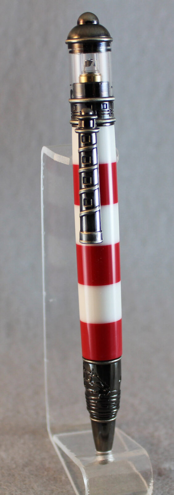

Received my kits last week after preordering before Christmas and finally got around to assembling one.
Here's my take on the new light kit and a mini revue.
The kit assembly is very straight forward to assemble.
My only concern is it takes a mini refill that is shorter than the regular mini .

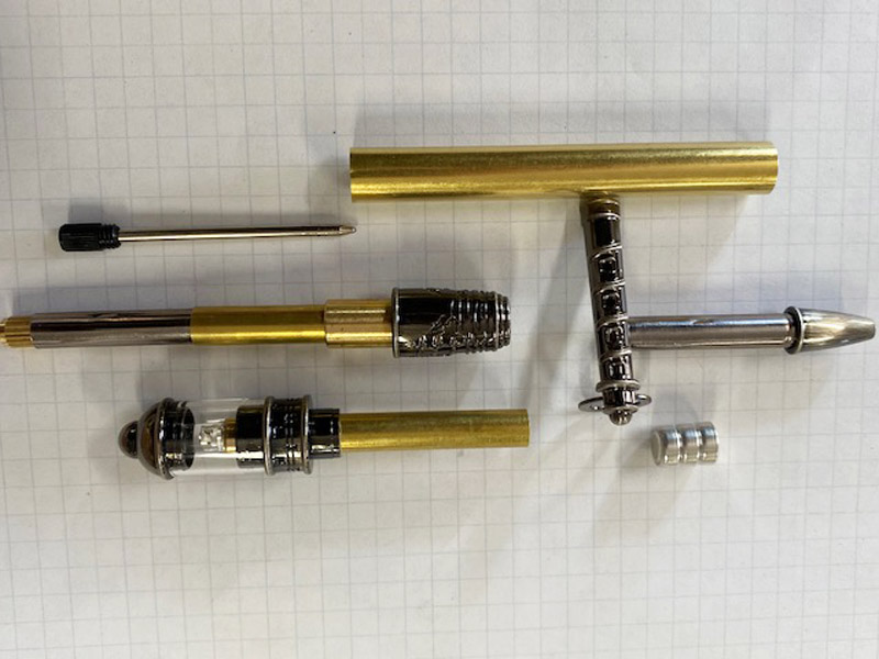

Here's the parts.

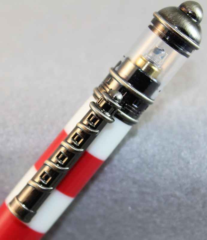

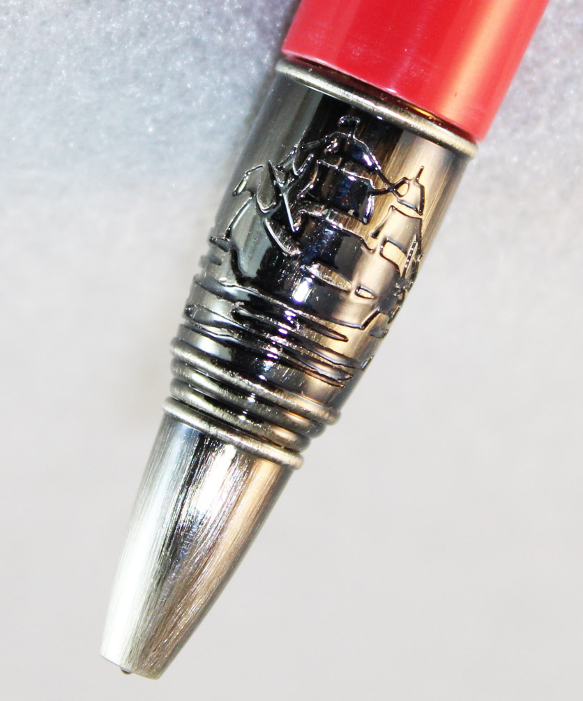

Here's a few more pics
The light flashes green red and blue.
I think for the nautically incline customers this could be a big hit.
As usual all questions and comments are welcome
Mike

Thanks John and Mal.
The batteries are LR41
The light end unscrews and it takes 3 batteries and there's only one setting .
The light turns on by twisting the area right above the nib and the nib turns to work the refill.
The refills are replaced by pulling the nib out.
The refill is only 47.5MM which is shorter PSI credit card pen.
Right now the only place I can find them is Rizheng so I'll have to do more looking.
I got mine from Pen Kit Mall and sent them an email about refills.
The finish is gun metal.
I don't think it would be possible to modify their design because of the way the light works.
How top heavy is it?
It's not bad.
Any more questions just fire away ,
Mike
