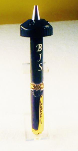

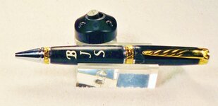

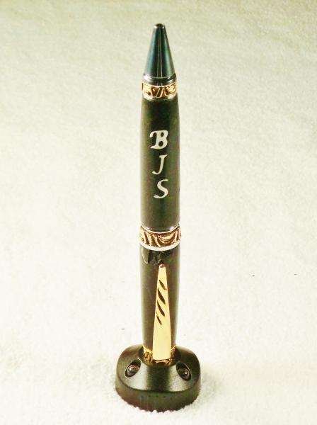

:bananen_smilies051: Just finished my flashlight/pen. Has 3 LEDs and a slip ring switch that turns it off and on. It's getting close to 1 AM, so it's a little to late to set up the camera equipment now, but I promice to post photos in the morning. Jim S
:bananen_smilies022: Here are the photos I promised. The pen is my desk pen that I have shown before, so I won't go into detail on it. The flashlight part of it is from a Tool Shop Precision 14 piece screwdriver set. It has a slip ring 3 contact switch that turns on the 3 LEDs when slid over the end of the pen. When you remove the lights, they do a second duty as a base for the pen. I believe in the K.I.S.S. theory !! Keep it simple stupid. Not the rocket science you may have expected, but the best I could come up with on short notice. Next I will mate the PSI flashlight kit with a twist pen kit and make a one piece Flashlight/pen combo. Give me a few days. Jim S

Hmmmm, I'm not overly sure that I could write with that and it seems a bit too small for a reading lamp....it would look cool on the desk though.:biggrin::smile:

Smitty; It's realy easy to write with, and I can do it in the dark. About the only thing I can do in the dark any more !! Jim S
