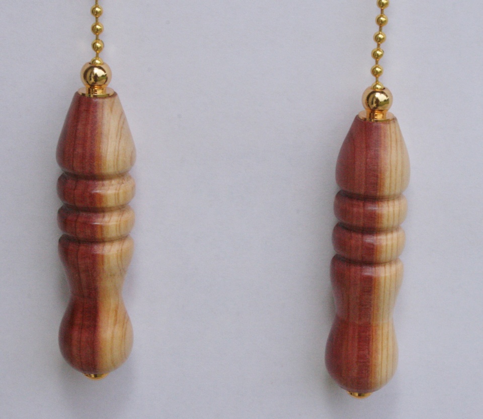

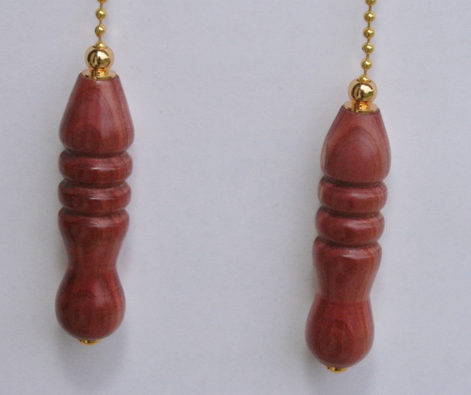

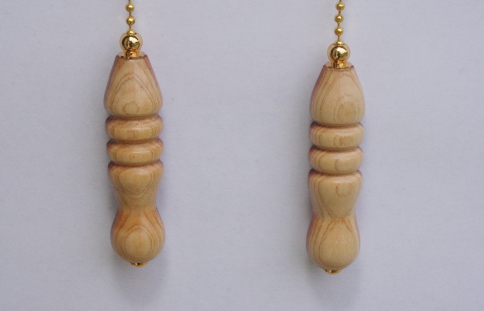

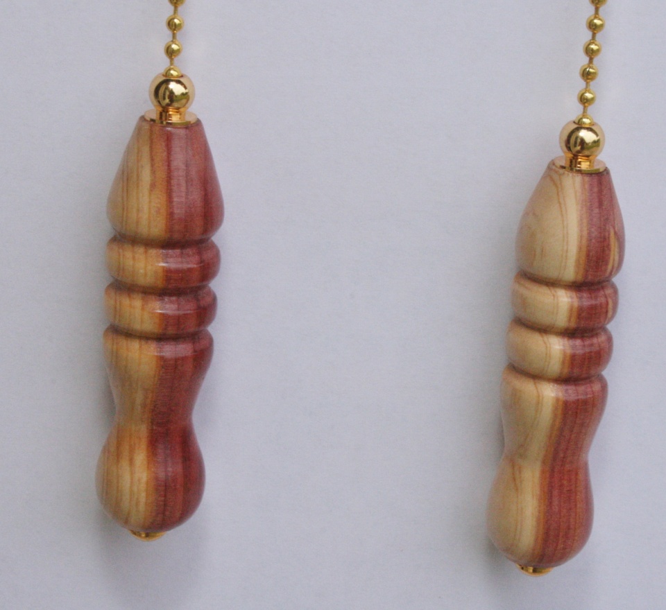

I forgot I had these kits...as they say out of sight out of mind. I had Evelyn pair them up with a box of blanks I had and she picked out the Red Cedar. I wasn't going to work on them today but I got a vision on how they should look so I went right to work...they are not an perfect match but I think they are very close. I finished them with 4 coats of Pens Plus. All C & C are welcome. Thanks for looking

Thanks so much for all the great comment's. Charlie red cedar does smell great. Warren so far I really like Pens Plus...I was having problems getting a good finish with the WTF I had and I not sure why. Mal the kits came from Craft Supply USA...I have then for well over a year.

Nice job on those pulls, Dan.
Red cedar is one of my favorite woods - nice aroma, turns & finishes easily and just looks so darn good!
