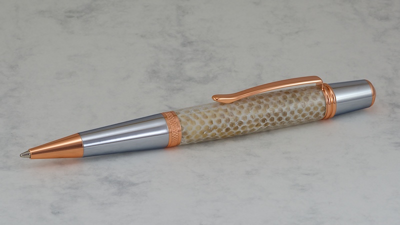

Here is a test image using these lights.
attachment.php
That looks very very nice .... that's the kind of results I'm going for with my little lightbox. :)
Thanks.
There is a bit of trial and error involved to get the lights positioned just right, and also getting the light diffused and spread across your scene to get rid of shadows and unwanted highlights which show as blownout sections on your pen.

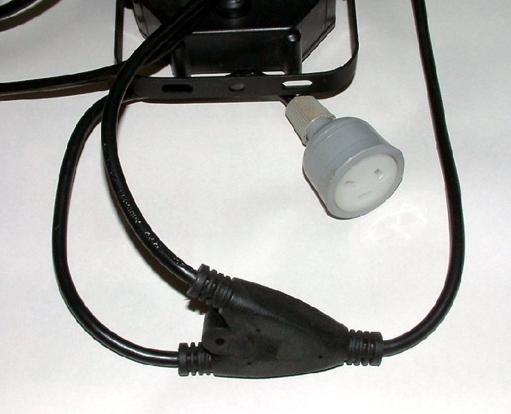

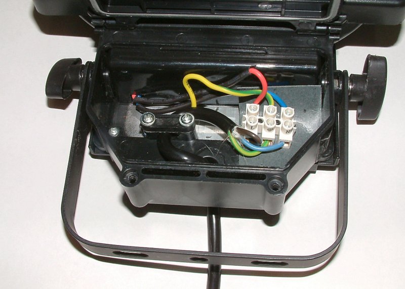

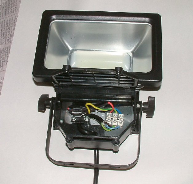

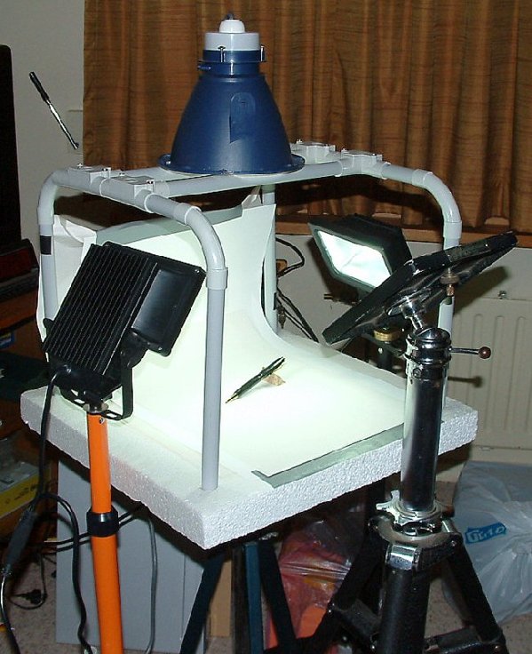

Recently I found as the large fluro curled bulbs I have been using for some time have aged I bought a worklight LED on tripod with two led fittings fairly shallow in thickness quite bright I rewired one branch that went to the 2nd light and put a 3 pin socket on it and fitted a new lead to the other one. The second light I fitted to a tripod. I will look for a pic of my open box set up.
Now these lamps are rated at 6500 kelvin but I find they gave a green cast , within my camera there are several white balance corrections have found difficulty so far correcting this within the camera. My solution will be to set the white balance on Auto again and expose to a true white surface up fairly close about half an arms length away.
THe led lamps like fluros give a light that seems to cycle a lot anyway when I get time I will report back on my findings so far 15 hrs of.
Food for thought.
