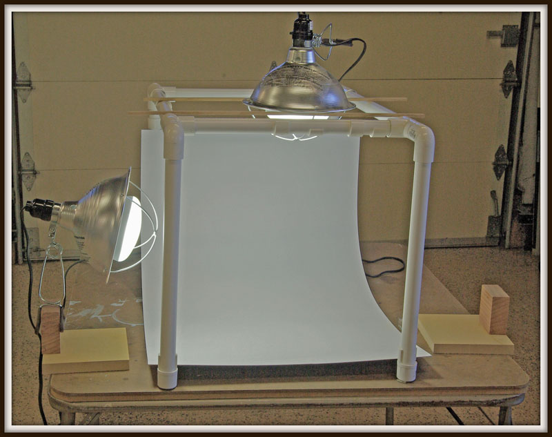

Here's a quick and easy DIY light box. Materials including lights cost ~$25 from the local hardware store. The legs nest and fold flat since they're not glued to the top rails. For a diffuser, I use about a yard of white cotton T-shirt material from Hobby Lobby (not shown). I use a standard sheet of matboard for the background and it seems to meet all of my needs.
Another option is to get an inexpensive white pull down window shade and mount it on the wall behind a table or shelf. When you want to do photography just pull the shall down over the table. When not in use retract it.

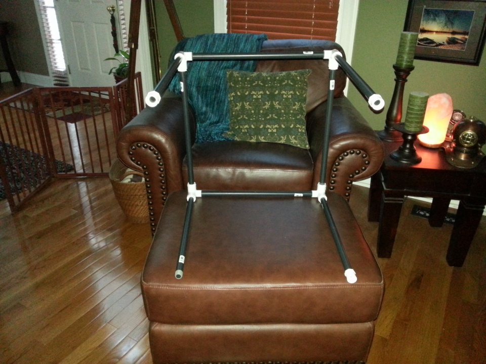

I am also done building mine. I used 18 inch threaded 1/2 inch sprinkler pvc and 3/4 by 1/2 fittings. I need more pipe and fittings, so I am going to HD now. I will take a picture when I am done. If anyone wants a parts list, let me know.
Now, I need t buy a decent camera. My digital broke and I am using iPhones and Androids. Maybe they will be good enough when using a light box.
Here's what I have so far.
B&H is "Mecca" for photographers, and you can find anything for photography there. Or you can make one yourself. Go to a fabric store, get a couple of yards of white nylon (not the ripstop nylon), make a frame, I've used 1/2 pvc pipe and fittings from the hardware store. drape the white nylon over the frame that you've made, and wa-la, light box. While your at the Home depot, pick up some daylight CFLs for a light source, cheaper there than a photography store. And if your really in a pinch, white bedding sheets (I've used that for reflectors)...your wife might not like it though.
