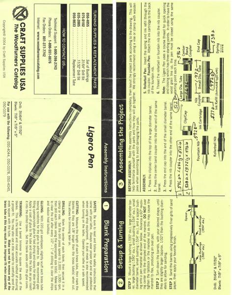

Does anyone have the assembly instructions for the Ligero rollerball by dayacom? I purchased the pens a while ago and can't find the instructions in my files. I did not find them on the site I purchased them from so does anyone have them in a word format? Thank you William

The ligero is practically the same as the El Grande and following the el grande instructions should suffice. You may find this interesting: El Grande vs Ligero
El Grande instructions should be available on the Berea website.

--- here you go --- complete with my hen scratches :)
