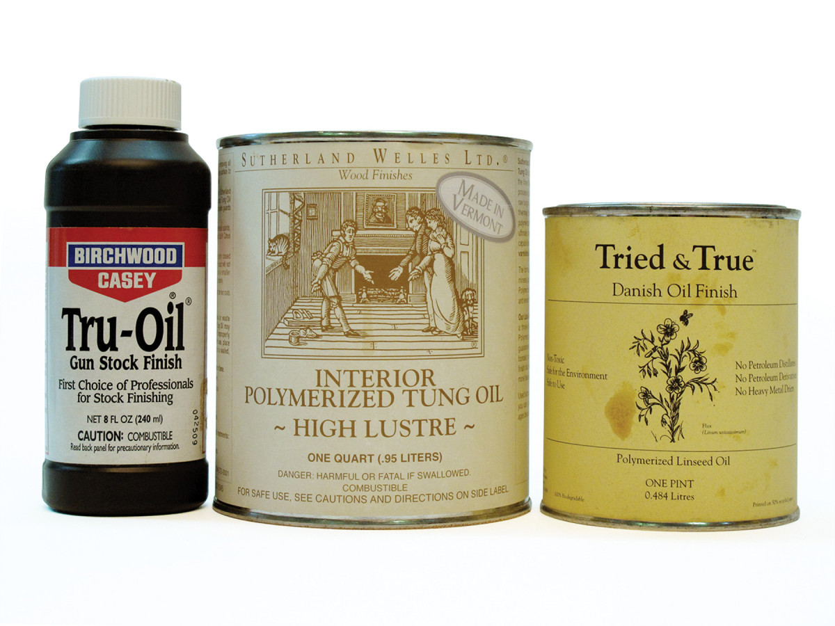

It took me a while to find this again, but this is from the author of the "Understanding Wood Finish", which I think is basically the bible of wood finish:
I have read through various parts of his book a number of times, and he warns the reader a lot about advertising of finishes, and how certain words are often used to make a finish seem more than it really is, etc. I didn't know that so many of the finishes we use, for all their different names and advertising, are really linseed oil, sometimes just linseed oil, maybe just with a bit of atmosphere exposure to "polymerize" them first (which isn't the same as the early polymerized oils, which were heated in a vacuum to cause carbon cross-linking). That aspect of the book was quite enlightening to me, and transformed the whole world of finishes for me.
The last part of this article was quite interesting, as he mentioned how the oil only finish on the pens was more durable than either a shellac or lacquer finish, because the oils polymerize. That goes against everything I've heard from pretty much everyone else, who seem to think oil is an insufficient pen finish that will simply get gooey or sticky with use. This is the guy who wrote the bible on wood finishes...I don't think there is anyone I trust more than him. Polymerization is a one-way process, though, so polymerized oils shouldn't reverse back into the individual compounds.
I gather that CA is hard. It's a plastic. There is certainly a durability advantage there, and I don't deny that. What I think frustrates me, is that there are a lot of pen turners who poo-poo any other finish as non-durable. Which I think is simply untrue...I wouldn't consider durability to be a bit, or a flag...it isn't like you have "durable" and everything else...its a spectrum. "How durable?" I used to use a shellac based friction polish for my earliest pens, but I've stopped, as after reading more on shellac, it DOES have a problem with reacting to human sweat and oils and it does break down. There are many other finishes besides shellac, though. Some of them, like Lacquer, Poly, or Pens Plus, and maybe even just a polymerized oil, can be not only durable (again, maybe not as durable as CA given it is literally a hard plastic, but I think durable for long enough to support the expected lifetime of the pen, to refer to some of the points made by Louie in the original post), but I think many can bring out the beauty of the wood better, without plasticizing it, enhancing the grain more (oils do a better job of that IMO!), and maybe as in the case of just a polymerized (properly polymerized, with carbon cross-linking) oil, giving you the best natural wood finish you can possibly get (i.e. no film finish on the surface).
Something else about CA that I've noticed, is that it can scratch much like any plastic. Over time those scratches will mount...so, even though it is hard, that doesn't necessarily make it invulnerable. I think there are a few spectrums of qualities of finish that need to be accounted for. There is durability, but also how the finish affects the look of the wood, and finally how the finish, durable or not, wears. I find that Pens Plus wears quite differently than CA. It doesn't seem to pick up scratches per se..but, I have found (on my most wear-experiencing piece, a little keyring that all my keys come into daily contact with) that it will eventually start picking up little dents and gouges. I have not, however, noticed the same kind of scratching that CE or acrylic keyrings picked up. IMO, the Pens Plus finished keyring still looks darn good, despite the wear...and, it's never gotten sticky or anything like that despite the kind of use it gets.
Durability, Wear, Look. It's a little cube. ;) The Finish Cube!

"The last part of this article was quite interesting, as he mentioned how the oil only finish on the pens was more durable than either a shellac or lacquer finish, because the oils polymerize."
You need to understand what he wrote. Shellac will "melt" in humid environments. Lacquer is not a great water resistant finish. That comparison against oils with those two finishes does not equate to CA or Tung Oil or Urushi or some Polyurethanes.
A second part to that is "Polymerize". Not all oils will do that in the context of a good finish.
Polymerization itself is not going to protect pens very long. Similarly to CA - One or two coats of thin CA applied with paper towel will have an estimated .001 thickness and it will not last long. Single coats or two of oil polymerizing will probably produce the same results. Now add several coats of polymerized Tung Oil or other over several weeks and you will have something, and one of the most water resistant finishes availalble. Urushi on the other hand will have the toughest finish and highest temperature resistance over both polymerized oils and CA.
The trade off is long curing times for effective finishes.
No one finish covers the whole gamut or spectrum as "best".
So what is the best practical temperature resistant finish bar none?
What is the best practical moisture resistant finish bar none?
What is the best practical Toughness finish bar none?
No one finish will do all of the above.

I believe he tested with properly polymerized oil, heated high heat in a vacuum, which causes carbon crosslinking. I don't believe he tested with just your average oils.
I agree that you will need to use multiple coats of any finish to get reasonable durability, and also agree that no one finish covers the whole gamut (or spectrum, as I called it). That's pretty much what I was saying in the prior post. I am not saying we need a single-coat finish...I've never expected that. I tend to spend a few days finishing with Pens Plus anyway (and find the time invested to be worth while), and at least personally, I am not averse to longer finish cure times if it produces a nice, aesthetically pleasing, and reasonably durable finish. I usually use multiple coats of a finish, sometimes buff, and take a lot of care not to touch my finishes until they have cured, etc. I think patience is a virtue in this hobby (or line of work, guess it depends.)
I've never used Urushi, although I did look it up. Sounds incredible. In looking around at Urushi, I also found some $9800 urushi lacquer painted fountain pens...hand painted, with exceptional detail, as far as I could tell. I'd give it a try, but it seems to be rather expensive, and potentially toxic (and I seem to be allergic to everything :p), so I'll probably pass for the time being. Would be interesting, though, to paint a pen...
