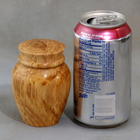

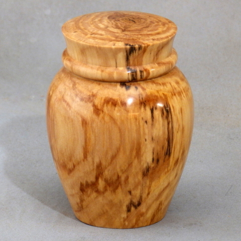

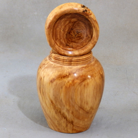

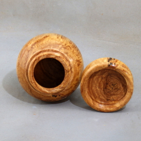

Here's one of my favorite recent pieces. This lidded jar is turned from mountain ash and stands around 4 inches tall. The lid on this one is threaded.

Nicely don, beautiful wood... the threads loot really well done.
I wish my lathe would go a little slower so I could chase threads.... I've done a couple, but t 450 slowest speed, it's really not conducive to doing it regularly.
To be fair, these threads aren't chased, they are cut with an EZ jig with the lathe running at about 25 rpm to drive the cutter. Mountain ash is too soft to chase threads in, even if I had mastered that, which I haven't.
