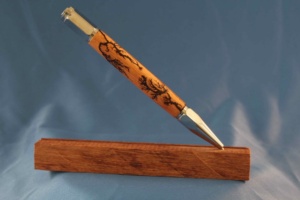

I used a Lichtenberg Figure Wood Burner on this pen. I turned it with the tube in but not glued in, zapped it, and then glued in the tube and finished it.

Super job on the pen!
I knew it was just a matter of time before someone else tried fractal burning on a pen!
Which transformer did you use? Neon, Microwave, or Oil Burner transformer?
I was nervous about building my own, so I bought mine from Conestoga Works. Carl Jacobson demonstrated it at our club meeting and I purchased it at the Oregon Symposium.
Yes, I forgot to mention that unit. It seems to work very well.
I just did a demo at a local club where I was one of three demonstrators. We showed a neon, two microwave and the Conestoga unit. It made for a very good demo....smoke & fire! The feedback was very positive!
I am a neon guy right now as it works for the turned items I want to burn.

The Conestoga Works Burner unit is 12,000V 35mA according th their website.
Thanks for all the positive comments. I am still learning how to use the burner. Still trying to figure out how much solution to use.
I used a blank from a flowering cherry tree. It was recently cut down, so I nuked it until it was stable. I used a baking soda solution as an electrolyte. I was told that baking soda would turn cherry red. It did not seem to change the color. I plan to try salt on the next ones.
I agree with your warning. Carl Jacobson said several people were killed because of carelessness with either the problems with their burner or lack of appropriate safety procedures. I like the "Dead man" switch the Conestoga kit has.
