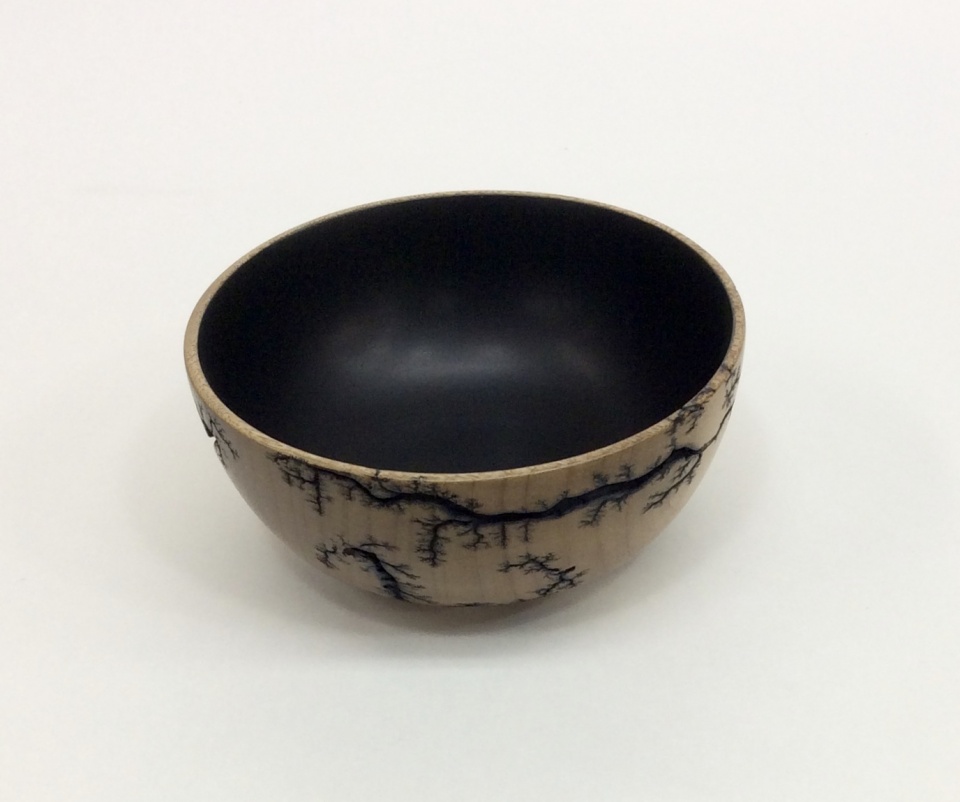

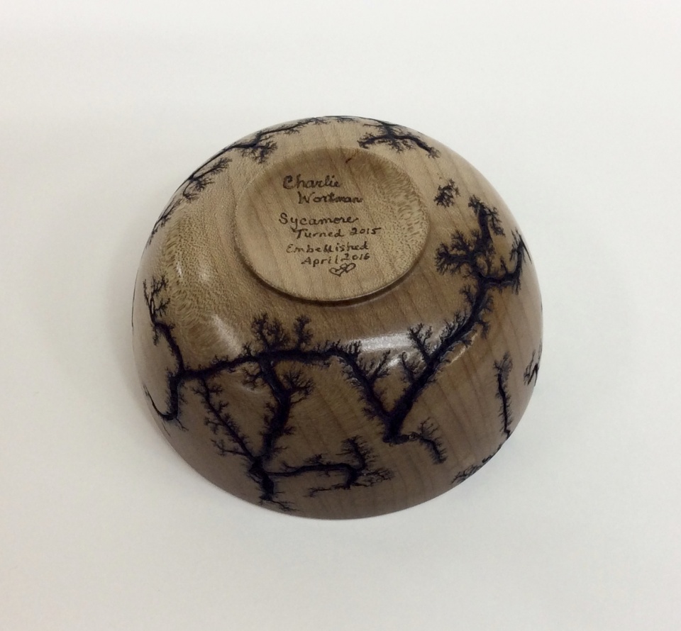

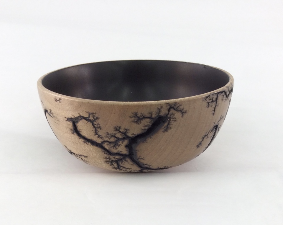

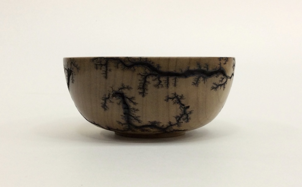

This is a small bowl i turned last year from a piece of plain jane sycamore. It was just lacking in character and needing some embellishment.
My recent delving in to Lichtenberg Fractal Figuring/burning has given me a way to really enhance some of my turnings.
I air brushed the inside with black Chestnut Stain followed by a coat of satin lacquer spray. The outside was also sprayed with the satin lacquer and then buffed.

Are you using a neon transformer or the microwave(rip it out and go for it) transformer?
Actually saw a video of this being done on YouTube, and while it looked really cool....electricity and me should stay separated by a few feet(I don't have the best of luck when 'playing' with it).
I like what you did there with the inside of the bowl to hide the burn 'lines' too...does the 'fill/paint' also keep the larger burn holes from showing through?

Scott, and Carl,.....not the microwave transformer.
I am hesitant to give too much info since one would be dealing with high voltage. I will say one needs to research the process, have some electrical knowledge and a bucket full of common sense.
The inside of this one was also hum drum and needed some class. If the main fractal lines are not allowed to burn too deep, you don't get any scorch through.
A little thicker wall thickness will help also.
