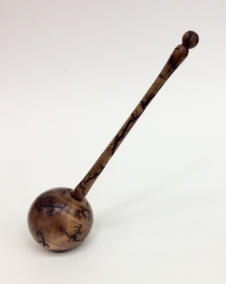

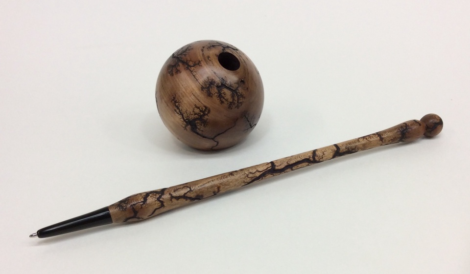

If you mean like is......my answer is yes.
This was my entry in one of the contests at MAPG 2016 earlier this year.
The pen and base are cherry with a black ebonite Nib. Finish is tung oil finish and buffed.

FWIW: Seeing the pen in person, it is a beautiful piece of artistry. The burning itself, but also the rest of the execution on the pen. Very unique and it was a pleasure to see it.

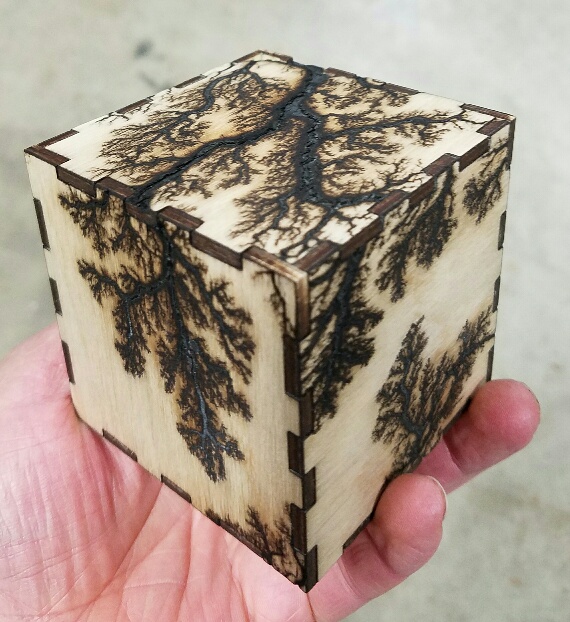

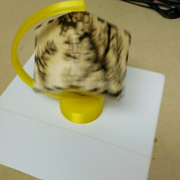

We do Lictenberg Burning at the MakerHive every now and then.
3D printed stand and a Laser cut box (sorry for the jerk motion)
