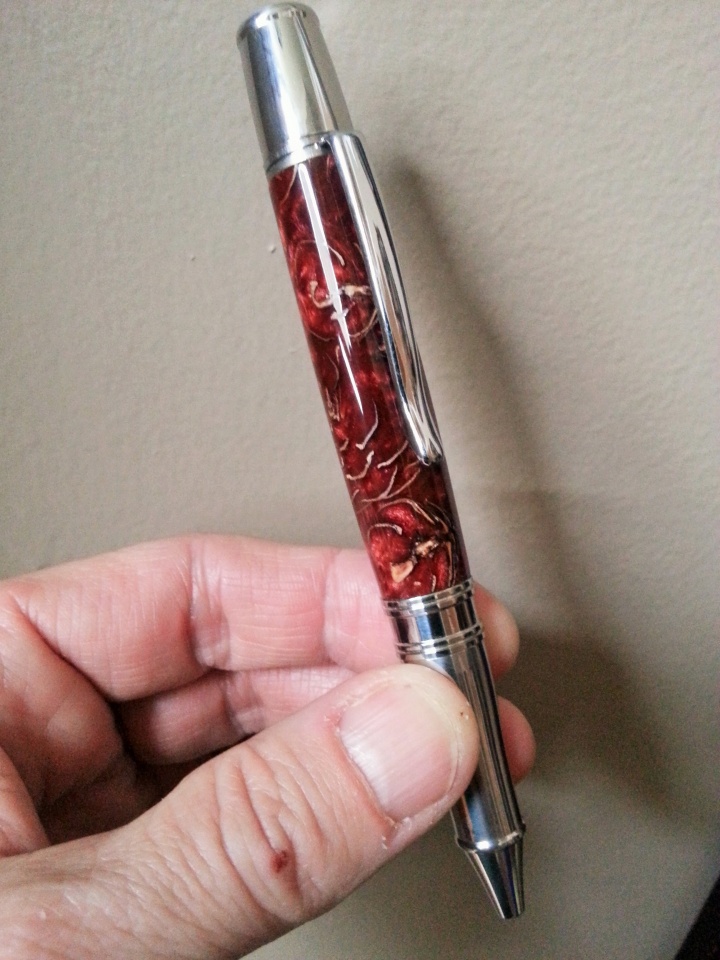

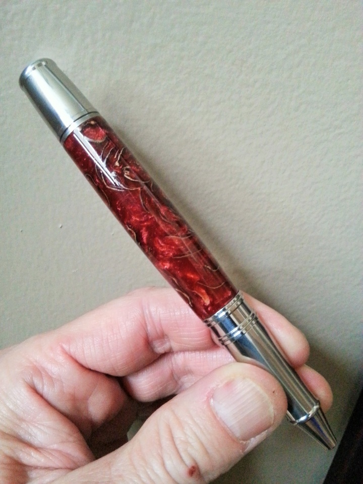

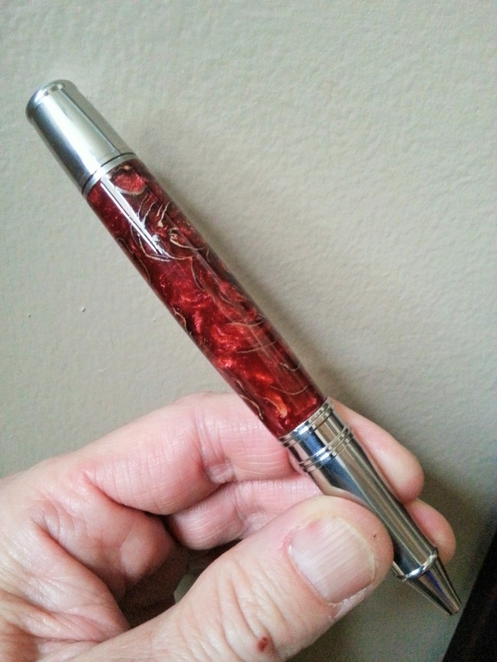

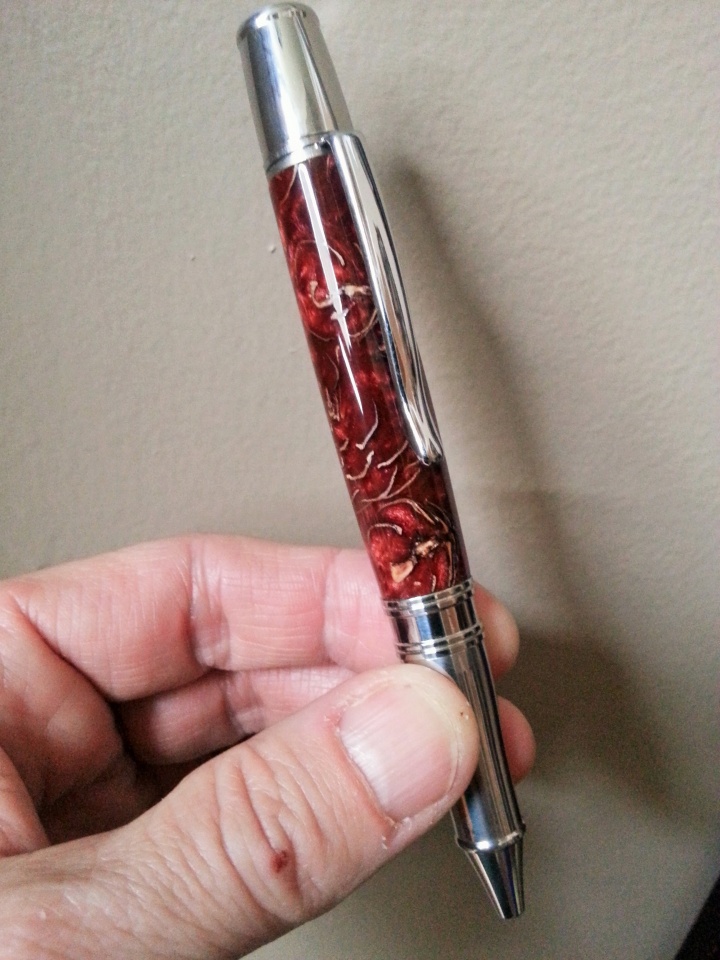

First time using a mixture of Plexiglas and acetone (thanks to thewishman).
We all know where the Liberty comes from.
Blank is from MarkD - red with hemlock acorns I think. I love his blanks.
No wet sanding. Abranet to 600, then Tripoli compound, white diamond, and two finer compounds from Caswell (6163, and 6165). Then Maguire's 105, 205 and Rejex. The 105 and 205 wasn't necessary. Rejex is just synthetic wax used to protect and slightly deepen the shine. All visible scratches were removed after the buffing (10 x magnification).
Applied 40 coats of plexi-tone in about 6 minutes. No accelerator.
Questions, comments, criticisms are all cheerfully welcomed.
Thank you all.
I have am too inexperienced with the finish to provide a fair appraisal of its durability, colorlessnes, etc. over time.
As far as the application/cost, I found it easier and more forgiving then CA in terms of:
Not getting things stuck together that you don't want to
Not needing accelerator (I understand that one doesn't need it for CA either)
It's very inexpensive (assuming it holds up)
Less sanding...no real ridges to speak of (again, can be overcome with CA too).
Time: you can apply 30 to 40 coats in less than 10 minutes (less than 5 once you get going).
I found getting a application consistency/viscosity less than half way between thin CA and medium CA to be one of the keys to it. The acetone has to evaporate quickly to allow for the next application of "plexi-tone". Too thick and that won't happen, too thin and you will just be applying acetone.
I think just like a CA finish, experience will serve as my best teacher and time will tell.
I am going to finish several all-wood pens over the next few days and see how it goes.
Thanks for the comments and questions.
