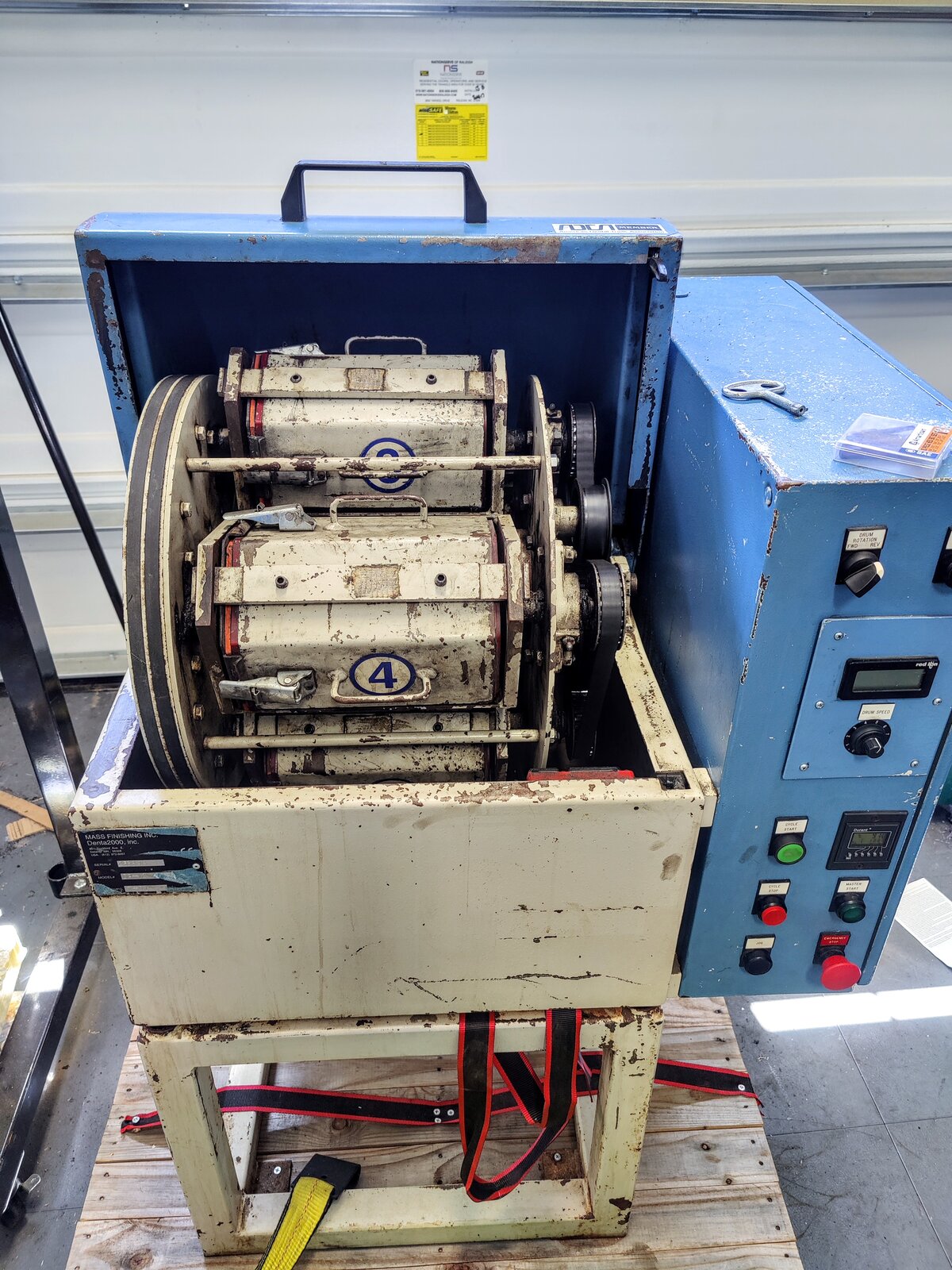

Fair enough! We'll announce the launch day ahead of time again. Just finished polishing up the clips with the new high energy finishing machine. Going to make things much much faster! Used one will get us through a few months and then we'll get a shiny new one that's a little bigger.
Interesting looking machine - kinda like a giant industrial version of the little rock tumbler I had growing up. Guessing the components go in the numbered drums with an abrasive compound, then the bins individually tumble while the big wheel spins the whole assembly, and the blue cover drops down because HOLY $#!+ someone left one of the drums open!
(or... something like that)
Blue cover drops down so you don't lose a hand as it's spinning at 250rpms or so. :) The drums have 3 solid clasps each and since you're tumbling wet you find out REALLY quick if you didn't latch them. It's a 3 step tumbling process which sucks from a having to keep up with media and swap things out standpoint but you make it up with the fact that you only need 20 minute run times. We did our first batch of clips in it over the weekend and I can already tell I'm really going to love its big brother when we grab that in a few months.
