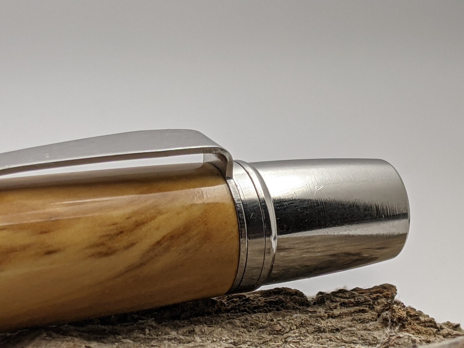

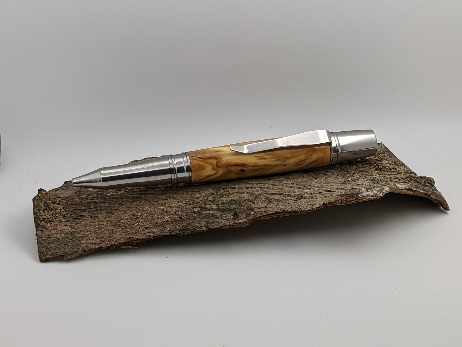

I managed to score three of these and a set of bushings when they went on sale a couple weeks ago - this one's dressed in a nice bit of slightly curly olive from @wood128 . I'm not sure how I feel about the pairing (although I love the wood, and it turned like a dream) - I'm wondering if I might've been happier with a darker wood.
I sort of expected someone else would get around to making and posting one of these kits before I did - I've been slow to make it into the shop lately.
This is the first time I've gotten a chance to make one of the LazerLinez/McKenzie stainless kits, so I don't really have a lot of grounds for comparison, but I like the kit a lot. It's got a really nice solid heft to it, I love the fact that everything screws together (or rather, the nib and transmission each screw into pressed-in bands, and the finial pops on the transmission), and the packaging is some of the slickest I've seen on a kit (not that it saved me from forgetting to install the clip the first time around - sometimes there's just no fixing stupid). The bushings are nice too - with machined-in stripes to identify front & rear, and 60° chamfers so they can be used between centers. Unfortunately the nib bushing was about a thou oversized and half a thou out of round (ok, now I'm just nitpicking), but a bit of sanding brought it back in line.
I feel like the finish, though, is a bit... uneven. To be fair, some aspects aren't entirely unexpected - Tim said up front that the finish on the new kits would show more machining than the old ones. It also sounds like the new machines may make things cleaner on future runs, so there's definitely nothing here that'll put me off buying more.

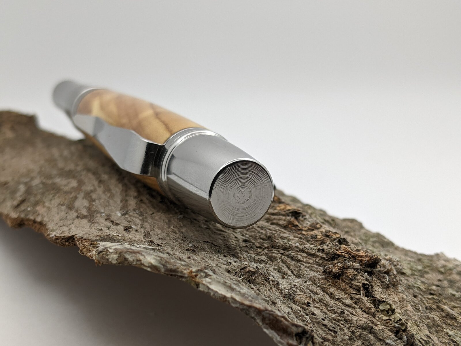

The finial looks nice - not quite a mirror finish, but very clean looking, with some visible but not entirely unattractive spiral machining marks on the top face (the picture shows marks on the sides too, but I have to really squint to see them without magnification).

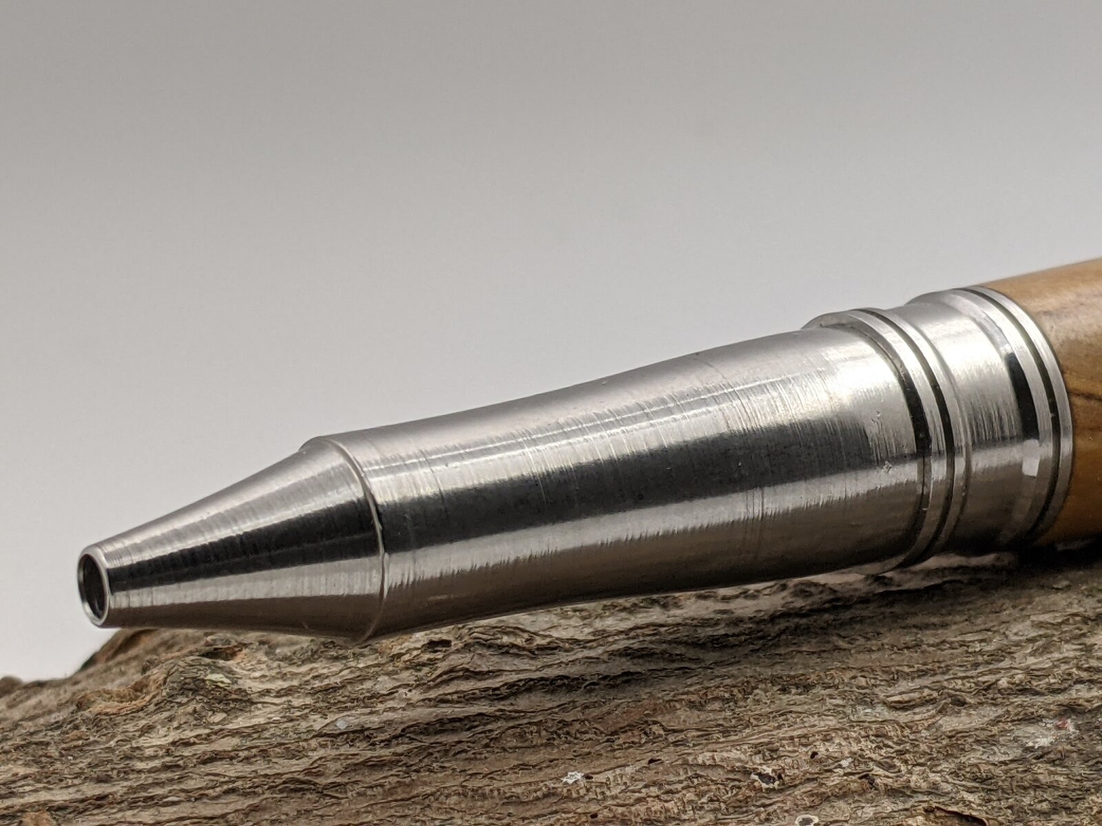

The nib seems to show a lot more marks, however (and I'm not entirely sure why, either). I don't think that would bother me by itself - it makes for a bit of a subtly industrial look - if it were a closer match with the finial. Instead it looks just a little bit mismatched. I may put the nib on the lathe and polish it up a bit more (did I mention how much I like the screw-it-togetheryness? I can take the nib off without punches! yay!), but I haven't quite decided yet. Again, I kinda like the sorta brushed industrial look - I just wish it were more even from nib to finial.

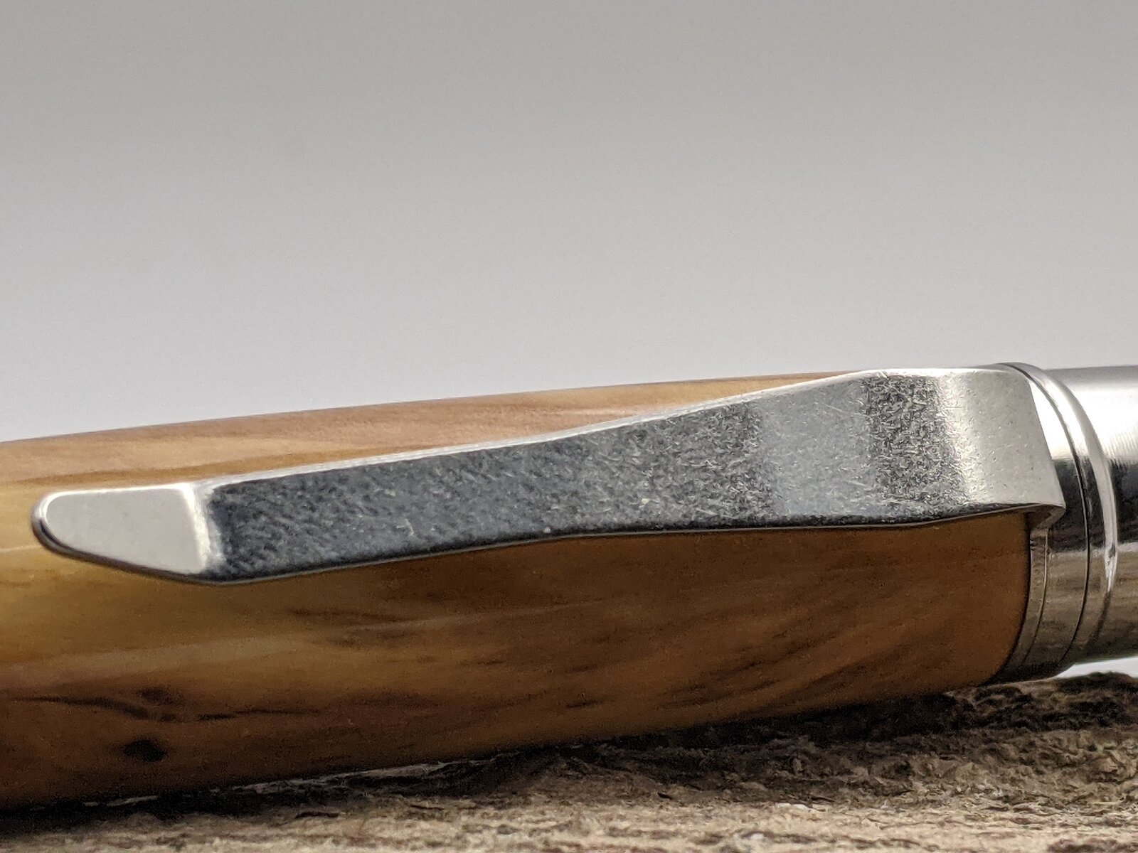

The one point where the finish really does sort of disappoint me is on the clip. It looks sorta like it's been banging around in a pocket with keys and change for a bit too long - although, like the finial, the photo shows a lot more than is normally visible. Like the nib, I'm still thinking of trying to give this a bit of a polish... or I might see if a wire brush can give me a brushed finish.
Minor gripes aside (and I really don't want to be too hard on it, since I know I'm kinda guinea pigging the first batch), it's really a nice bit of hardware, and I'm glad @McKenzie Penworks was able to bring them back. Thanks, Tim!

I like the machining marks and dimpling on the clip. I think it gives the pen a very unique look, compared to all the pristine, glistening shiny smooth kits that are out there. Truly beautiful pen. I think the olive wood was an excellent match!

The first shot is probably the most accurate in that respect - the marks on the nib and front band are definitely visible from a foot or two away, while the marks on the sides of the finial are almost impossible to see unless you're looking really closely with just the right lighting. You can see a similar looking finish on the test pen Tim posted over here.
