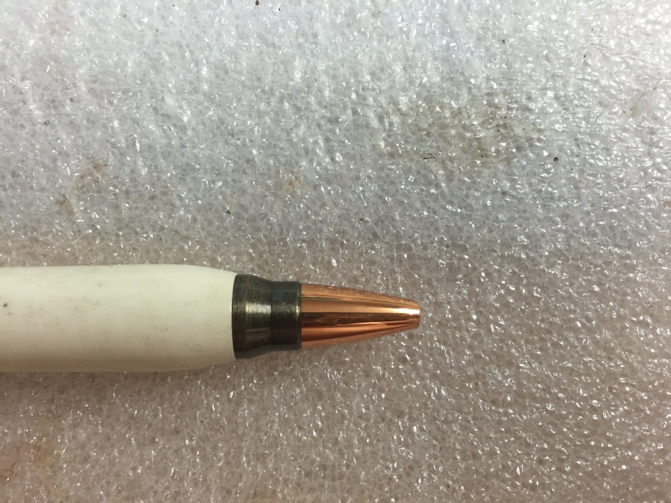

I messed up a tip on a lever action style pen. I tried a couple ways to remove it but did not have any luck. Any suggestions or tips are appreciated. Im trying to remove just the gold tip.

Hi David,
I have PSI disassembly kit and it comes with many diff. size rods. I use the size that fits in the opposite end of the tip but still larger that the dia. of the tip I am trying to remove and use a hammer to bang it off. Sounds complicated but it is very easy and works for me with no damage to parts. Hope this helped. Good luck.
SteveG
Dec 21, 2009
2,989
Eugene, Oregon 97404
Jallan describes a good method, one most commonly used. When doing this, the "banging" is best done with many light blows, rather than a single "knock out punch". I do it by just holding the barrel in my hand. This helps to keep everything under control, and avoid causing damage. Most penturners have a set of center punches (source: HF or all pen parts vendors) for this purpose.

I assume you mean you have to remove the brass "bullet tip" since it's cracked. You'll have to remove the fitting and brass tip with a punch as described above, then you'll probably have to get a board , drill out a hole large enough to let the bullet tip pass through but countersunk to fit the fitting (to hold it) then tap out the bullet tip with a punch. It should come off relatively easy due to the crack.

Update: I managed to go by HF today and pick up some center punches. Tried it and it came out no problem. I had tried using a screw driver and an Allen wrench with no success. I was nervous about the punches working. I held the blank by hand. Thanks for the help again!
