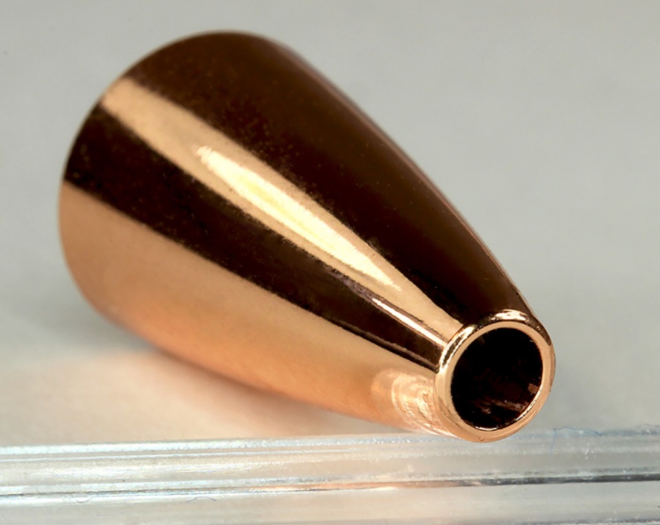

I hesitate to post this, because it is VERY DIFFICULT to see.
My current working hypothesis is that there is "crud" on the inside of the nib. A very, very, very small spot, but the nib of the refill can hit it and it won't progress beyond that point.
We are trying to get a picture. Meanwhile if you have kits that don't work, inspect the inside of the nib, using a magnifier (10 x or greater) and an intense light. The "small blob" is clear (see through, no color)
If you KNOW you can't see well, and you have a pen that is not operating properly, take a small punch and run it through the nib several times, then see if your pen works. I think it will.
As I said, this is my current "working hypothesis". I am open to it being dis-proven or to other "working hypotheses". Bring em on, guys!!
THANKS
ed4copies
Local Chapter Manager
Mar 25, 2005
24,529
Racine, WI, USA.

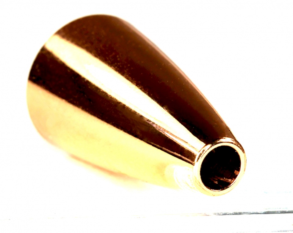

Here are a couple pictures.
Looks like scratches on the lower right of nib--I think it is a blob of crud. This is interfering with the refill movement.
Additionally, I would remove the blob of wax(?) that is on the nib. That blob makes the clearance VERY tight. The spring is also directional, when it is on the refill correctly, it goes up to and touches, the large shoulder on the nib.
When all those things are right, I think the pen will work fine. Meanwhile, replacing the click mechanism MAY work, if you end up positioning your refill "just right". But I do NOT think the clicker is the source of the problems.
All opinions to the contrary are welcome----supporting evidence is greatly appreciated.

Hi Ed,
I had the same problem also and I just took a very small rounded file and went around the inside of the small hole in the nib very lightly and it worked fine after that. Hope that helps.

Hi Ed,
I BELIEVE this will turn out to be the perfect solution. Waiting for more "bad" ones so we can confirm or destroy my hypothesis.
If you use a file, take care to apply pressure only when going "into" the nib. That way you should not disturb the plating on the end of the nib.
