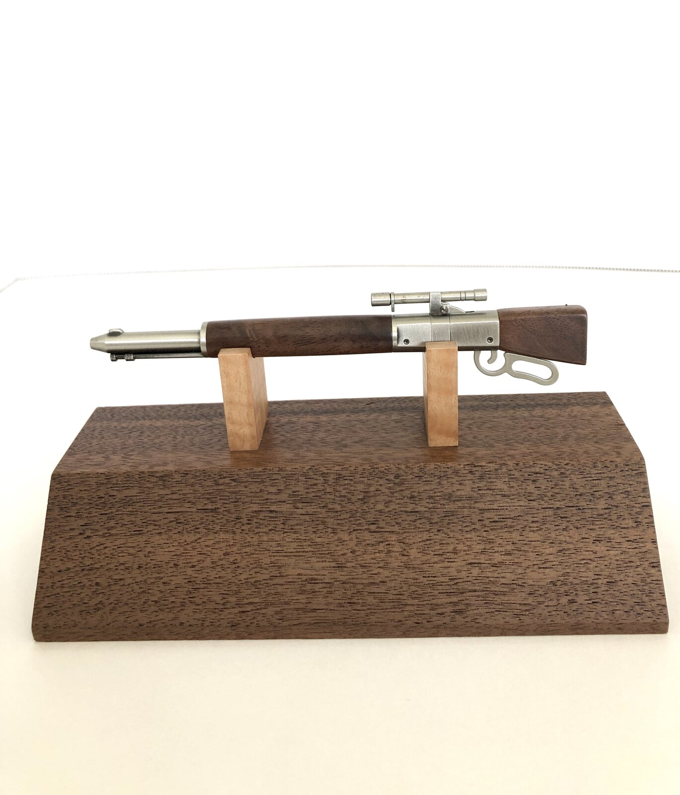

This Lever Action Rifle pen was made for a customer who is giving it as a gift to a special friend. The wood pen parts are walnut. The display base is walnut with curly maple supports. The customer will add an engraved brass plate. Finish on all wood parts is MinWax Polycrylic Satin spray. This is the first lever action click pen I made.

I like this pen can you advise me if this is only available in the USA,as I haven't seen any similar to these in the uk??
It's a PSI kit. I don't know if any UK distributors sell them, you'd have to check. I would imagine you could order them from PSI, but shipping would probably be expensive.

That's really nice! Did you make the tailstock?
Yes, I made the tail stock. On the first attempts I kept getting the thickness undersized. I did preliminary shaping before cutting off the stock from a larger piece of wood. A hole must be drilled into the tail stock to receive a brass insert for attaching the stock. Precision in locating the hole and aligning the drill bit perpendicular to the end of the stock is critical for proper fit up. It was a challenge to make but I learned how to do better on the next one. Instructions from the Penn State web site give more details on making the stock than the instructions included with the kit.
