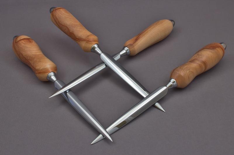

I made these as part of a custom order for St. Peter's Church in Philadelphia. Their 250 year old Horse Chestnut tree was taken down last year and I was lucky enough to work with the arborist as it came down, picking some of the better pieces of wood.
After drying it, the spalting really started to show nicely. I stabilized all of these with cactus juice and used tung oil to finish them. I tested my skill using calipers and while I found them good for this particular project, I think I would have too much trouble using them with a finish like CA where there is so much more build up. My hats off to those who do :)
As always, thanks for looking.

Yeh, me too. Quite often it is the "story" that makes a beautiful object irresistable.
I entered a natural edge bowl in a show and it sat unsold for 4 days, then I decided to put the "story" next to the piece and it sold in 20 minutes.
Great work. Thanks for showing.
Bob.
Those are really cool. I don't know how everyone else uses their calipers to get an exact fit with a CA finish but I have just started doing it and I turned the blank slightly undersized and applied plenty of CA, making the blank 1-2 thousands oversize. I then adjusted the fit by sanding down the thickness of the CA checking it with calipers, because I had turned the blank undersized I knew I wouldn't sand through the CA.
