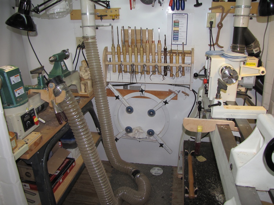

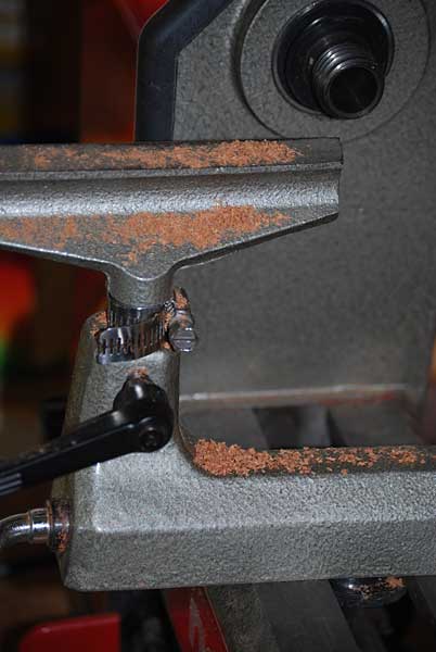

I have a ceiling hung JET Air room filter, and a Jet Canister/cyclone unit placed between two lathes.
The Jet mini has a filter hose mounted under the bed. The nova has a back jury-rigged dust filter hose. I have a simple port with 2 hoses that I use a blast gate pipe section to open and close the hose to whatever lathe is needed.
I have been very pleased with this setup, with my only regret was the next higher Cyclone unit - more suction - since I have two hoses sections, there must be some small leakage, and the better motor would have given a stronger overall suction. But $$$...

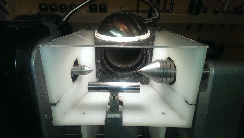

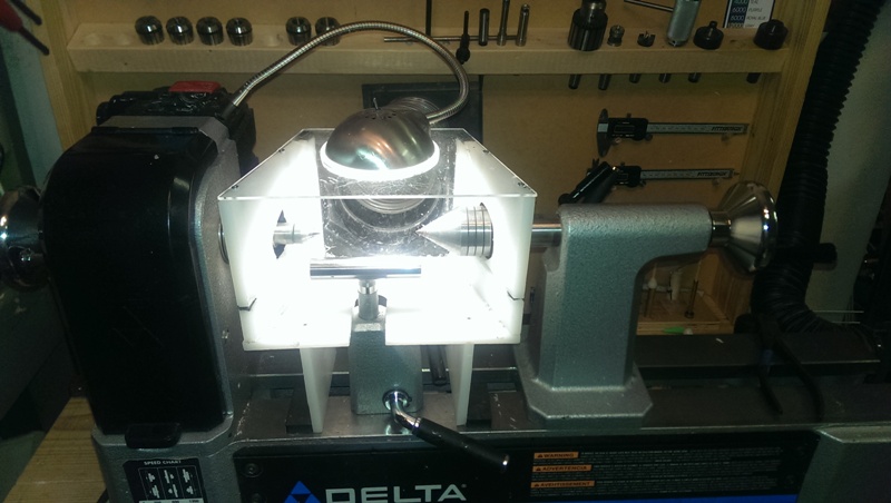

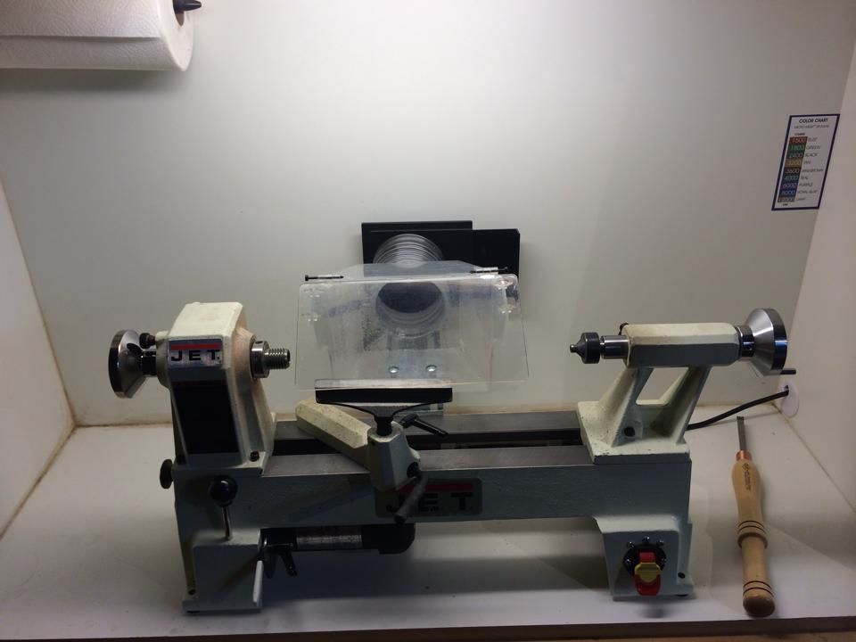

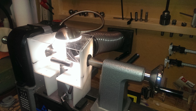

I started with Curtis's design:
http://www.penturners.org/forum/f30/darn-near-perfect-penturning-lathe-dust-collection-52714/
Then perfected it...:wink:
Tapered box funnels airflow to outlet, poly cutting board material reflects light, is lite weight and stays clean, The top is cut at a angle to give me clearance when I remove it and held in position by small strips of velcro - the bottom can be used alone. I can bring my light right down on top of the plexi which give great visibility. Strong magnets hold the box in place. Air is ducted out the back to a quick connect airgate and then through the back wall of my bench. I made a larger box to use with my collet/mandrel when required.

Does it get a good bit of the dust when you sand?
Its fine for the medium/fine stuff, but as I said - not powerful enough to really get the larger stuff. Its more like a current drawing stuff down. Acrylic/Alumilite will get pulled down easily to clog the grate, but heavy wood will not be sucked in.

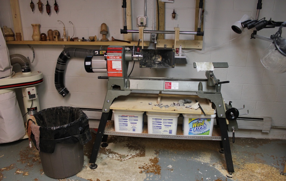

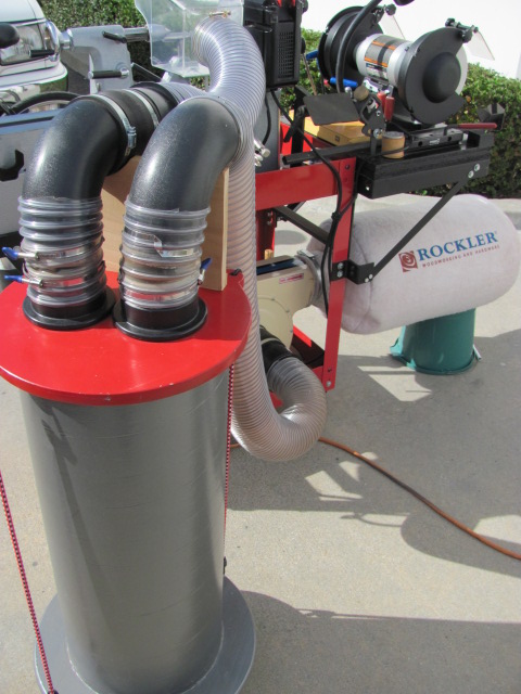

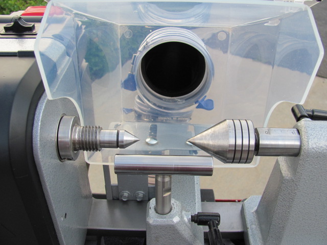

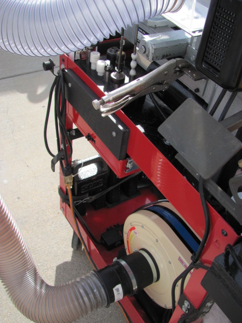

I started with my store-bought clear hood from Rockler,that has the hinged lid.I mounted a piece of angle iron on the back of my 46-460 lathe,using the existing tapped holes.I had to weld/modify the existing stock hood bracket to make it work,but now can snap it on and off with a simple vice-grip.
I was going to make it a magnetic mount,but never got around to it,and the vice-grip works slick.
I mounted my blower under the lathe,using 5 chainsaw handle anti-vibe mounts,so the vac shakes but you can't feel it on the cart.The bag was getting plugged up too fast,so I homemade a separater on wheels,with quick connnect fittings for super fast set up.That took away some of the suction but it outweighs the bag plugging up problem.
When ca/accelerator fumes contact the clear hood it discolors it fast.So I have an old cruddy one with it's own cruddy looking hose that when doing ca,I'll switch hoods,and take the bag off since it's just pulling fumes away.That works real good.I do it outside,so make sure the wind is on my back,too.
i think I've posted pics here before,so I apoligize if it's a repeat.If not,then here's a couple.
Steve

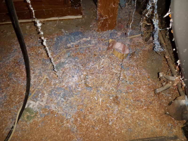

I might have the best collection yet shown...
It includes acrylics, stabilized, aluminum, burl, exotic and just plain old wood.

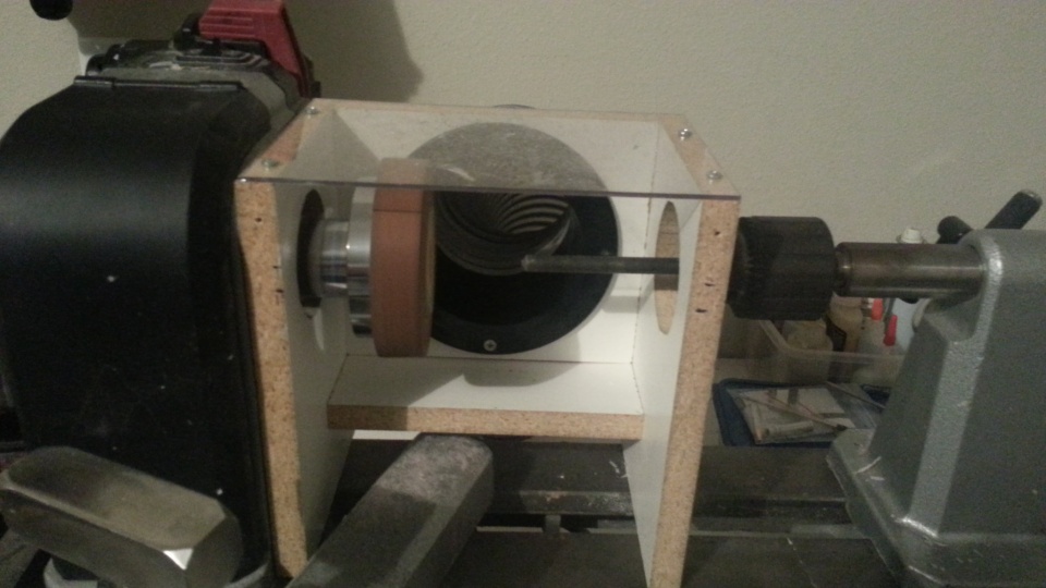

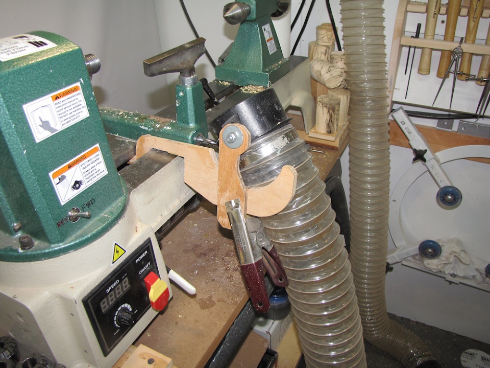

Thanks to Dan for starting this thread! I got some pretty good ideas, and with an hour of piddling around, an $8 cutting board from Sam's, some scrap oak and an old reactor shield from the lab that we don't use anymore, I ended up with this:
I'll do a little turning tomorrow evening hopefully to try it out. At only 330 cfm, I doubt my DC will pick up many of the chips, but hopefully it will keep the fine stuff out of my respiratory system. Thanks for all of the ideas y'all!
Edit: I may be making some revisions now that I'm looking at the picture! I shouldn't have had my 2 year old "helping" while I was in the design process!!

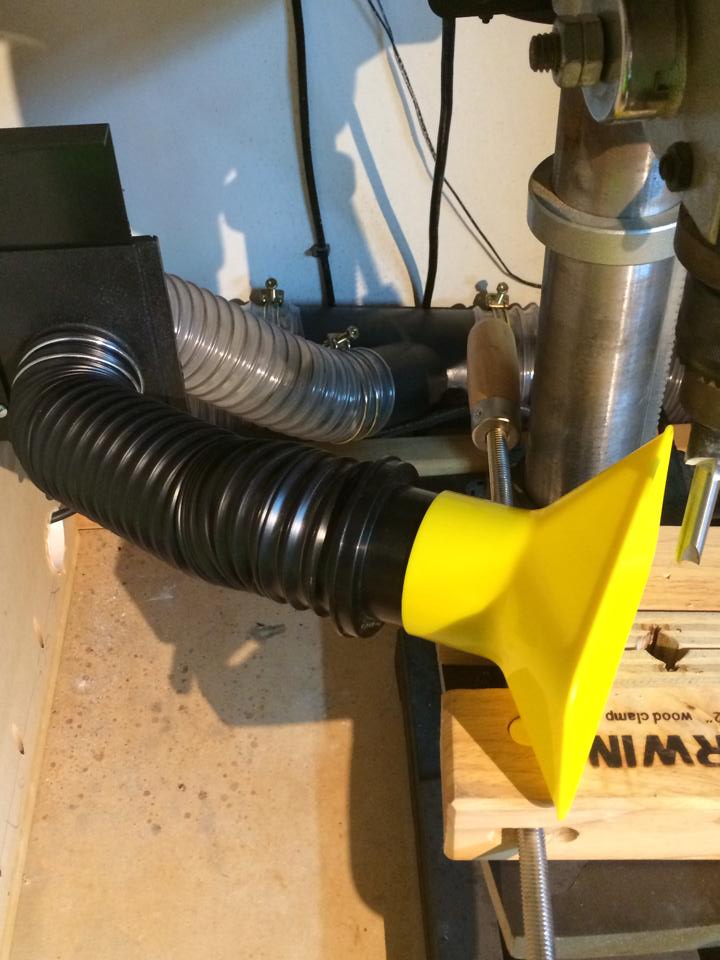

I picked up the PSI lathe hood a while back and tried it with my Shop-Vac. With a 4" to 2 1/2" adapter on the Shop-Vac it was horrible. Picked up a Jet DC1100VX-CK at 15% off and have been working on getting things set up.
I have one 4" duct running to the lathe with a blast gate, coupler, and a short piece of hose running to the hood. I have an elbow on the back side of the wall that is coupled to flex hose.
To collect the mess at the drill press I ran a 4" x 4" x 2 1/2" Y fitting at the drill press with a 2 1/2" blast gate and 2 1/2" rigid flex hose with hood.
Overall I'm happy with the PSI hood. My only complaint is that the tailstock locking lever hits the hood when I move the tailstock.

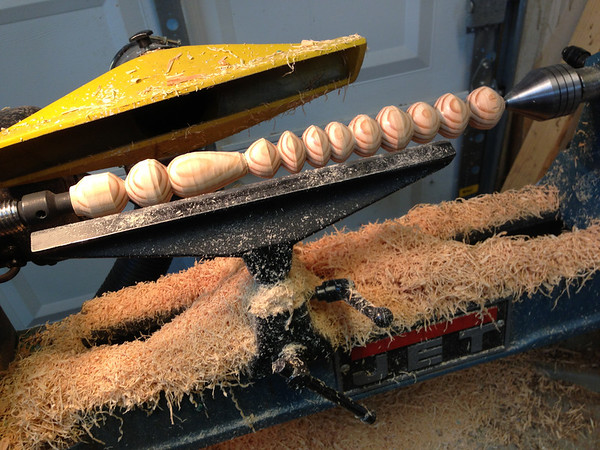

I have this behind my lathe:
It doesn't work so well for chips and other cruft, but I didn't get a dust collector for that. It does work wonders for dust. I've seen dust float up and into the intake, even when power sanding bowls. I think I got it from Grizzly, but it's been so long I don't rightly remember anymore.
