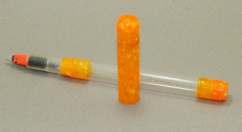

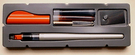

Since you asked, here is one that I just finished.
The task was to take a Pilot Parallel - a weird looking pen - and turn a pen of "normal" size and shape. The chap posting the challenge wanted a clear barrel, an eye dropper filler and a postable cap.
The stock section on this pen is threaded 10M x .75, and I needed to keep it. So, I tapped the new barrel to match that. The cap is tapped using the multi-start tap and the barrel is threaded with the matching die to take the cap. Finally, the end of the barrel is threaded so that the cap can be posted.
I'm attaching a pic of the stock pen and the most recent attempt of mine.

Texatdurango
Apr 23, 2007
4,649
Show Low, Arizona
Dan, that is exactly the way it is done. I think it's Richard Binder that has the tooling to re-shring bands to fit caps that have shrunk. This is a big problem with old pens, some more so than others. I do not think a collet chuck will grip it evenly enough to be honest.
Sorry for the late response, I've been on the road the past month, but in my opinion, the collet chucks do a fine job of swedging the metal bands, at least the sterling silver ones I have done. Will they stay nice and tight for another 20 years? I don't know yet but they have at least stayed tight for several months.
The penmaker who told me how to do it has been swedging rings for several years on his pens and if there was a problem with bands coming loose, he would have mentioned it. He also uses collet chucks.
Just something to consider.
