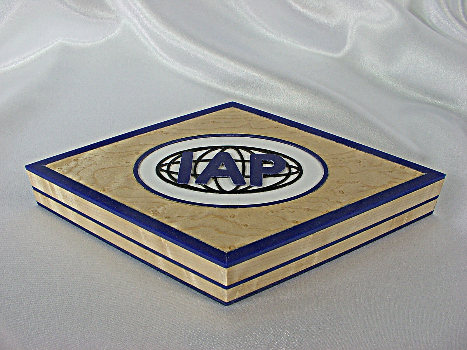

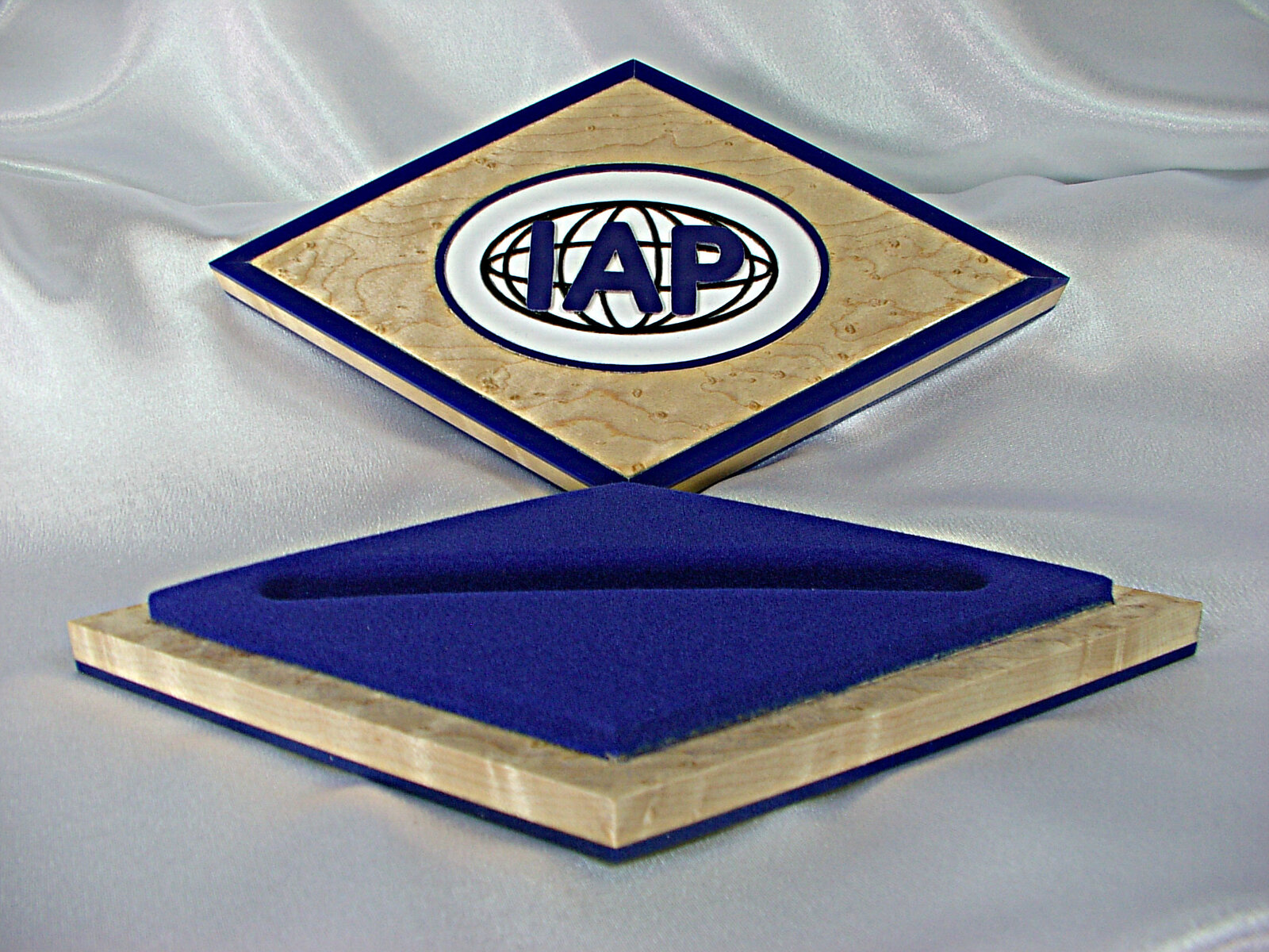

So I am looking for suggestions and or tips if you have done this. Here is an example of my flocking on a pen box I made a few years ago for a Bash contest.
For my last flocking method I used Modge Podge as the adhesive. I painted the box first in a matching color and let it dry. Applied Modge Podge and then the flocking material. Turned out well. Not sure the drying time on Modge Podge, but it dries clear so I was able to put on a little thicker. There are YouTube videos on this method.

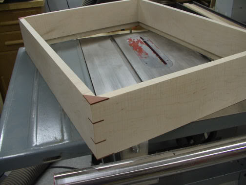

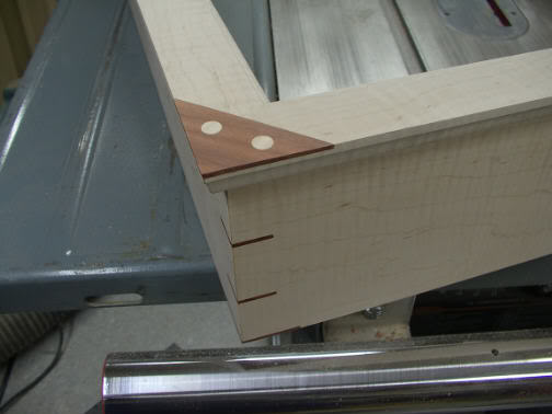

Here is a old photo or 2 of the cabinet somewhat.
