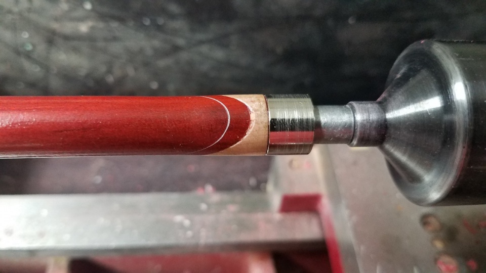

This is my first attempt at a segmented pen using metal (aluminum from a beer can).

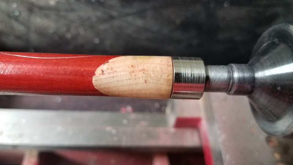

I was making this as a gift, and thought it would be neat to have a segment near the tip of curly maple. I cut it so that the end-grain would show, not realizing that I would get tearout near the thin transition sections.
I tried to repair using wood dust mixed with glue, but was unhappy with the result. The wood also had some coloration that made it look "dirty".

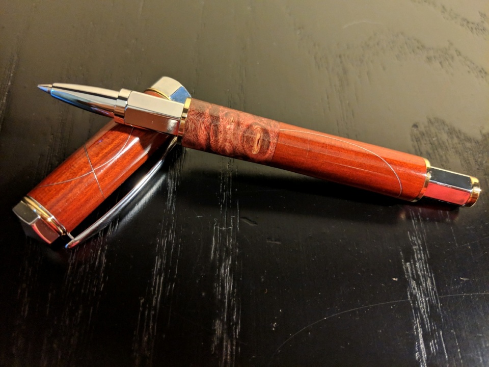

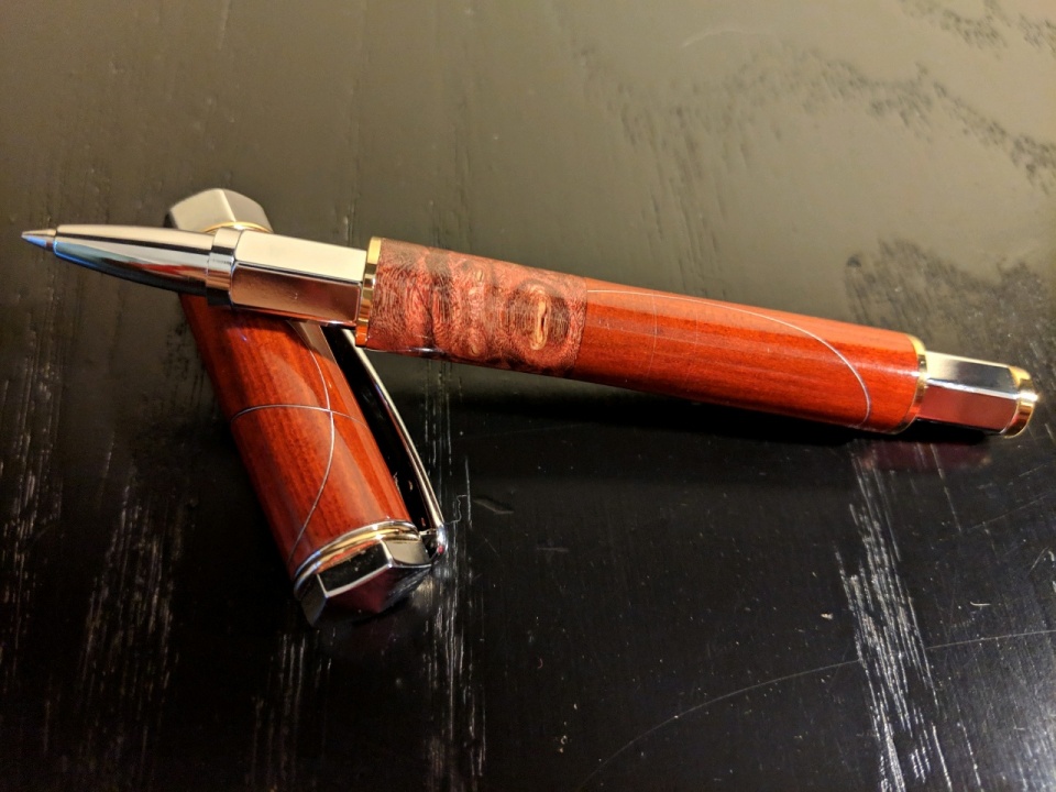

I ended up cutting that section off and adding a segment of red burl.
Overall, I think the end result turned out nice and I'm sure they'll be happy to receive as a free pen.

Yup. You've got a knife edge with wood without a solid grain structure. Next time you do that, don't try to turn it down so far, but go with some coarse sandpaper to take it to the final diameter.
-gary
The tried and true "80 grit gouge." :biggrin:
No disrespect to the others on the use of sandpaper, but with metal/wood, I do not use sandpaper at all.
The dirty end that you mentioned . . .
That "dirty look" is sanded metal deposits on the wood. Sandpaper does that.
Look at this photo: http://www.penturners.org/photos/images/940/1_30_Pieces_of_Silver.jpg
Brass, aluminum (and the sliver dots in the photo) SMEAR with sanding. Some people accept a minuscule amount of sanding dust but I could not. Those two pens were turned smooth as a baby's cheek with a well sharpened scraper, NO sandpaper. Sandpaper smears metal sanding dust into the wood.
The key is a freshly sharpened (not "good enough" but the "best"; Good enough is the enemy of Best) and using it for about 20 to 30 seconds, swipe it on a hone and turn 20 - 30 seconds, swipe again, and so on. I use HSS which dulls quicker than carbide inserts but I can sharpen HSS better than the best of carbide inserts. Metal and wood is a case of using the sharpest of the sharp, and HSS give it. Learning to sharpen HSS like that is a good experience that brings on a great feeling. I use carbide inserts often, but when it comes to the final sizing, I turn to HSS, even on metal and wood segments/laminates.
