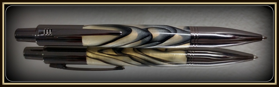

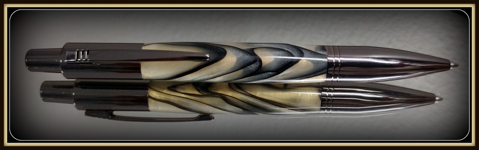

I've been turning pens now for about 6 months and though I've been lucky so far I still forget to consider painting my tubes. The Stardust Trails Acrylic blank is described as "black swirled through a pearly gold and platinum colored resin". Though it turned out close to this description, the brass tube is more noticeable than I'd prefer. I'm just not sure what color would have been best to paint the tube - perhaps silver?
Comments and suggestions would be appreciated.
BTW - Vesper Click Pen Kit in Gun Metal

I believe that coloring the epoxy or painting the inside of the blank would have been a netter idea. That is one of the problems looking through a blank when you turn it as thin as that appears.
Another idea is to make a paint stick with the main colors you would like to paint with. Then at least you could insert the stick and "see" if a certain color looks better then another. (I got that little trick off of Exotic Blanks and the "how to" videos)
Other then the 'tube' problem......That is one fine looking pen.
Very nice. I really like this kit. I use a spray gray primer a lot for blanks that I don't know what color to use. Thanks for sharing.
Rod

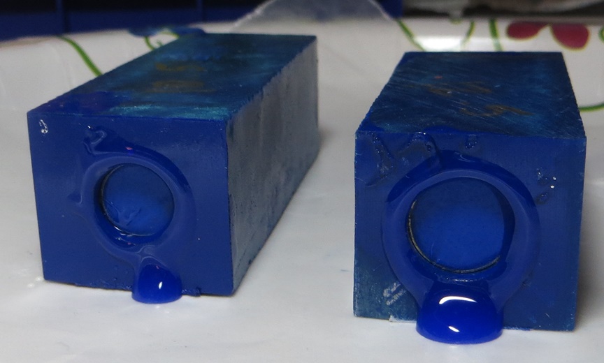

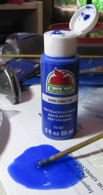

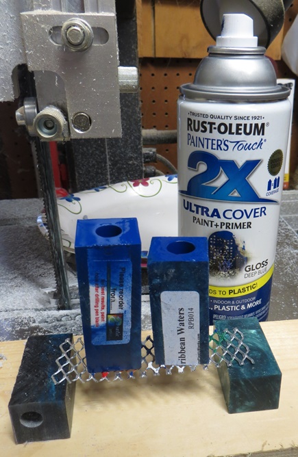

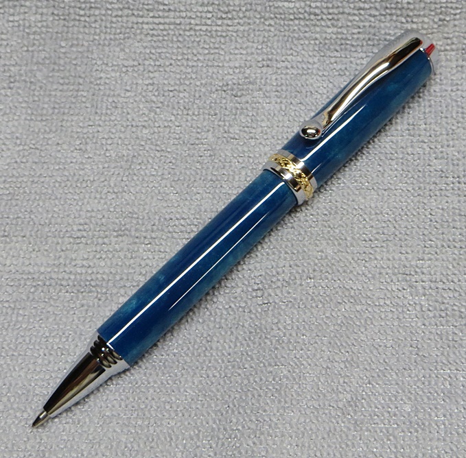

Colored epoxy can work well and can fail.
Uneven positioning of the tube, bubbles, or gaps in the epoxy coverage can result in shadows or visible tube.
None of the " hide the tube " techniques are foolproof, but they seem to have less failures with,experience.
I've found for me, the best method of all, for very translucent blanks, are a combination of painting the blanks and tubes, and coloring the epoxy.
