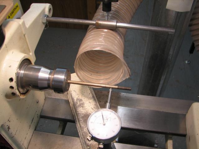

I make my own bushings and don't yet have all the sizes so I still use a "short" mandrel and it still works well. I do however "tune" it up every time with this.....
It's just a dial indicator mounted on a post that fits in my banjo. I just tap it lightly until it's straight. I can get it under .001" in about a minute.

Rick's suggestion is GREAT.
If you don't have such a setup, run the lathe with the mandrel positioned and held as usual by the tailstock.
Take a sharpie and bring it over the toolrest until it JUST contacts the mandrel. That mark tells you which part of the mandrel is "High", tap it, repeat above.
When the mandrel is straight, your line will go all the way around the rod.
