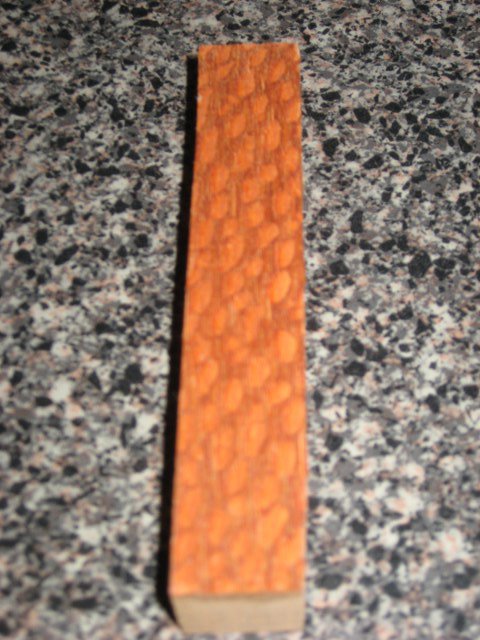

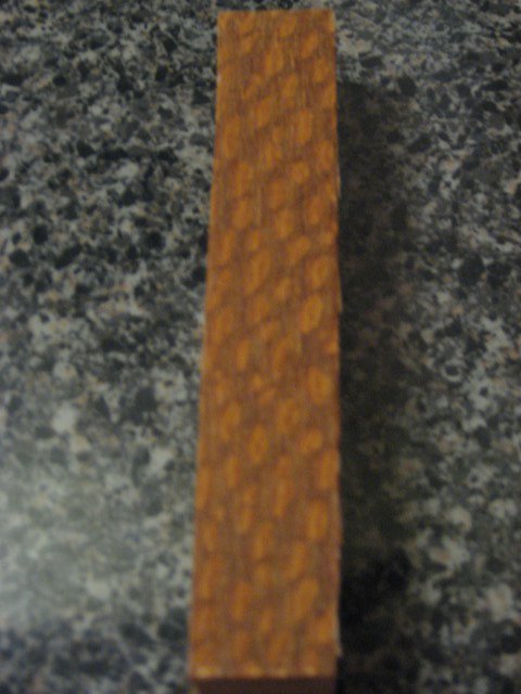

Hey All,
I wanted to show off these Leopardwood pen blanks that came today.
Is there anything that I should know about Leopardwood? It cant be as hard to turn as the celluliod blank. Ya'll probably think "why he's so excited over Leopardwood"? I aint never seen nothing like it, never even heard of it. I'm going to take em to work tomorrow I know they aint never seen nothing like it.
BTW I got these on EBAY for a buck a piece.

Brian, they are called leopard wood, but they are actually South American Lacewood. They are a type of Sycamore tree very similar to the Australian Silky Oak, it turns nice, I put some in a prize box I'm sending off.
I've done 3 or 4 pens out of it, and they have stayed together so far, I was worried that since it sort of looks like snake wood it would act the same way, but not yet.

Thanks Ken,
I had no idea. So no leopards were harmed in making this wood:question:

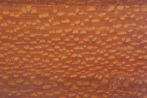

Another wood that looks a lot like the leopardwood or lacewood is fishtail oak.
I have pieces of all three and they look very close to being the same....they may be....I'm not sure. Some of our wood experts may be able to help out.
I've turned all three and had no problem with any of them. I look forward to seeing what you create.

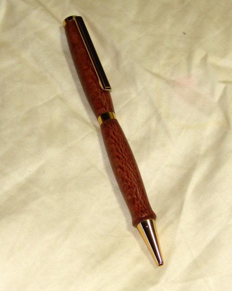

I turned 3 Leopard Wood pens in the last 6 months and sold 2 of them. My customers (the few that they are) liked them. I did have a problem with splinters if I tried to take too big of a cut.
Here is a picture of one of mine. I think it looks fine. Although my picture taking skills are pretty poor.
