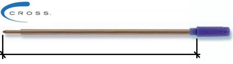

The important dimension for a cross refill would be from the tip to the 'seat' at the end of the threads. The non tip end could be much longer on most pens and not cause an issue so O/A length isn't critical.
This dimension for the pen at my desk with a generic cross refill measures ±99.25mm
As my wording may not be clear ... this is what I meant ... cross_bp_blue.jpg
